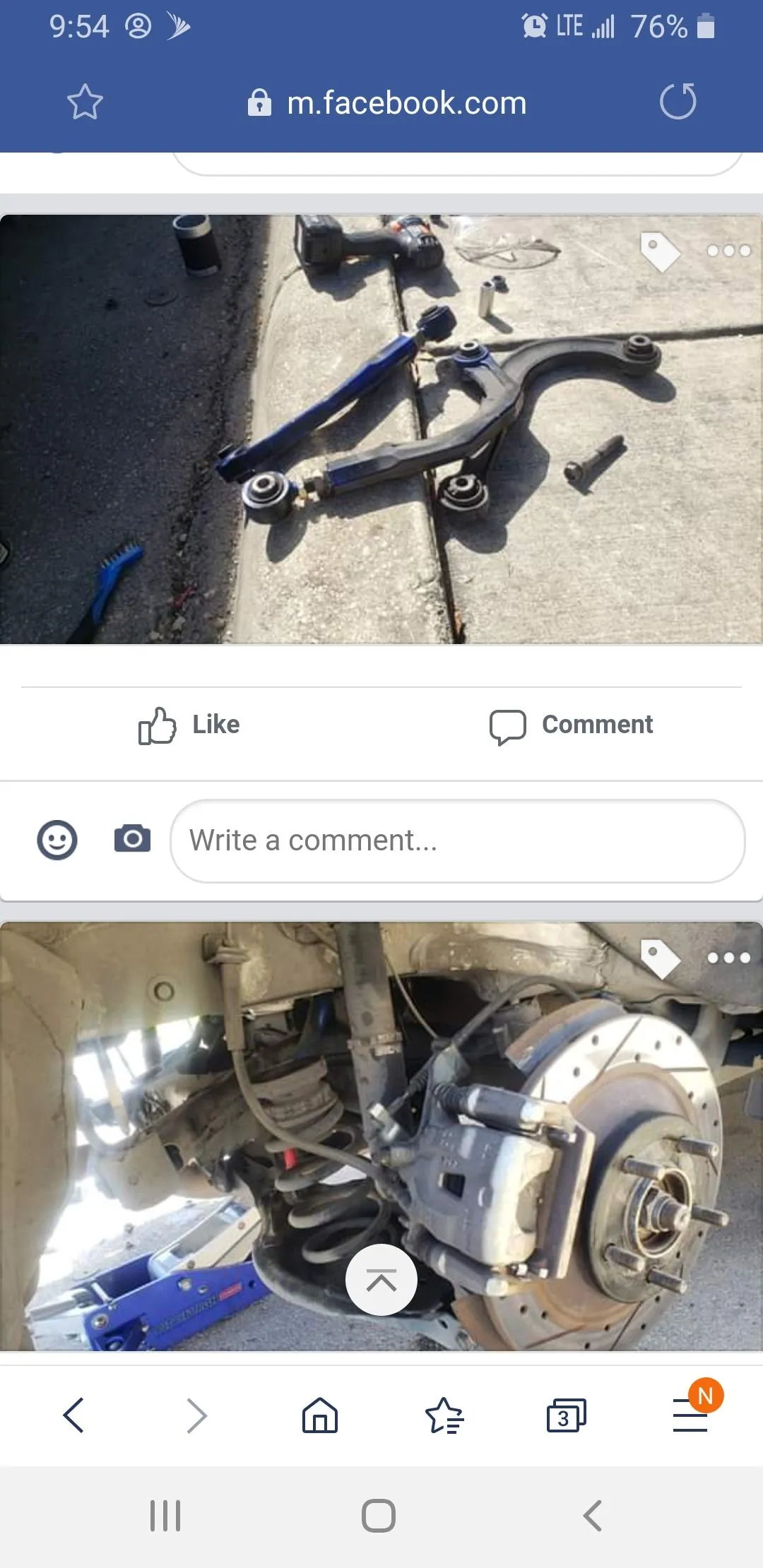

Removed the hardrace camber arm to adjust a lot of the camber out, but I couldn't break the middle jam bolts so I ended up putting the oem arm back on. I run lower profile tires now anyways so I dont need the extra camber.Annoyingly, one of the stud bolts on the lower strut came out with the nut and I could only get it back in half way and its stuck. Gonna have to weld a nut on it to remove it later and put a new bolt in
