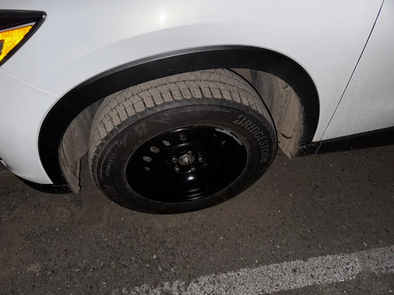

I think so, but that will be taken care of when the new wheels and tires go on.+25mm spacer and you're golden

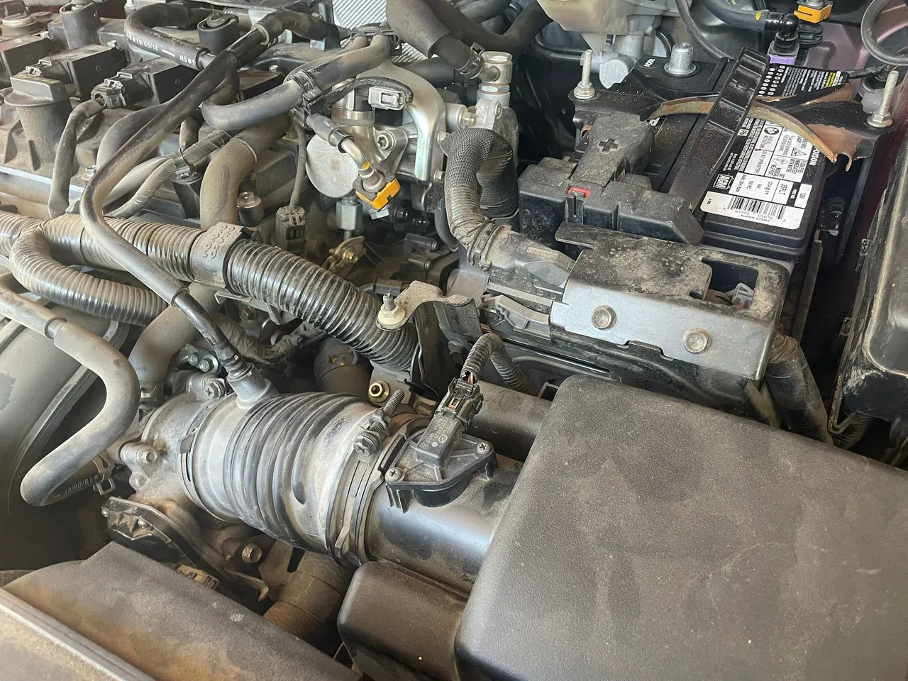

Not what I've done, but on Sunday I was driving home from the twin cities and about 10 minutes short of North Branch and suddenly I felt my car buckle, the RPMs shoot up to about 3000rpm, my ABS / TCS / CEL came on, and I lost all power. I panicked but didn't do anything dumb, drove it to the nearest pull-off about a mile away and got to the gas station parking lot. I got out and visually looked underneath the car to ensure nothing had happened with the wheels/brakes, turned the car off and back on, and everything seemed to return to normal. About 10 minutes later the same issue came back, only this time my audio cut out and the BSM warning came up. I figured I'd better pull off to O'Reilly's and make sure my battery was ok. My BT OBD scanner showed P0882, which could've been a plethora of things but I was hoping just the battery. Well, when we popped my hood open they noticed both of my battery connectors had been loosely attached to the pos/neg terminals. After testing the battery they re-tightened the connectors and all has been fine since. So scary!
Funny I encountered a similar experience recently. I visited a high school old friend in Austin a month ago. He asked me to look at her wife’s 2016 Acura MDX as the car wouldn’t start. The Interstate battery from Costco was about 3+ years old and it couldn’t get charged fully by a battery charger. And he couldn’t get jump-started successfully with the help by a neighbor. I did manage to jump-start the car and suggested to drive straight to a closest WalMart which is still 30+ minutes away (Costco is even farther away and the warranty left covers not much; of course I hate to lift the heavy battery during the battery replacement at Costco’s parking lot ) to get a new battery based on the age of the battery. The young tech at the WarMart found the loose terminals on both battery posts just like yours, and suggested to charge the battery first because a new battery may not be needed. But it’d take at least another 30 minutes and we just decided to get a new battery without wasting time to check.⋯ Well, when we popped my hood open they noticed both of my battery connectors had been loosely attached to the pos/neg terminals. After testing the battery they re-tightened the connectors and all has been fine since. So scary!
That's a great question. All of my most recent maintenance... swapping to 3-season rubber, new control arms, CV axles, wheel bearings... none of that should require pulling the battery. I'm going to chalk it up to them working themselves loose over our pothole-covered roads... I doubt anyone would take responsibility.Who was the last person to do any work on your car concerning the battery?
