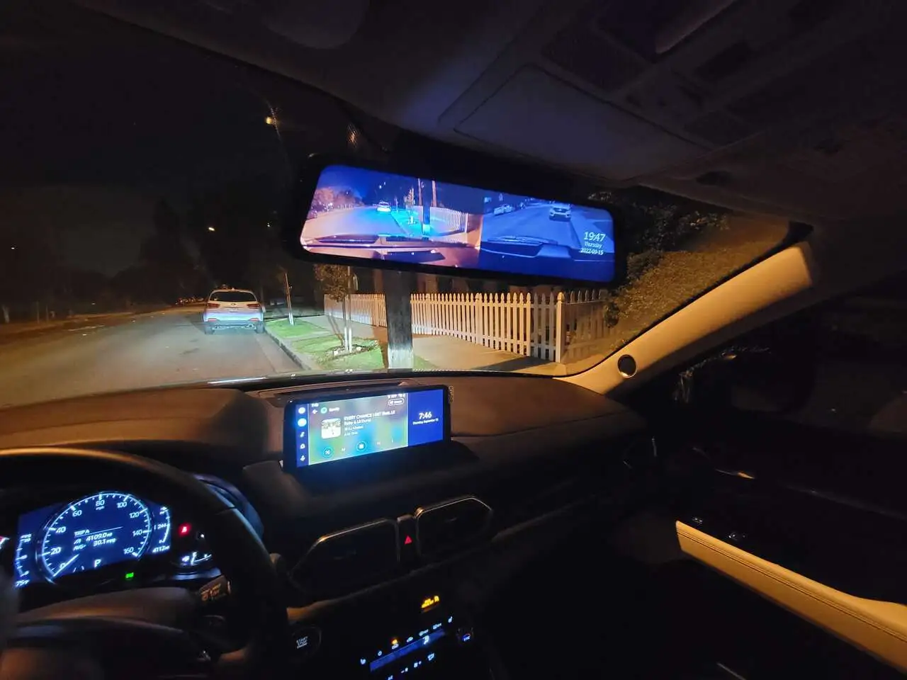

Installed the mirror dash cam last night, took an hour to do so, that dongar rear view mirror power adapter made things way easier and streamlined for powering the cam.
Still have to do the exhaust tips and change out the lugs but I'm good for a while.

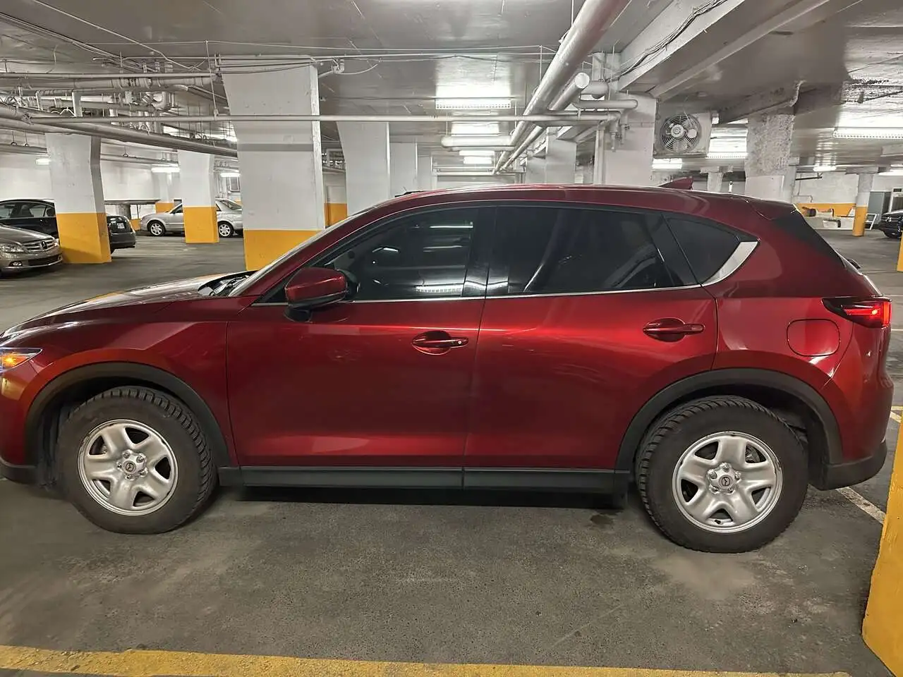

Got the car back from the dealership for the bumper replacement (and the transmission situation) I was given a Hyundai Kona as a rental car which made me realize how great the CX-5 is.
They found that the transmission issue came from a mount (I don't know which mount). So far everything is good. The replacement bumper looks good to me, although it's missing a bracket that they ordered and should be ready in November.
Also I put my winter tires on. I won't be here until October 30th and when I come back all the tire shops are going to be busy, I wanted to get it done sooner than later. Also the weather often drops below 7C.
With the stock Toyo summer tires, I feel like the car is moving sideways (I don't know how to explain it) when I am going over potholes/imperfections. I definitely don't feel it with the winter tires. I know the Toyos are on the softer side (among summer tires) but I don't think it's normal. I might swap them with another set next summer.
