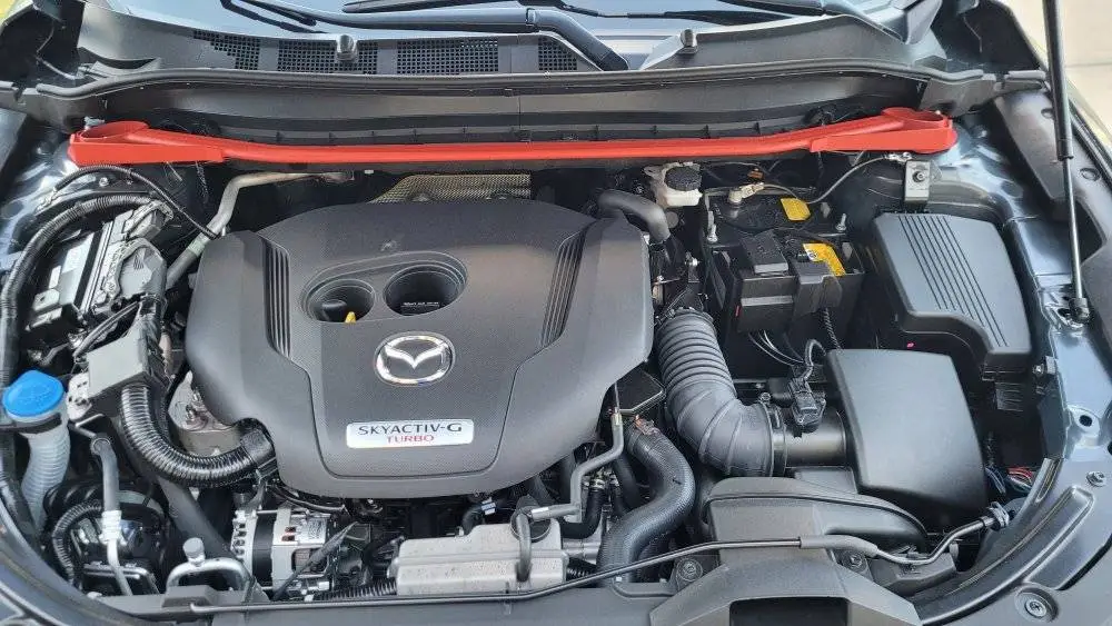

Installed the strut bar, took ~25 minutes taking my time. I didnt have a torque wrench so just tightened best I could. Nothing is really obstructed by the bar.
I wasnt expecting a huge difference after install, but I felt immediate improvement in the tightness of the handling and steering. Totally worth it! I also noticed that the strut bar I bought looks identical to the Tsuyoi brand which is $300.
looks pretty good. Were you able to reuse the factory strut nuts, or did it come with replacements?
Hopefully the washers reduce the risk, but those seem like important nuts to torque properly.
