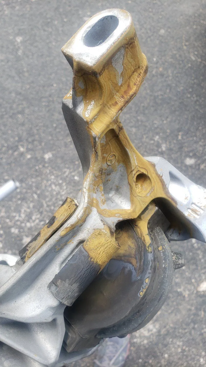

Come to find out Gen1's have a hydraulic engine mount because mine is leaking. Rip. I'm hoping a "cheap" aftermarket one is actually solid.
Interesting. Curious how the aftermarket one will be. I feel like the stock engine mounts are pretty good: not a lot of vibrations or movement from the engine.
I ordered a new one aftermarket for $50. I'm hoping they "cheaped out" and made it solid rubber. Either way, I'm likely going to cut a clean the old one and fill it with poly.

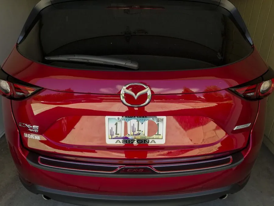

Installed a bumper guard and replaced the sad, sad, stock spare with a 165/90R17.
Bumper guard looks great.

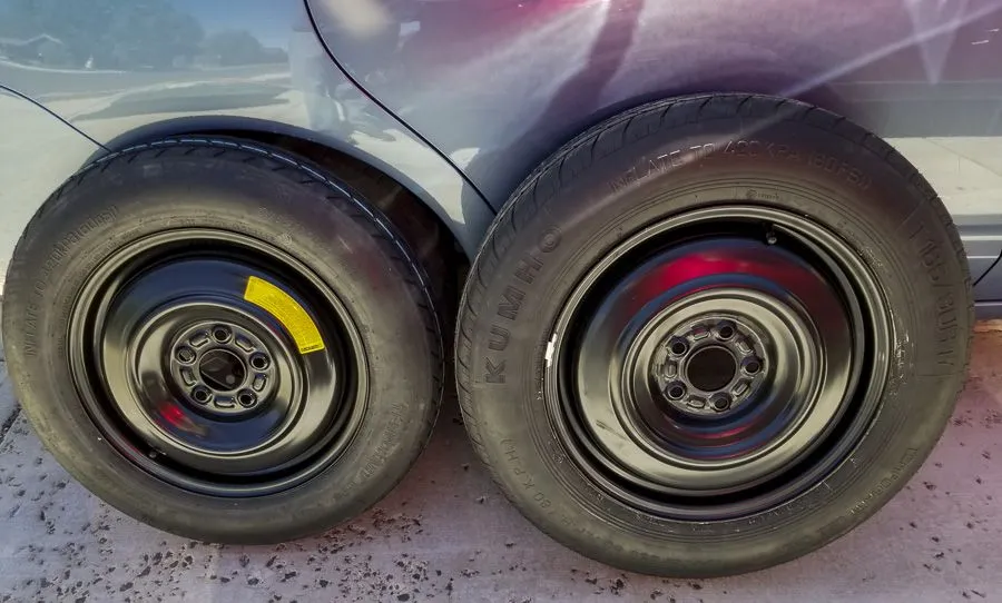

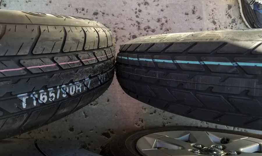

Went back out today to install some of the cut-off foam from the deck cover around the subwoofer and under the too-long bolt until I get the bolt cut shorter. I snapped a pic of the installed tire this time. It would be nice to be able to get the 185/70R17 regular driving tire that's available in Mexico for the CX-5. There is definitely room for it.

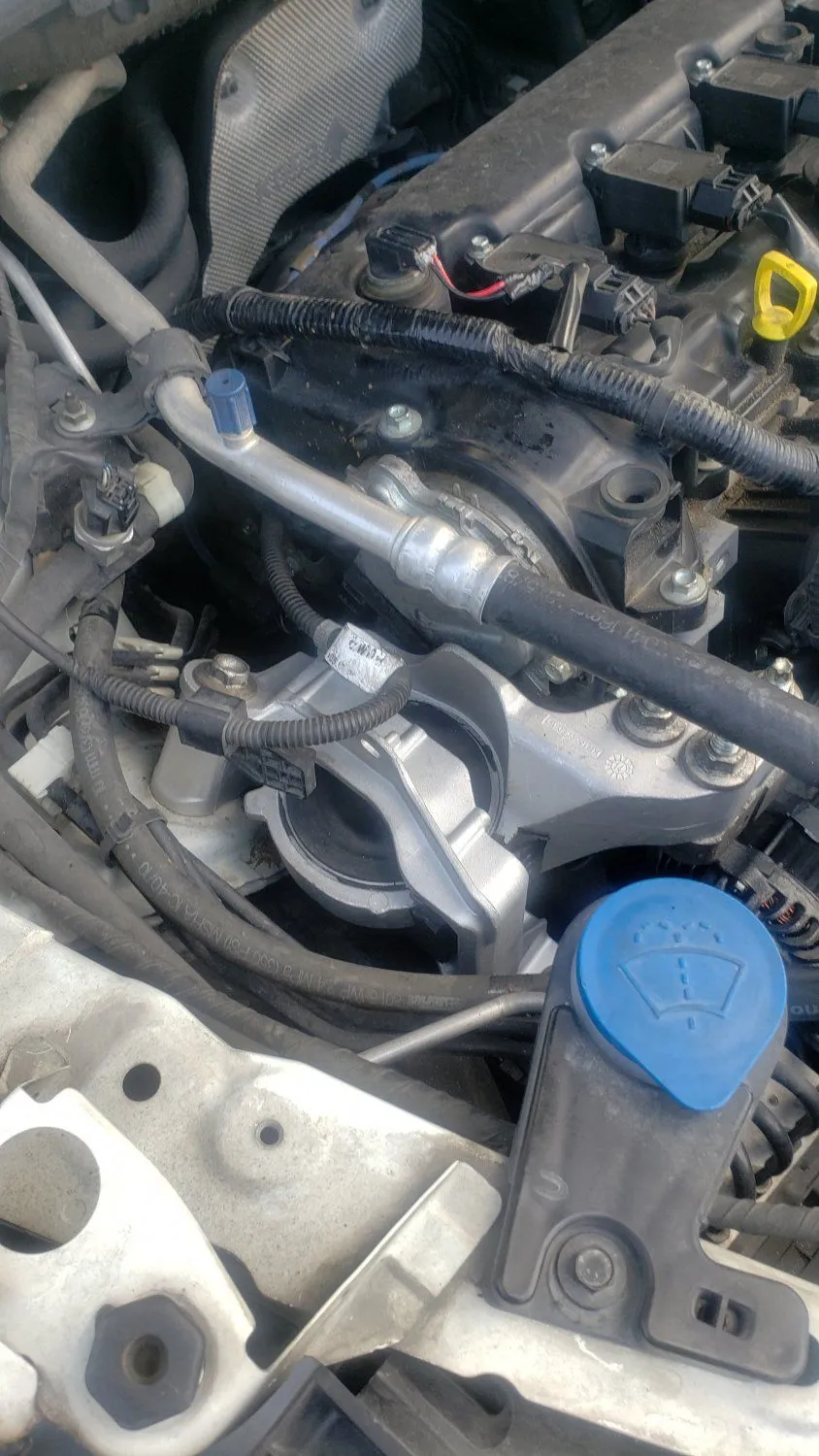

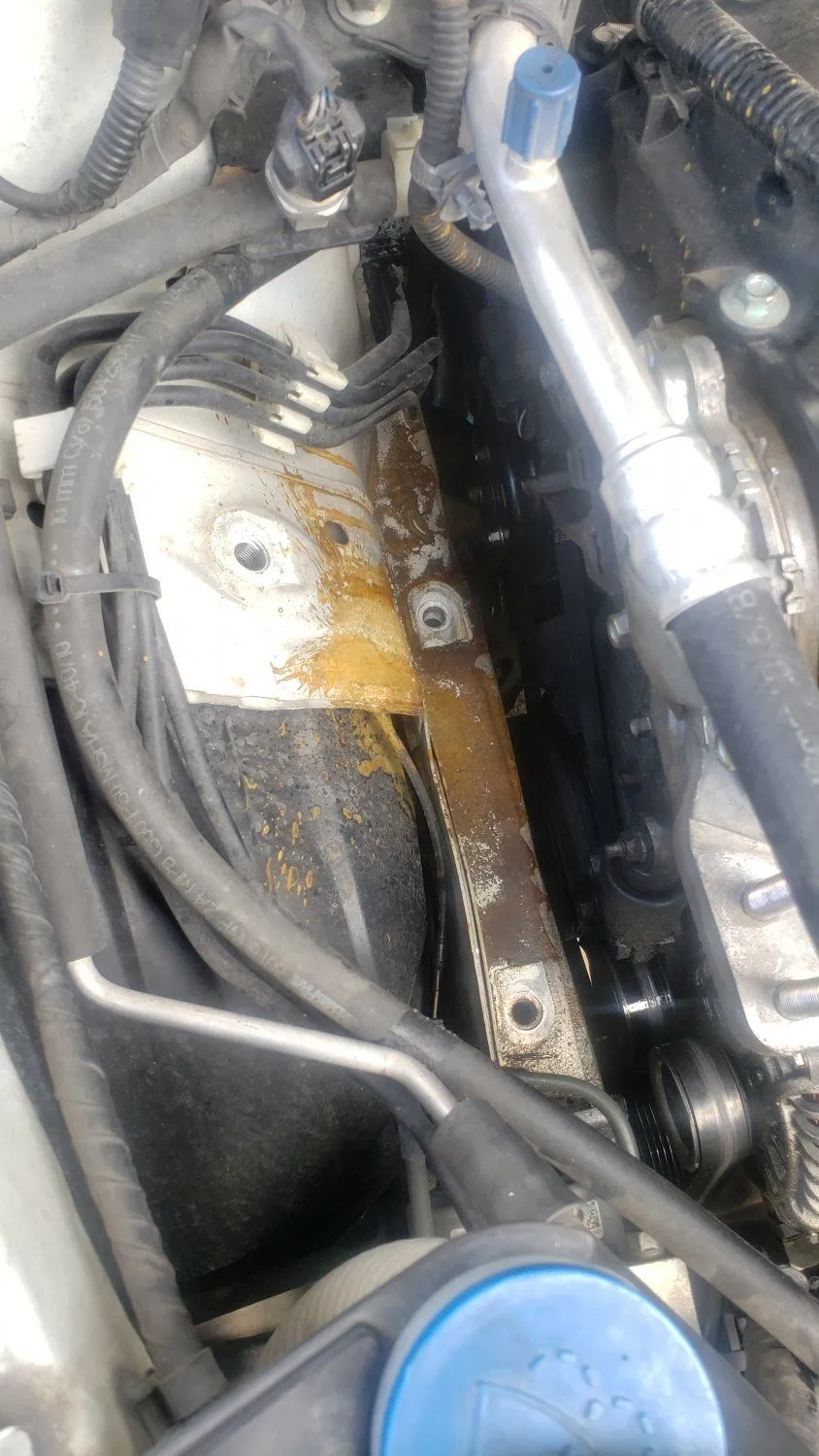

Replaced the old engine mount which tore and leaked (184000mile). $50 new from ebay and less than 1 hr said and done. Going to try and fill and cage the old one with urethane.
You can do it within 1 hour for such job? Nice!
3 nuts and 3 bolts , 17mm in size. Dealer would probably charge $400 said and done. And likely convince customer to replace something else that is "worn out".
I changed leaking rear liquid engine mount on my VW before. The engine needs to be lifted a bit, and the space is very tight. It took me entire afternoon, and I was 20 years younger!
On the other hand, the front rubber engine mount on my 1998 Honda CR-V was so much easier to replace it.
Yea the rear motor mount is a tight fit, esp with AWD. When I put my poly on I had to jack the engine engine so much. It probably would have made more sense to undo the other mountts given the difficulty
