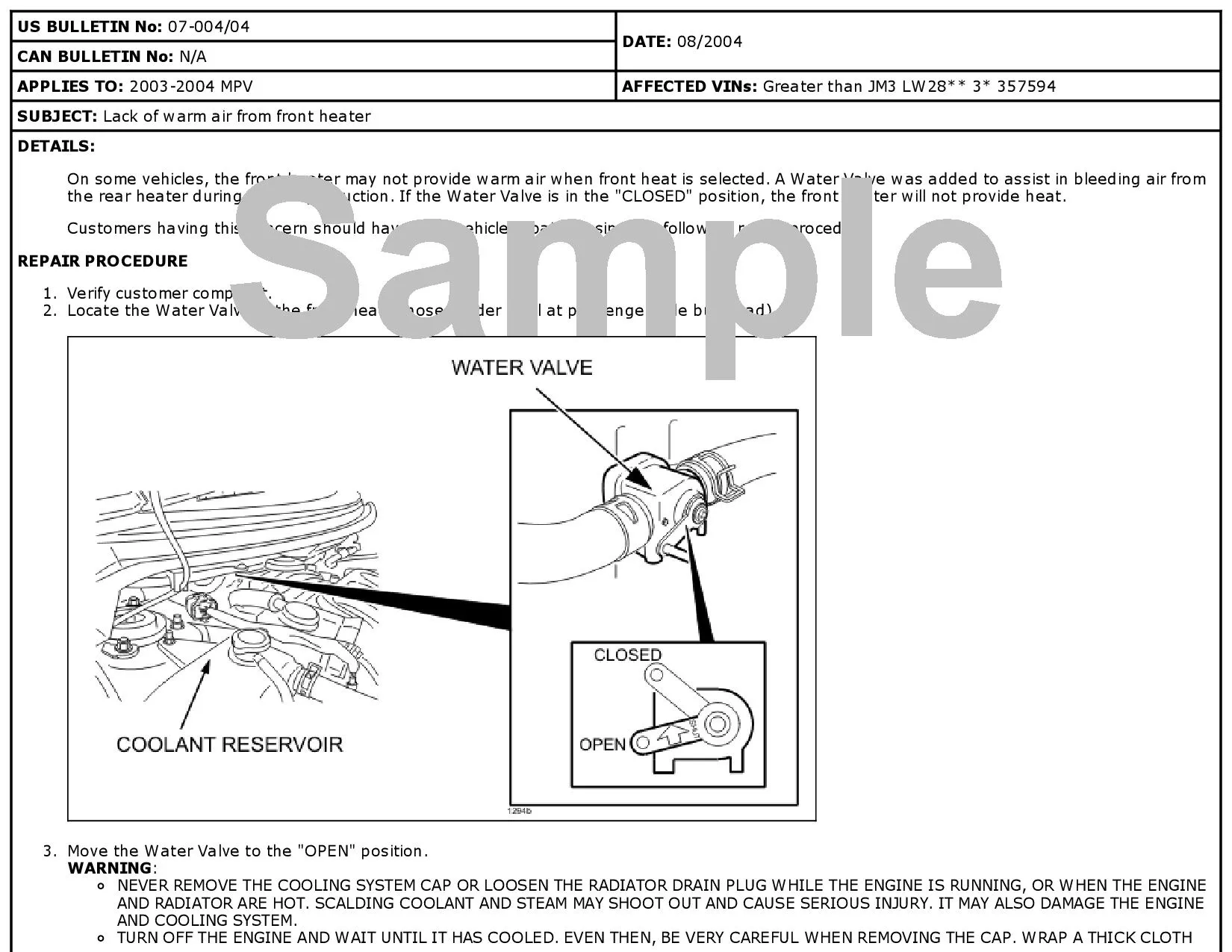

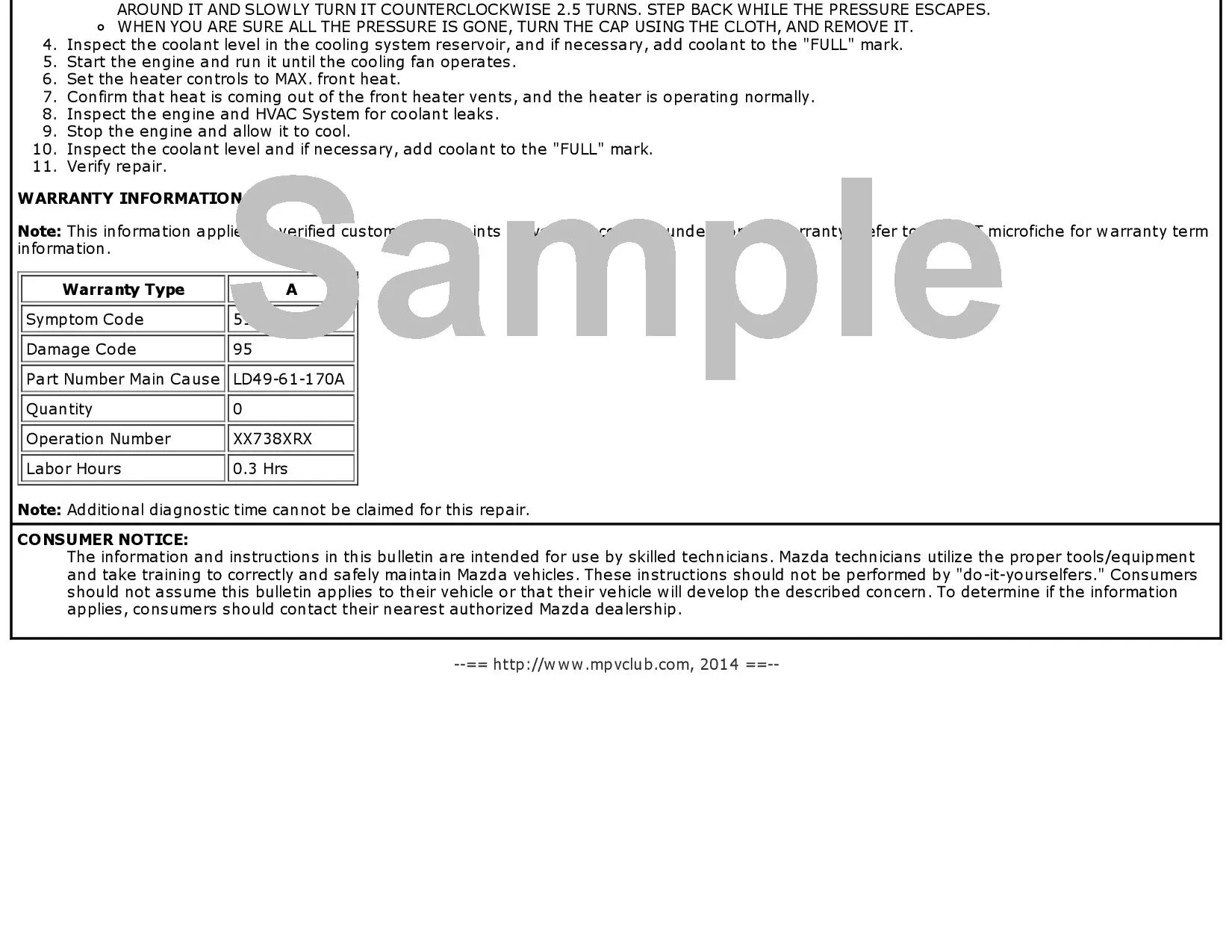

Mazda MPV Technical Service Bulletin-0.jpgMazda MPV Technical Service Bulletin-1.jpgive been told of a water valve somewhere on the passenger side i have a diagram of 2002 but i do not think its the same
