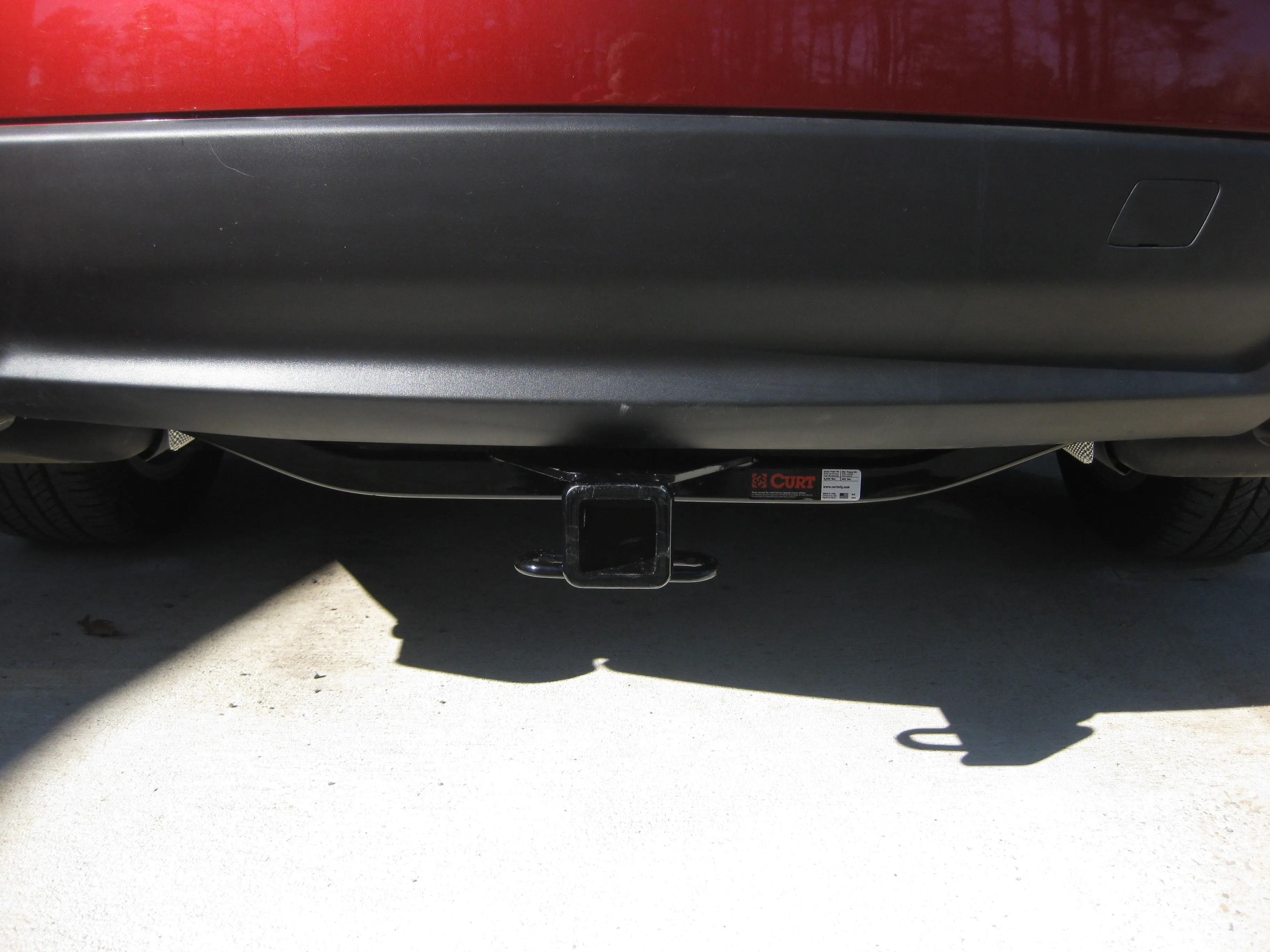

2012 cx9
installed new curt hitch today, took about 30 min...good to have an extra set of hands,,looks good. took longer to tighten bolts than to put hitch in

I installed this hitch the other day and it didn't go as smoothly as expected. My CX-9 has 70,000 Northeast miles on it. The holes in the frame turned out to be very rusted. The whole process took an extra hour to track down and set up a drill with a wire brush to clean out the holes. After that it went pretty smoothly. If you're installing the hitch on a newer car this wouldn't be a problem.
Also, the rust problem wasn't discovered until the hitch was in place. So I got to line it up two times. Here's what I learned. It is much easier if you lead the hitch up at an almost 90 degree angle with the arms facing up and the hitch receiver facing towards the ground. Then you can sort of snake the the arms up to where they attach to the frame with limited interference from the muffler heat shields and rear bumper.
