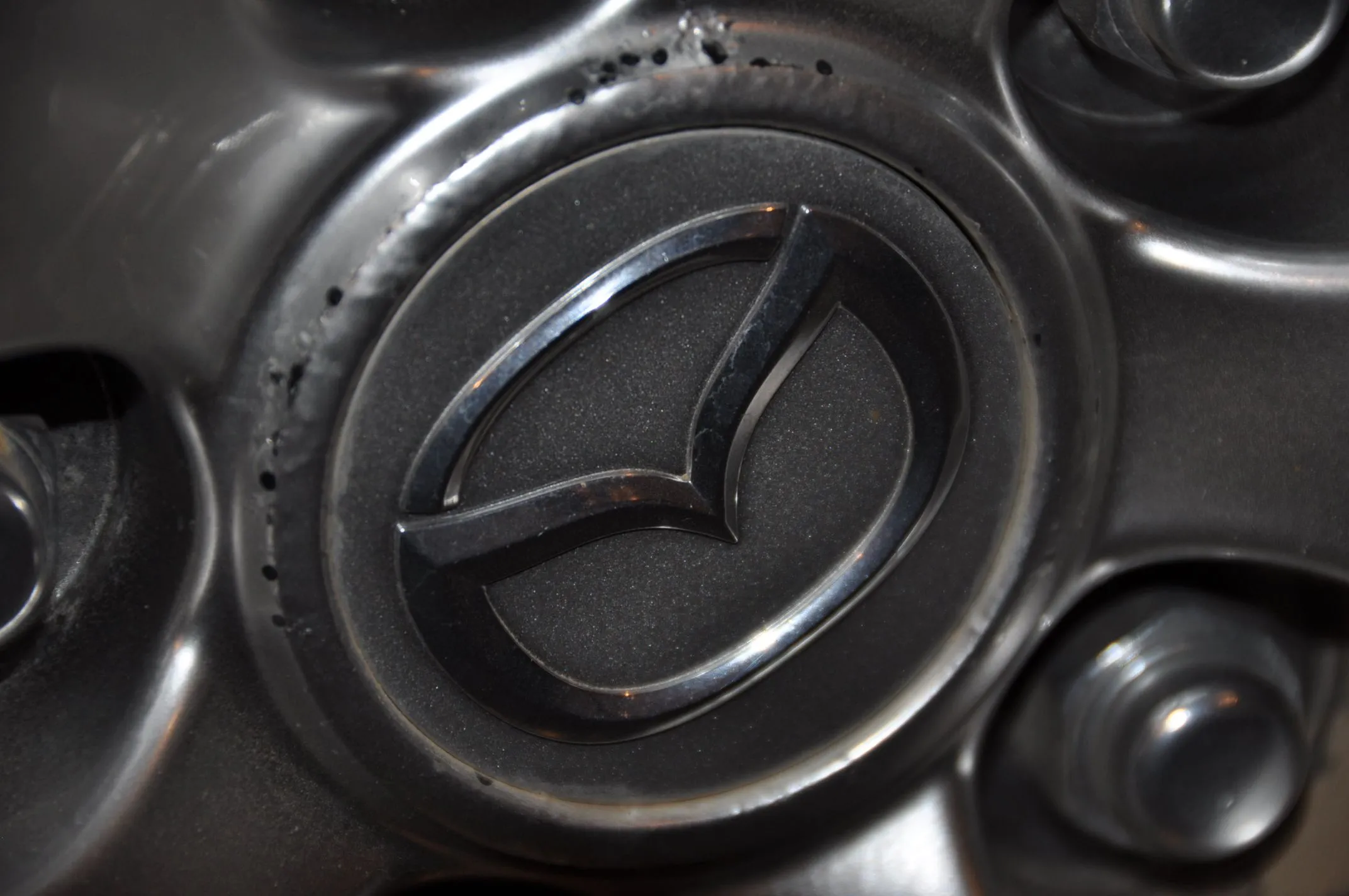

I am dealing with the Dealer right now with the same issue. I have not gotten a "YES" or "NO " just yet. My 2009 GT is still under warranty. SCOTT2008 let us know the outcome of your claim. Here is a picture of one of my rims.

radar, that looks like a straight up BAD paint job, I've seen remanufactured wheels that look exactly like that, but never a new oem wheel. That's crazy!
