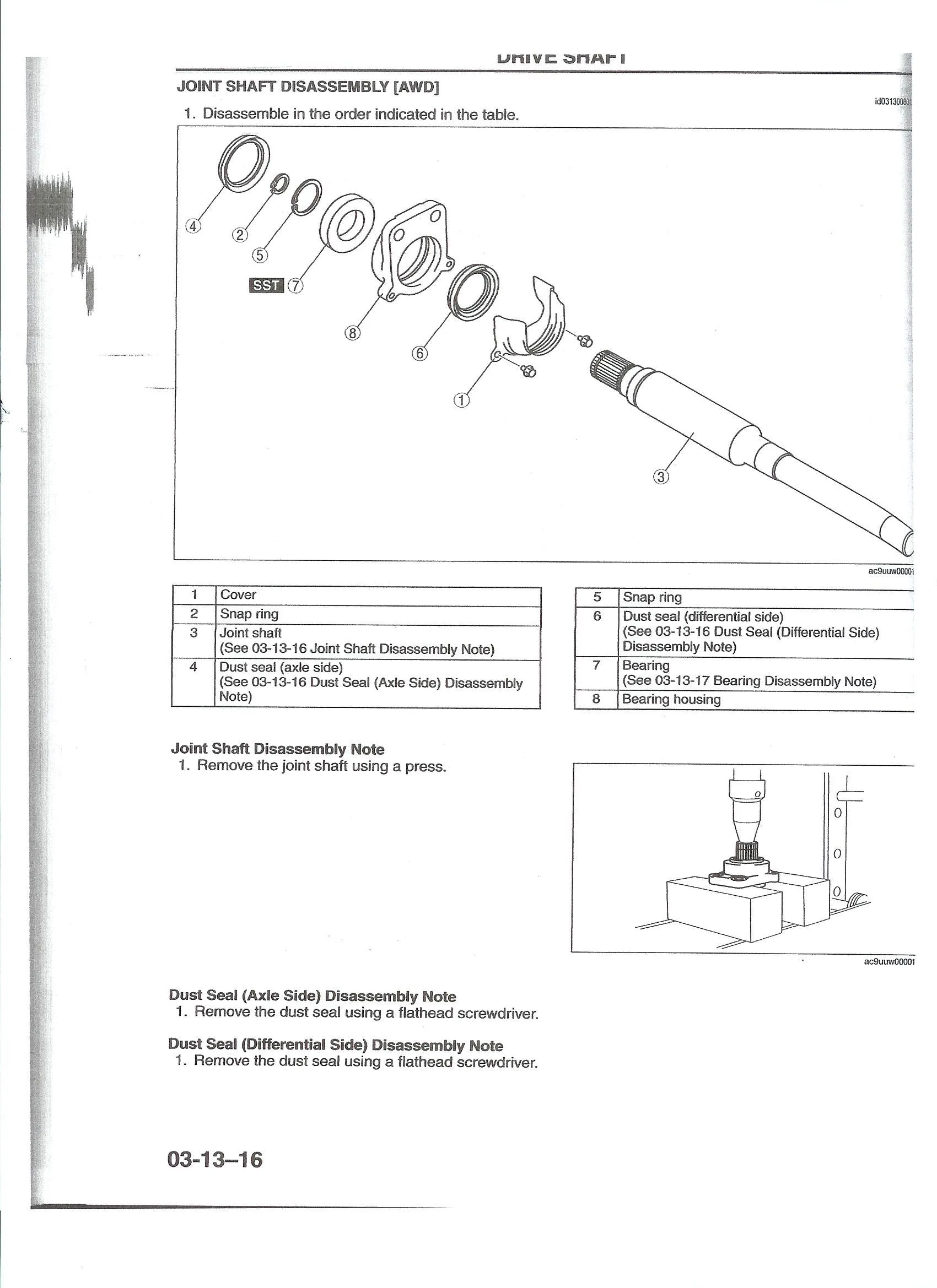

Anyway, to make a long story short, the bearing on the joint shaft was gone. See attached sketch for more details. The dealer allowed me to look at the housing while the CX-9 was on the hoist. I couldn't believe my eyes. There was nothing between the bearing housing and joint shaft, but air! The bearing was gone.
