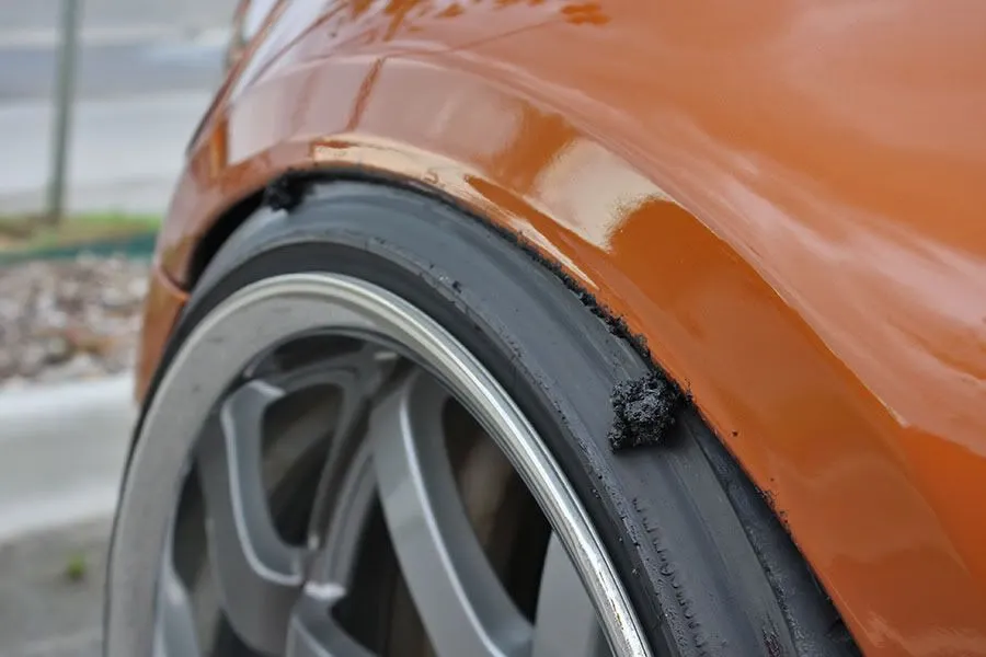

Haha Heres some fire to the convo (ricer)
