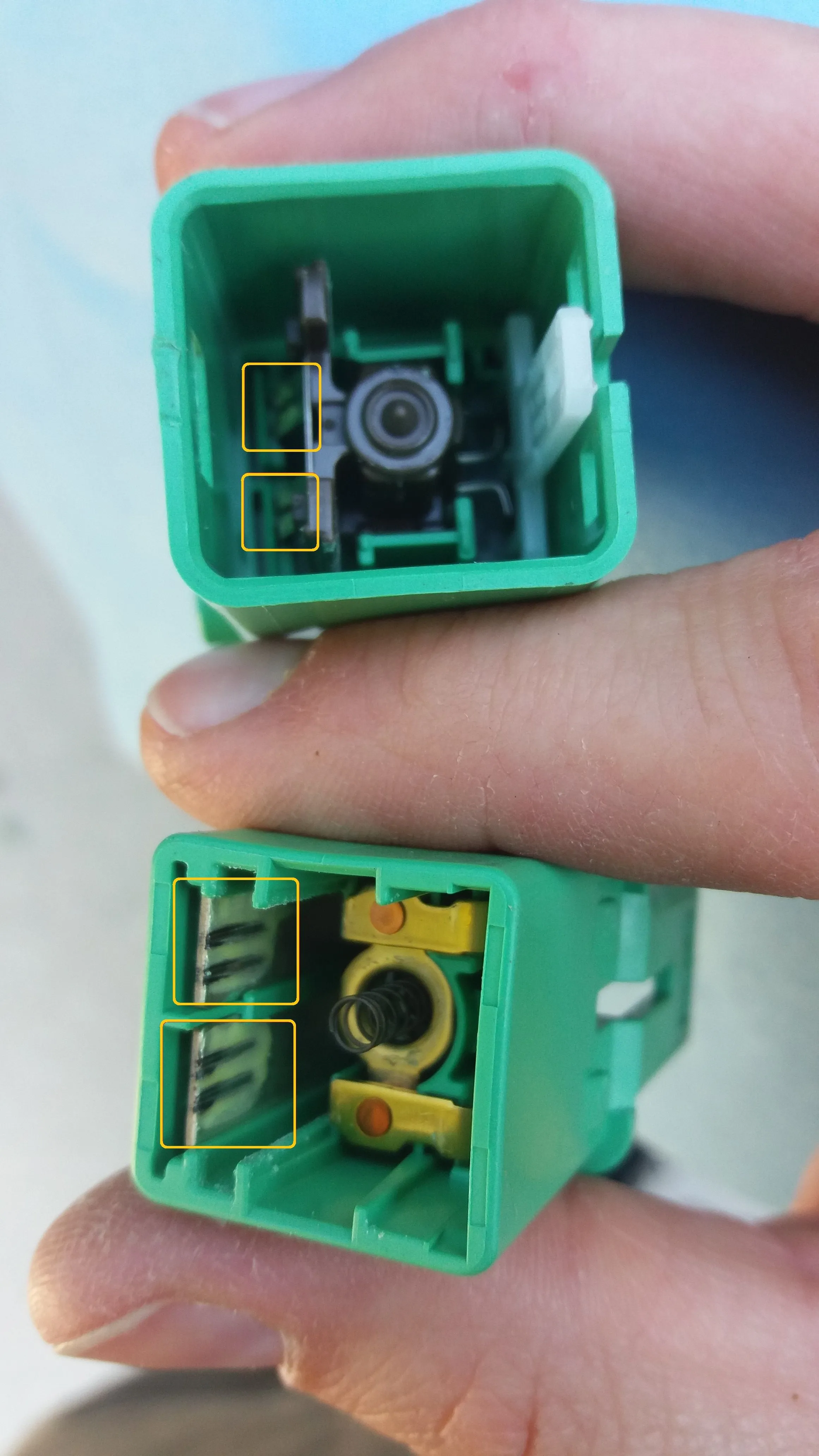

Here are some pics of the part. First, the green switch located above the brake:
attachment.php
The the switch itself opened. I highlighted what looked like the contact areas:
attachment.php
Lastly, I experienced the same thing as Aron in Toronto with regards to the plastic rod that protrudes from the unit. If you push on it or pull on it with any amount of force, it will lengthen or shorten. Well, suffice it to say that I inadvertently adjusted it when removing and prying apart the switch. After I first reinstalled the switch, the brake lights didn't work at all. Then I took it out, shortened the rod, tried again, and viola! bright brake lights!

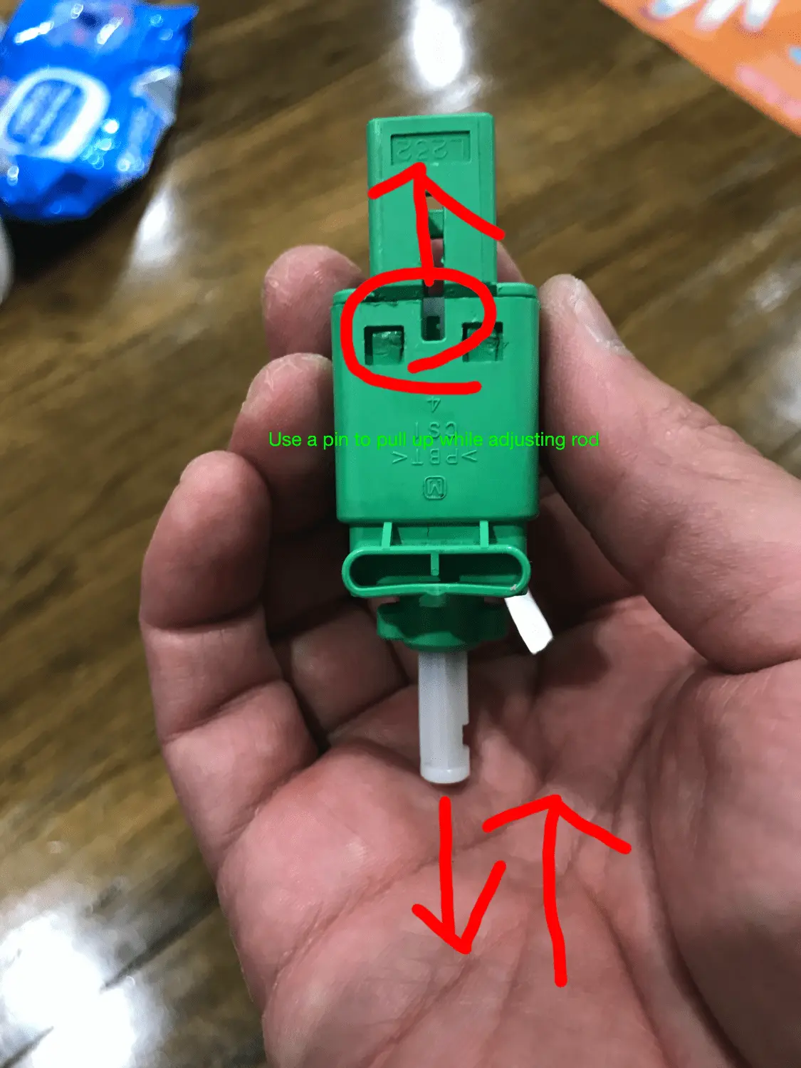

This was very helpful. I was having the same issue in my CX9. My fix was some what simple. After having trouble trying to get the green piece apart I remembered what you guys were saying about the white plunger. So I pushed it in two clicks and now the lights are all bright! So maybe theres no real need to do a disassembly of that part. Only need to make an adjustment.

I just signed up to say thanks and add little information with regard to the white rod mentioned above. The green piece was a bit hard to disassemble as you need to pry up both sides at the same time. Also, the click-push type holder is quite fragile. I cleaned inside with contact cleaner spray. Mine had some build-up inside. After assembly, brake light remained on regardless of the brake pedal, then I remembered the white thing. Mine was too short to reach the pedal so it remained on. I needed to extend it but the white rod did not extend even though I applied quite substantial force. It could be only me but I had to pull up the white lever (not the white rod) with a pin near the connecter while shortening or extending the rod. Please see the photo. I hope this helps someone in the future.

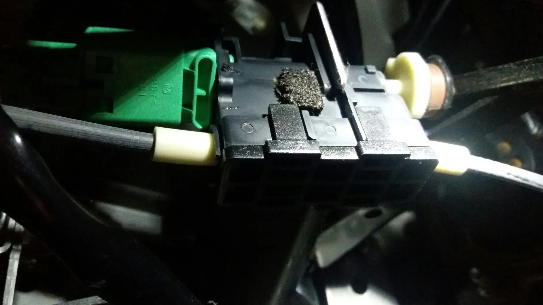

My 2010 CX-9 failed inspection because 3rd brake light not working. As I did troubleshooting, I thought the regular tail lights looked dim as well when braking (not nearly as bright as they should be if lights were already on). Found this post when googling symptoms, then rechecked 3rd brake light in the dark and saw that it was barely illuminated, so not a broken light, but rather an electrical voltage issue and this thread pointed me to the right location.
Based on other comments, I removed my switch and opened up to clean contacts. Switch is definitely tricky to open up as mentioned in previous post because you have to pry from both ends at same time to release clips. I ended up just breaking open the clip retainer on one side to make it easier. I originally only cleaned the stationary contacts because I hadn't read through all the posts and I was rushed to fix. Reinstalled and lights were improved, but still not working right.
After looking at excellent photos provided by Mako925, I took apart again and used precision screw driver to scrape residue on the moving contacts on the plunger side along with WD40. I also pried them out a bit so they would make a stronger contact point when engaged with the stationary contacts. Put back together and everything worked perfectly.
I would like to add that after inspecting the switch, that the white plunger is not actually "adjustable". It is made to be either fully extended (if the spring is not fatigued and can still extend it all the way) or fully inserted (by the brake pedal) to the stops where it comes into contact with the stationary contacts. However, when you take it apart and move the plunger around to clean the moving contacts, you could risk it not being reseated properly before putting the switch back together. The white plastic tab on the side is a guide that helps control the travel of the plunger via a small metal clip and those pieces can get misaligned while cleaning.
The bottom line is that these pieces need to be placed back in precise position before popping the switch back together. I suspect that the posters who had issues probably pulled on the plunger until it got back into position to get it working again. Because of their posts, I noted that my plunger wasn't fully extended before I snapped it back together and then I saw it was because the movable contacts were striking the plastic that you can see in Mako925's photo. I used my precision screw driver to "tuck" these contacts in behind the plastic guide and push it down all the way (and fully extending the plunger).
