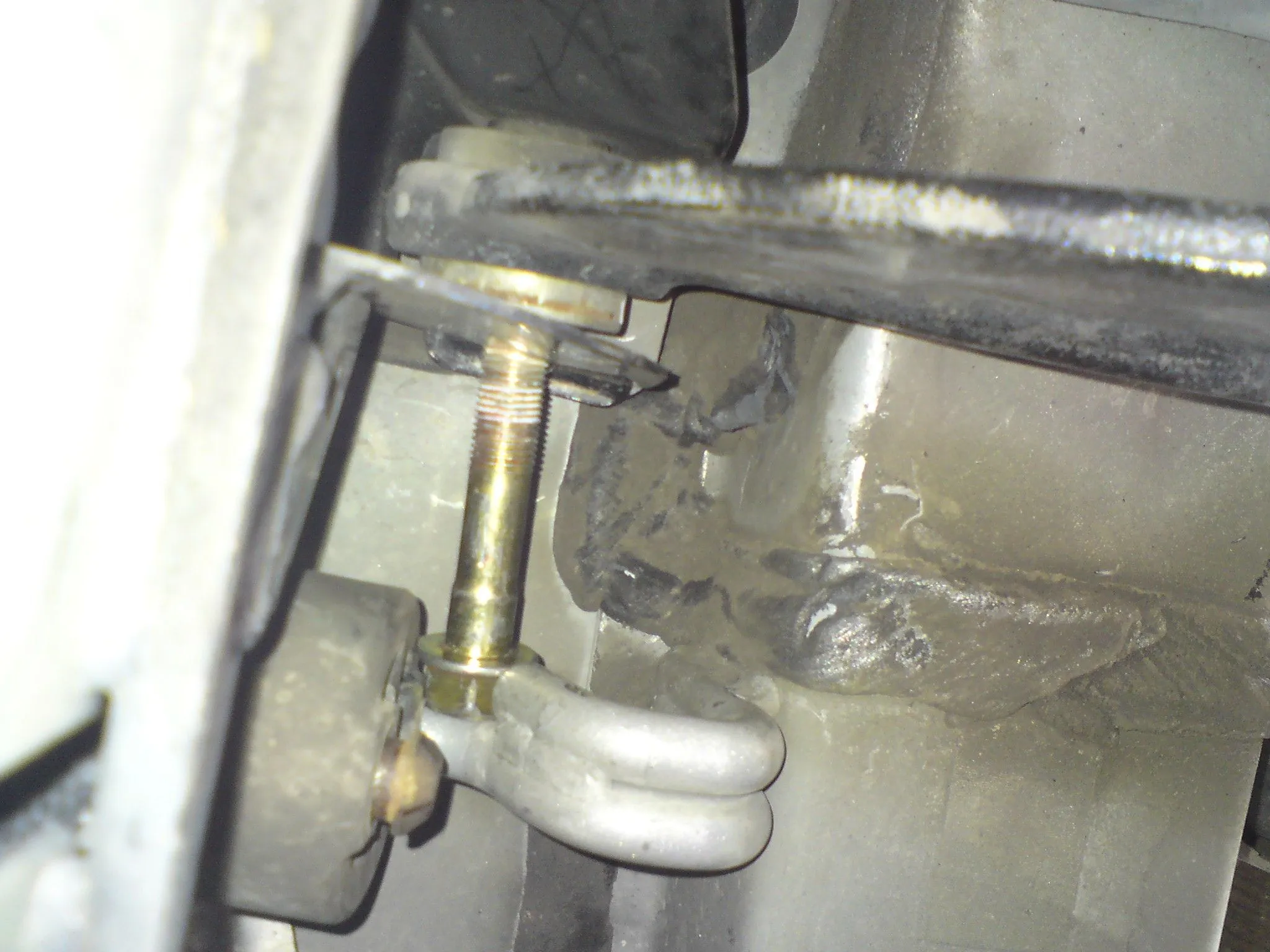

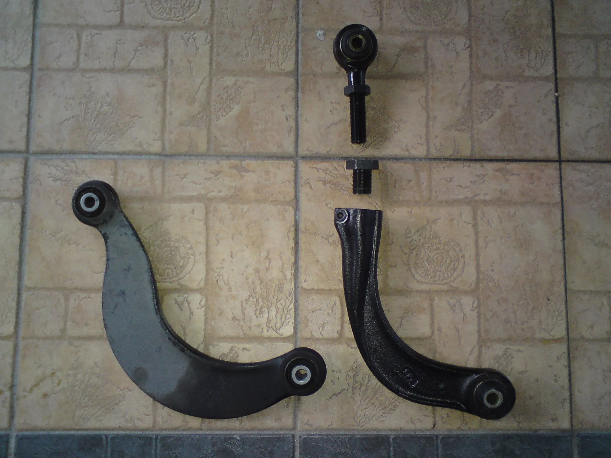

Hi all, I am new here. I just bought the SPC rear upper camber arm. Firstly I bought Celica arm after being told they are the same, but they are not! I have to grind off the bushing to fit M5. Secondly, I just can't remove the upper bolt from the left side arm since there is exhaust hook blocking the bolt. Any tips on how to remove the bolt?
I cannot help you with the wrong part, but I can tell you that the exhaust hanger is a son of a female pooch to get out.
Passenger side RCA took me about 20 minutes.
Drivers side RCA took me about 1.5 hours with most of that time fighting the exhaust, exhaust hangers, and minimal clearance...(stoned)
OK, finally managed to remove the dang! bolt of the left side upper arm after bending the exhaust hook down with a lot of force. Yeah, the right side was easy, but the left side took me many hours. I also shorten the bolt by grinding off half inch so it will be easier next time.
Agree too that the SPC camber arm design is a pain to adjust. I have to remove the shock absorber lower bolt and push the absorber out of the way to adjust the size 34 camber nut.
Anyway, I am happy now that it is done. (yippy)

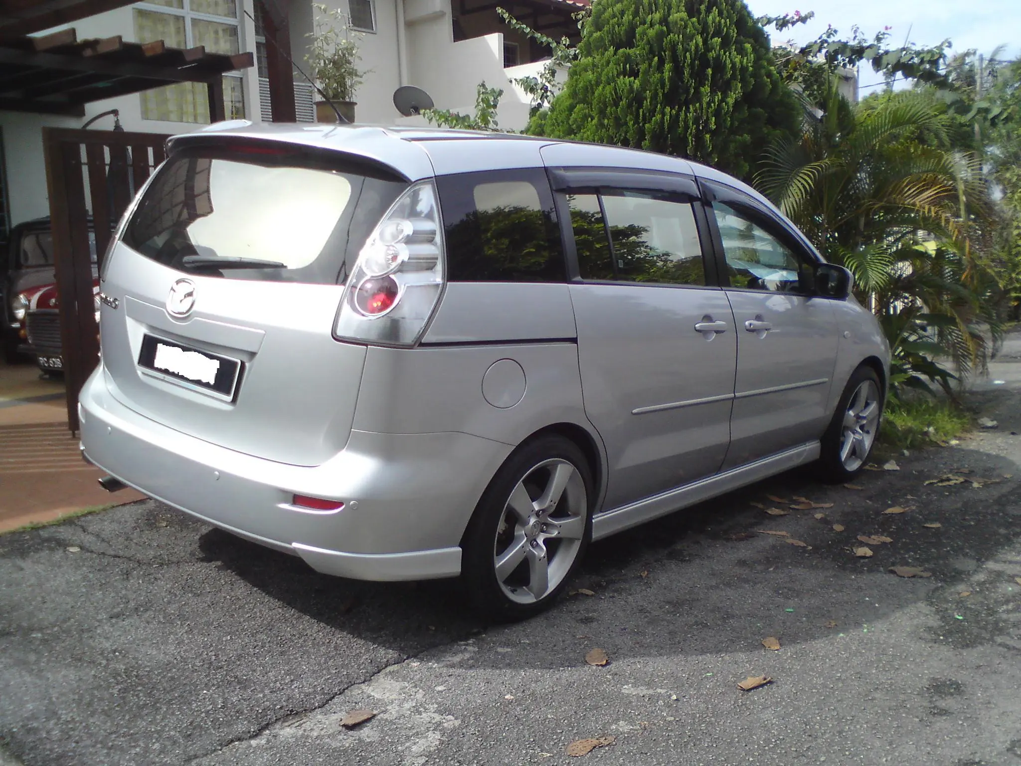

You are running RX8's with 225/45R18 tires? Can you post pictures? I currently have 225/40R18 and do not like the rim poking outside the tire. Any curb means the wheels are toasted.
I will be curious if you have a rubbing issue in the rear. I did and had to roll the fenders for more clearance... and my tires are 40 series. I would imagine with your 45's you'll have less clearance that I did.
michael.
I was running a 225/40 set-up with no curb rash at all, with a 2" drop on Rx-8 wheels ... but i had negative camber , that help a lot lol.
Michael, before I install the SPC camber arm, I didn't notice any rubbing with my wheel arc. After the install, I haven' tried to carry full load, so not sure if it will rub. Below is the picture of my car. Also attached are the SPC arm pic and the !@%# exhaust hook.
VenomDesign, that is bad looking M5. I will sure have a lot of problem with speed bump with that kind of height. ;)

Once you lower it (with H&R springs), then you might have rubbing issues, but at stock height, you should be find.
