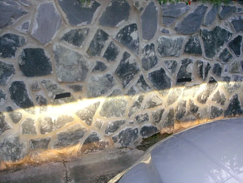

SOLUTION first i had to wait till it was dark enough to see my headlights but bright enough to see under the hood. i wish i had a garage. need car parked in front of wall 4-6 ft away the more distance you can get the more accurate it will be.

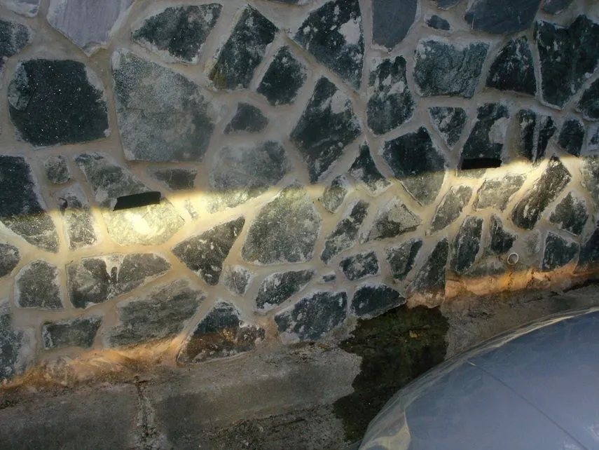

second with lights on and the roller level set to 0 i marked the top of where the light was on the wall with some tape.

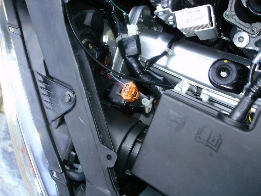

third turn the roller to the 1 setting. you want to turn the white plastic screw at the back of each light counter-clockwise until you bring the light level back to the tape mark on the wall. its that white screw behind the orange connector its a pillips head #2

does this wwork with all the headlights? I have the non hid lights but put an hid kit inside. The pictures are out of order, made it look like you lowered the beams from the tape line.

i cant find that scre to regulate them in the left head lamp where the hell it is??
it literally is in the same spot as the right light, but on the opposite side. i know that sounds silly, but it's true. it's white, and there is a white gear attached to it. it might be obstructed a bit, but just keep in mind where it is on the other side and look in that same spot.
When you pull up the little "trap door" that's connected to the battery air intake, it's right underneath there...staring at you...with its beaty little cross eye, watching, waiting to be screwed...o_O
i thought the left one was the eisiest to find mabe it was beacuse of the CAI. there both at the back of there the hid bulb is.
