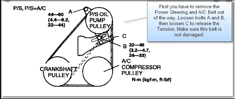

Does anyone know if my car has enough clearance in order to put on a shorter belt and by pass the AC compressor completely without having to remove it?
Compressor locked up and I just want to get through the next 5 months without AC so I can save for a new Car.
I have a 2000 Mazda Protege' DX 1.6 Automatic Transmission. Thanks in advance.
Take some sort of straight edge and line it up across the top of the pulleys and see if it clears.
That'll give you a good idea if you've got clearance.
IMG_3760.jpgGood idea but I think it's bottom of the pulleys that I need to do this to. The top will definitely clear.
But this is a different diagram to a different car. I have a DX with a 1.6
Or is it the same on all of them? Sorry, I just don't know. ;-)
Yea I just found this. I think it will clear. Now all I need is to find someone to do it. The guys around here don't bother with that.
Told me flat out. 3 different mechanics. They won't do it.

Update: There is not enough clearance on my model Protege' to just put a shorter Power Steering belt on.
You must take the clutch, pulley and the Coil completely off to get clearance. Much bigger job.
I finally had it done and belt is on and running fine.
