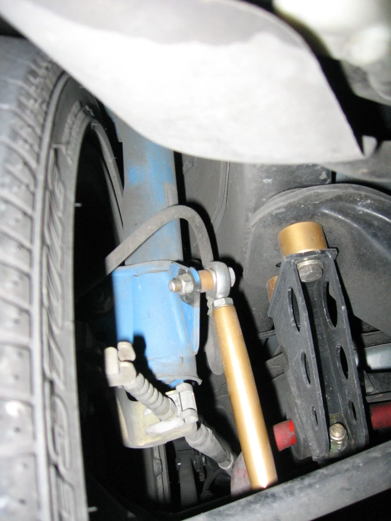

The endlink bolt hole on my drivers side rear strut is broken. What the hell should I do. I'm sick of this suspension crap. I got these godamn clunk fix brackets and they have given me more headaches and anguish than the clunk ever did.
I have to drive to work tomorrow.
Should I just remove the sway bar and endlinks completely, until i can get new struts, or what?
It was making some pretty bad noises on the way home today.
I think I remember reading someone on here was driving without a swaybar for a while and the handling sucked, but it is still not going to hurt anything as long as I drive easily?
What should I do with this broken strut? I guess a full coilover setup would be nice, but I don't have a whole lot of cash, so comething reasonably cheap. I don't know if I want to go back to these brackets again either. Isn't there some aftermarket swaybar setup that did away with the clunk without these crazy brackets?

You might be able to get it welded? But then I would think that it would not be as strong. Other than that, you could get a new strut.
Yeah, I don't think I would trust a weld to held together well enough.

Peeps, you need to change the heim joints (ball joint) on those Delsing endlinks if you want to preserve your strut brace. You need a heim joint with a high misalignment spacer because it looks as if the links are binding with the bolts. Here's a pic of what I'm talking about.
That's cool, I didn't know they made stuff like that. I'm just going back to stock endlinks though, since I've already wasted enough money on my suspension.

If you can't afford to buy new struts right now, I would just weld it as someone else said. I don't see why that wouldn't work as long as you don't damage the sway bar when you're welding (just weld a piece onto the strut so you can attach the sway bar to it). Put a lot of weld on it and it should be strong enough, as long as you don't completely deform the metal from the heat (which could be a problem).
