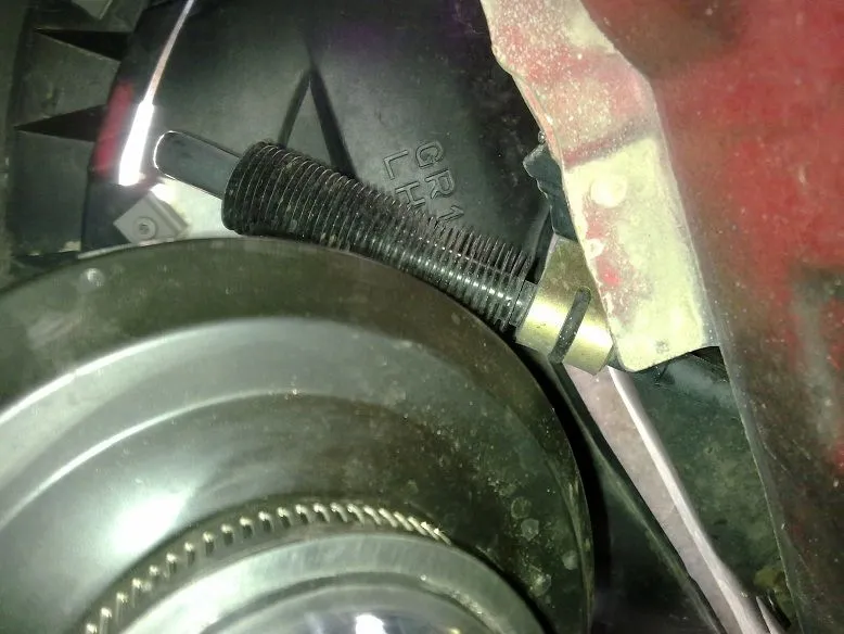

When I was installing fujita air filter i couldnt put it on the botom of the pipe becoase down under is some kind of oil cooler for servo i think (on attached image).
I managed today to put filter 3 inches lower, but it is now very near to the oil cooler.

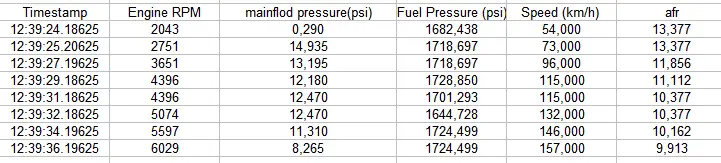

I will also attach some datalog from today in 4th gear but only with low sample per second.
I hit solid 15 psi at 2800rpm (spike 16-17), and then went slowly down, but much better than before.
Air temerature was 50 F, and clear weather.

Just for future reference you shouldn't mash on the gas at 2800 rpm. Thats a good way to bend a rod. In 1st / 2nd you should be okay but definately not a good thing to do in 3rd+.

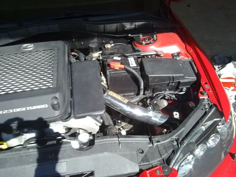

And for my cai I made self some hydroshield (saw on forum similar) from water repellent textile and placed it between tyre and air filter to close air inlets for stock intake (picture). Is this ok, or should I buy injen hydroshield?

In regards to holding boost you won't feel a difference unless your stock bpv is leaking. I did notice better response between aggressive shifts however. The stocker seems kind of lazy when your shifting at WOT. It does have quit a loud "ping" sound. Its a love or hate thing. Before purchasing one I would listen to some youtube clips to make sure it wont drive you crazy. The turbosmart bpv is also a nice piece with a more "stockish" sound.
if you had to move the filter down 3" inches that is quite substantial and i can see why you weren't boosting correctly. with the fujita you need to make sure that pipe does not go past the collar like others have said, since this will hurt the airflow. i've run the fujita before and its not a bad intake just need to make sure its installed correctly.
Then why do they do that on the dyno.. They like punch the crap at around 2,500 plus rpm in 3rd 4th and 5th sometimes
I think the rod bending has more to do with the sudden rush of torque down low.. But Im not sure.
