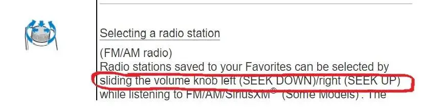

According to the Mazda Connect Owner's Manual, you're supposed to be able to use the seek switches on the steering wheel or slide the commander knob left/right to cycle between radio stations that have been saved as Favorites. I don't have a 2021 so I can't test it myself, but if the manual says you can do it, and in actual practice you can't, then it must be some sort of software bug or oversight (or it is a misprint in the manual). In any event, contact your local dealer to make sure you have the most up to date version of the infotainment software. If it's up to date, contact Mazda Corporate to raise a ticket and complain. Mazda can't fix the problem if they don't know about it, so the more tickets they get, the more likely they are to address the issue.
It appears that the owners manual is either wrong, or the operation is different in Canada

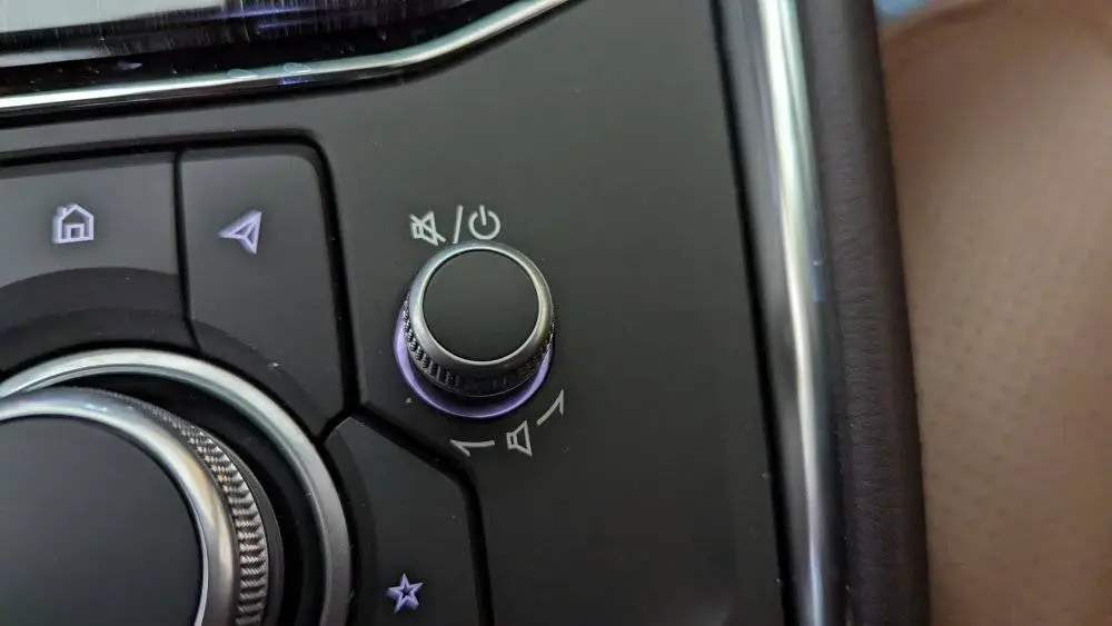

On the above referenced link, ( http://www.mazda.ca/en/digital-owners-manual/2020/mazdaconnect/contents/32020200.html ) it very clearly indicates in both the description and the graphics by the knob ( << or >>) that the volume knob (4) moves side to side. My 2021, (US) doesn't move side to side nor have the same graphics as in the above link,

Yeah this has been brought up before, hence the "supposed to be able" part and the recommendation to contact Mazda. The manual does say (Some Models), so maybe it applies to non CX-5s with the new infotainment. Maybe the Mazda3 and CX-30 only?

That's a fair conclusion. The PDF version of the CX-5 2020 North American manual calls it a volume "dial", not "knob," there is no reference to side-to-side control, and it in fact does not move side-to-side in my vehicle.
