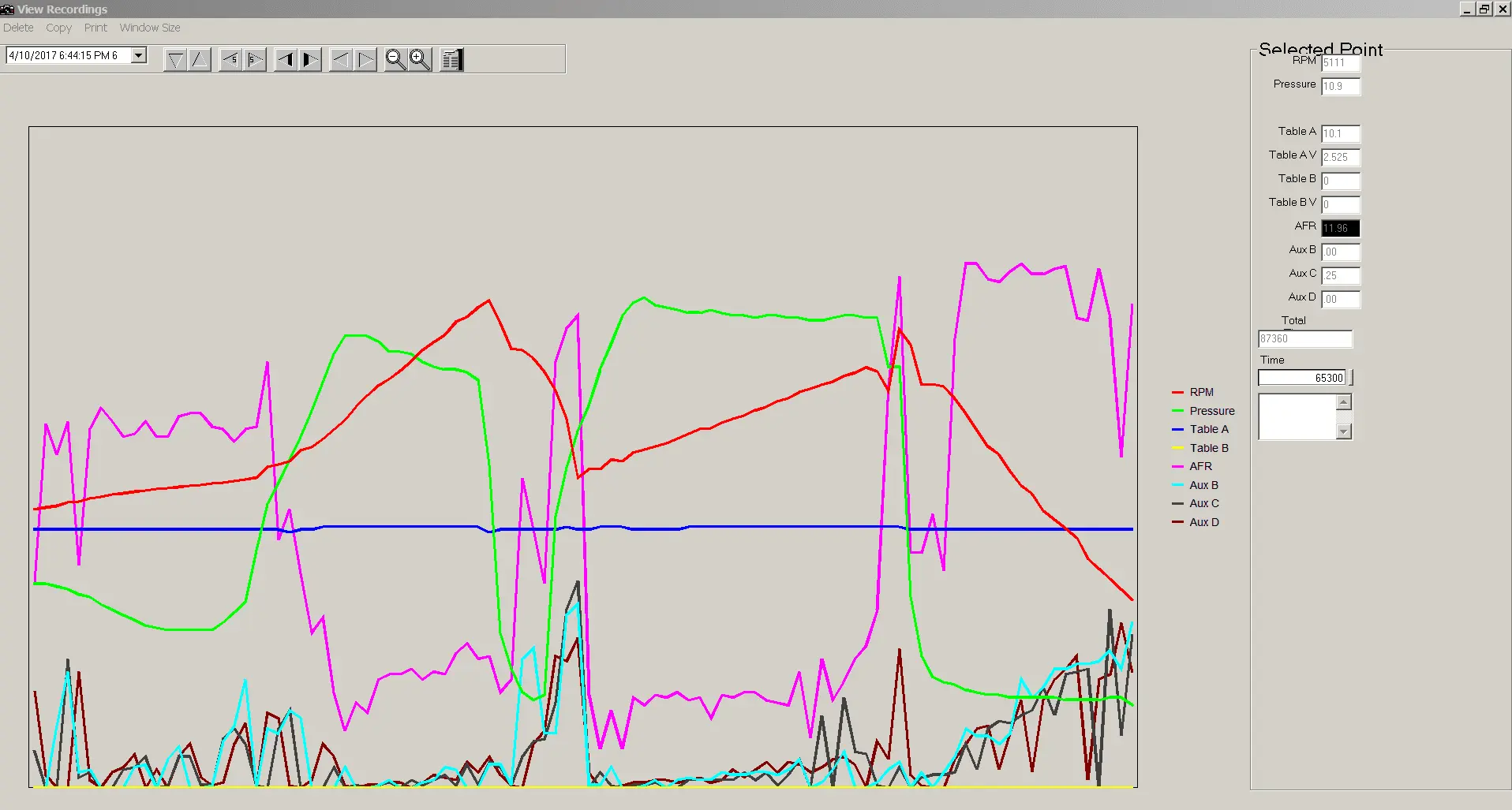

Okay for some reason it changed to 6 cylinder. I have everything else exactly the way you said to put it. I am fighting fuel cut issues right now at about 10psi. My afr's are good. They creep to the high 11s in the top end but I shift if it hits 12. (12.2 is the max safe limit if my memory is correct) But now I realized that when I bought this car it had a regular protege engine in it with custom oil and water lines. I am now questioning what injectors I am running. My map has values mostly higher than 10 but it is working well I guess. You can see the cut on the 2nd peak. The afr value shown is what it was right before cutting out.

If the injectors are purple and green they are the stock 280cc injectors. If they are blue they are likely 440cc WRX injectors.
My MSPs tend to hit fuel cut at about 14psi, in cooler weather it's around 12. I'm not certain but I believe you can use the AFC like a voltage clamp to keep the MAF from hitting 5v and cutting ignition.
They are purple and green. Mazdaspeed and reg protege injectors are the same size? And how do I stop it from hitting 5v?
