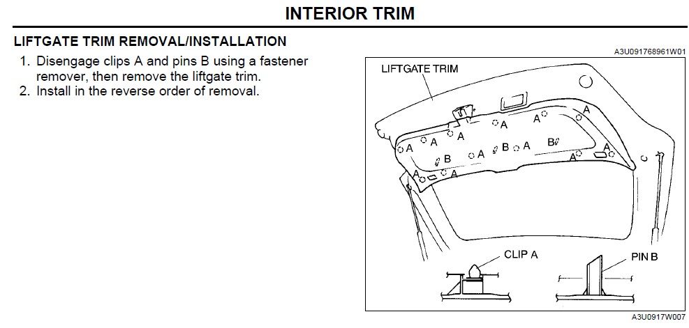

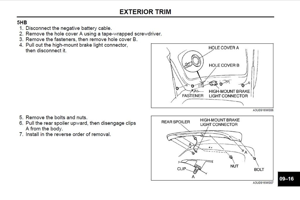

Good tip. Do you know where I can find out how to remove the inner black panel and the spoiler on the hatchback?
