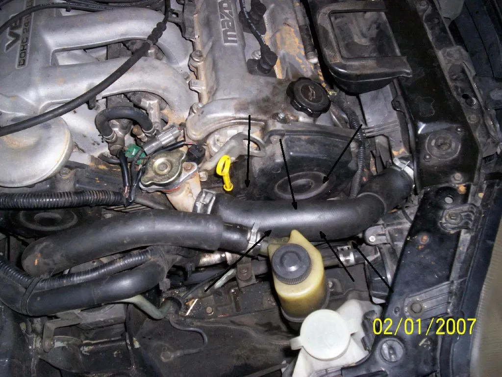

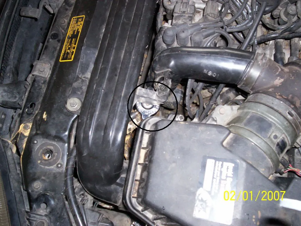

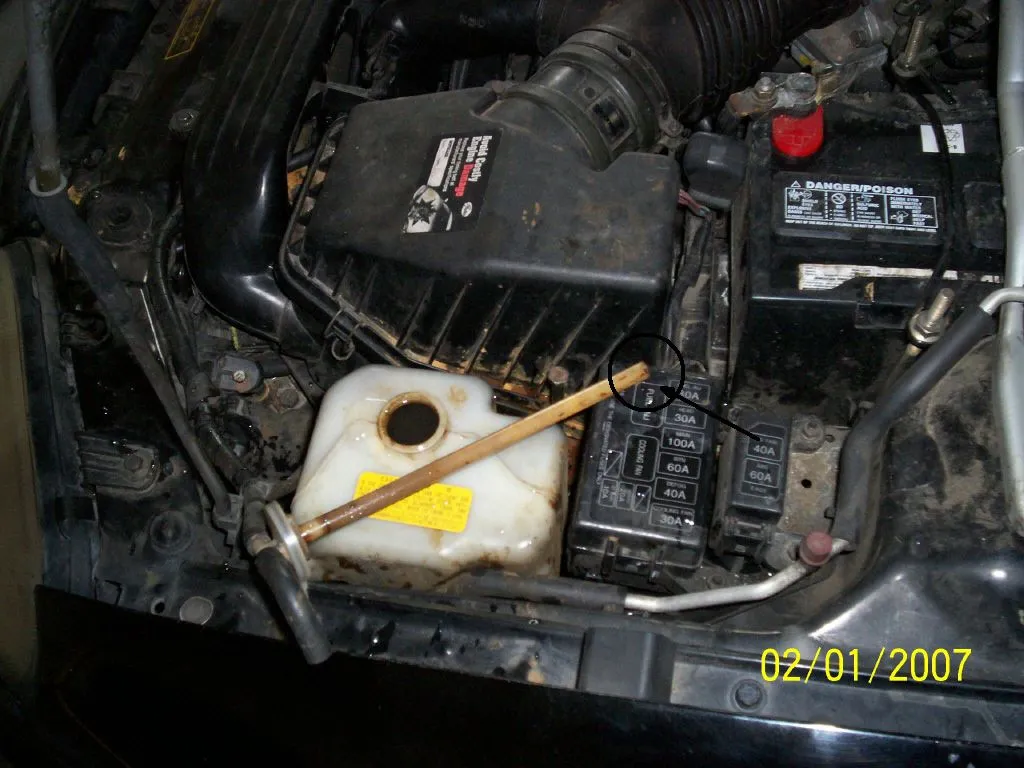

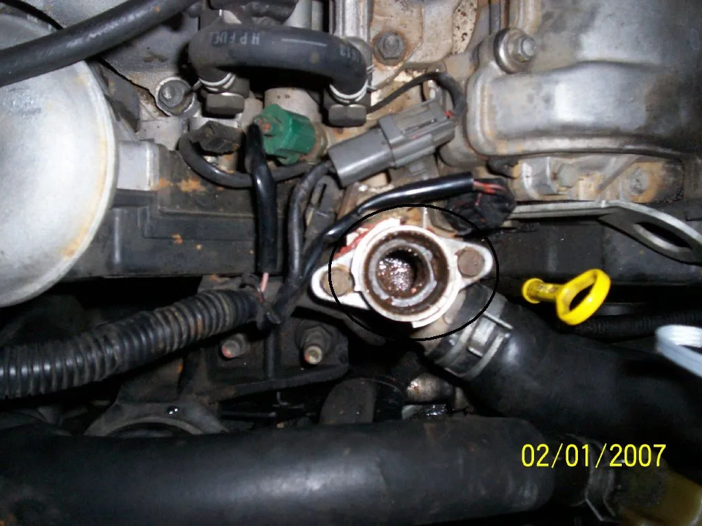

just an update on this this morning i replaced the thermostat but it has made no difference. On a short drive say 10-15 mins when you stop or i would say as you are driving along also water is just going out and into the overflow tank and hence just onto the ground. If i go for a 10 - 15 min drive and pull up at home and get out straight away open bonnet the hose here pic1 which is normally pressurized is not and you can just squeeze it easily , if i take the cap off of here pic2 it is empty and steam is escaping , also if i take this out pic3 steam is escaping from the end of the tube , and if i take the second cap off pic4 that is empty as well and steam is escaping. Where do i go from here , my garage i normally go to is closed and not reopening until the 8th so just need a little advice.

firstly, are you sure it's coming out the overflow and not one of the welch plugs on the block? i ask cos i had this happen - looked like a water pump leak but a frost plug had rusted a wee hole and was pouring out there.
secondly i'd be checking the radiator cap. the whole point of a radiator cap is to pressurise the water system to raise the boiling point of the water - if it isn't doing that then you will have trouble - also antifreeze will help raise the boiling point and i suspect if you're refilling it all the time you're probably just using water?
if that doesn't fix it, you could drain the oil into a vessel and check for water.
We call those plugs "freeze plugs" here in the United States. I've had those go bad also. Good idea to check those. They look like the cap on a very small jar off jelly or marmalade pushed into the engine block with the outside of the cap pointing into the engine.
