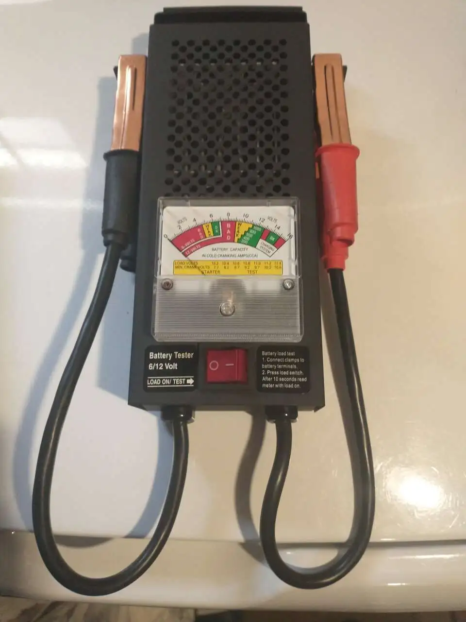

Personally, if the battery is more than a couple years old, I'd just go buy a battery at Walmart and see if it fixes your issues before swapping alternators. The warranty on the current battery is probably pro-rated so you really aren't getting a free battery anyway and at some point your time is more valuable.
1000% agree. If the battery is over 4 years old all bets are off IMO. That Walmart battery is a good battery if you can find one. First rule of electrical diagnostics- always make sure you start off with a good battery. Best tool for testing batteries (any load tester):
