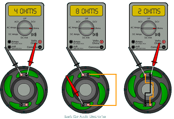

A dual 4 ohm sub can only be wired as either 2 ohm or 8 ohm. You'll need to run wiring through the firewall into the engine bay, so that you can hook up the battery connection. My best advice would be to read as much as you can on the site below before tackling anything:

Regarding wiring the sub, here is an image that should help visualize:
right. Sorry, i meant 2ohms. I'll probably get my friend to help me do this. He did all the speakers in his car, including his sub with a remote db control and all that. Pretty sure he can help me out. Thanks guys!
