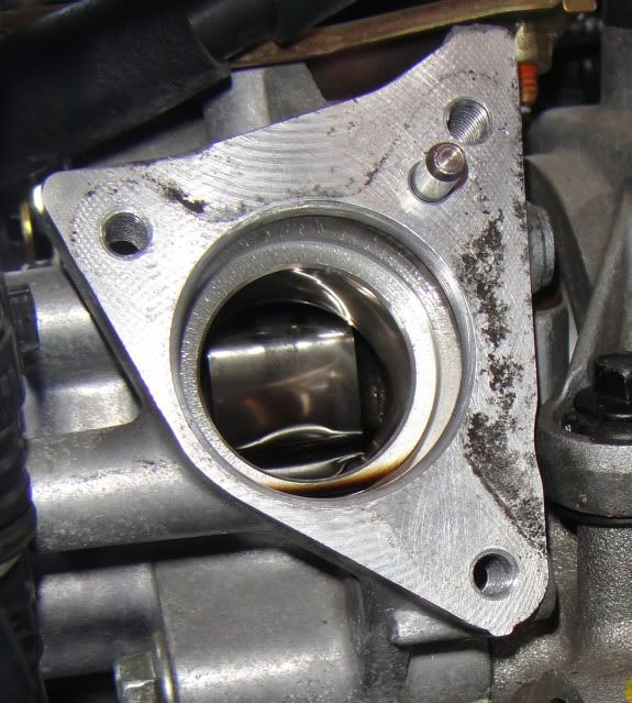

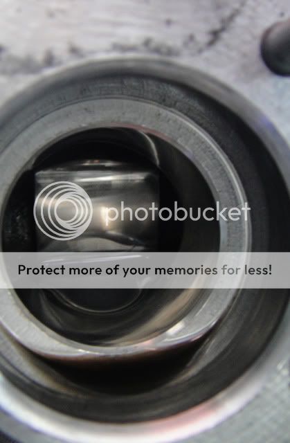

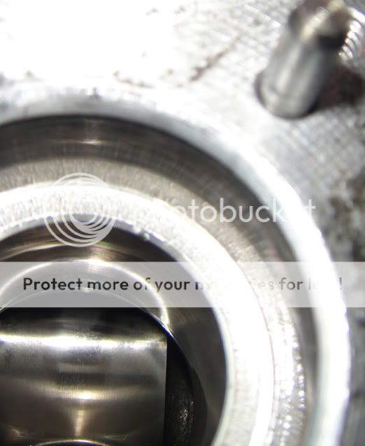

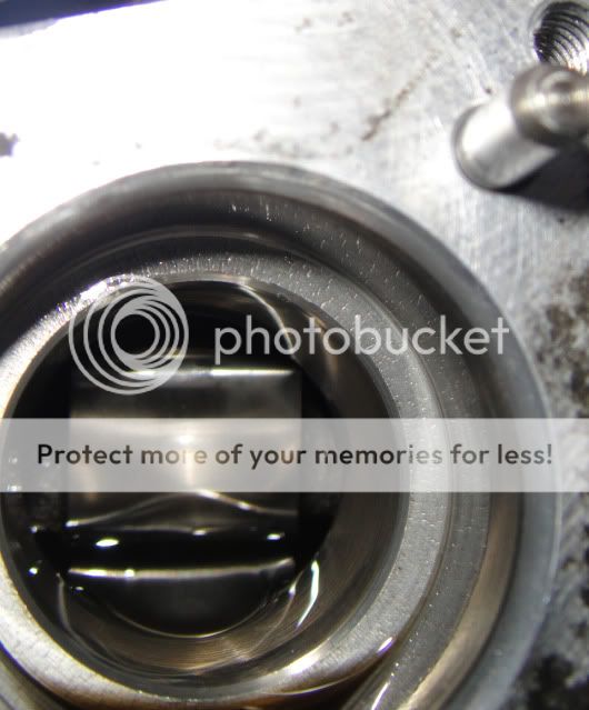

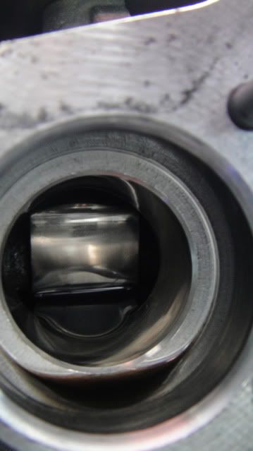

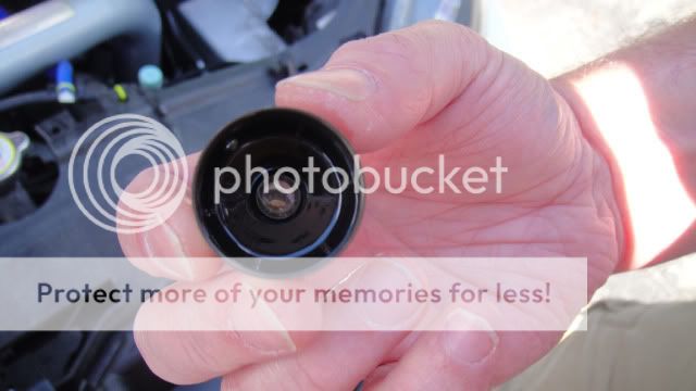

I talked to my mechanic about this, and he said the first fuel pump that seized (quit mid-shift at WOT) could have caused the cam lobe to whack the cam follower, and cause damage to both. He said to take off the pump, and look in there and check everything out. I did that after work, and took a bunch of pics, and a vid.

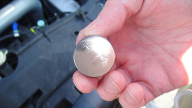

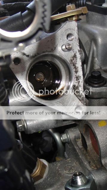

The cam follower definitely has a tiny nick in it, but I'm not 100% on the cam lobe. It doesn't look good though. Here's a bunch of pics of the follower, lobe, and a vid of the lobe.
Follower still in
Inside follower:
Nick side of follower facing lobe
Cam Lobe Pics:
And short vid of lobe (in HD if that helps):
YouTube - M4H00826.MP4
What do you guys think? Is the cam ruined or is it just the cam follower or both? Can I drive the car, or is it going to cause more damage? This fuel pump rattles also. It did when I first put it in yesterday, and again today after I put it back together. The key is my idle fuel pressure has been low ever since that first pump died. It has never recovered
