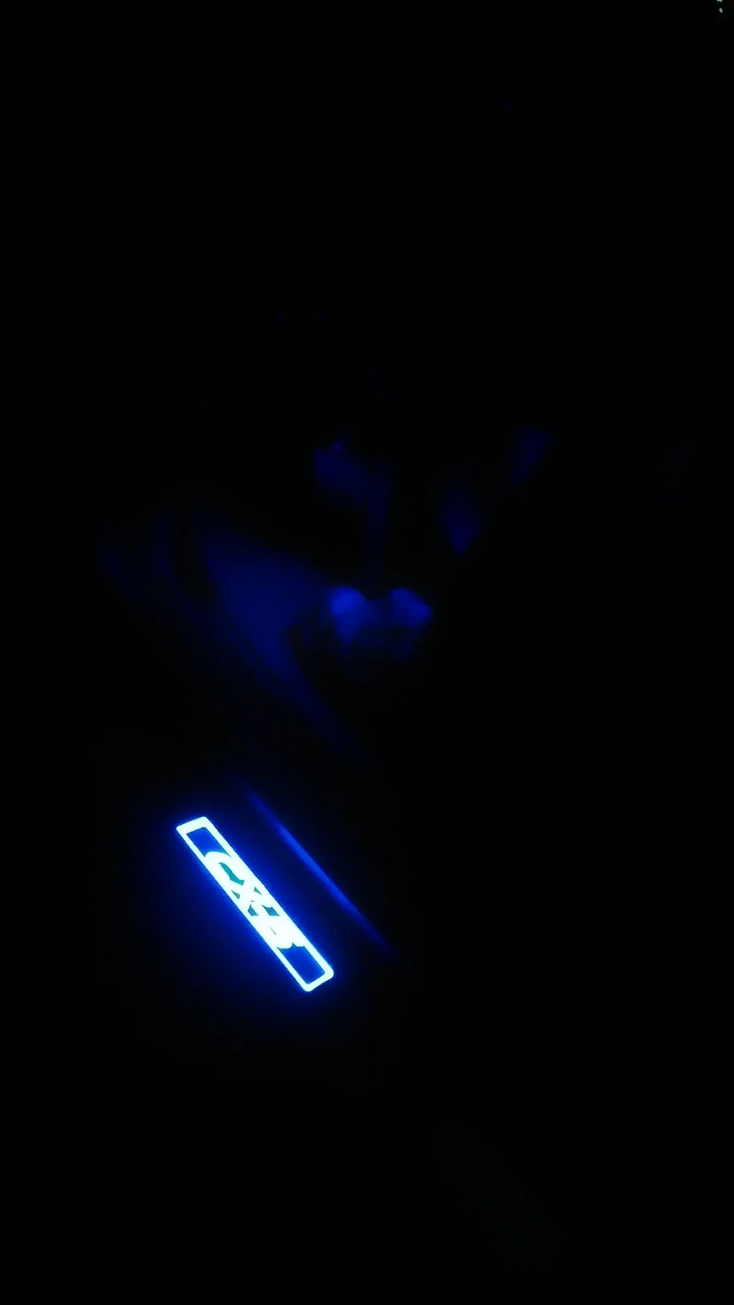

I did my 2016 footwell lights and door sill lights already. I would say 100% the easiest way is to tie into the wires in the rear run them forward to the front and bam. I did it for a total of less than 30 roughly. Got a deal on stainless led sills on eBay. Bright and looks great!! ( but my god the CHEAPEST wires I've ever seen in my entire life.... Yarn would be more consistent. ) but then I got 2 12 in blue led bars at a discount place nearby called Ollie's.IMAG0397.jpg
Tho not too thrilled at the colors or the footwell brightness. ( bars were like 3 bucks, I'll deal for now. ) and I'd rather have a green accent lightings. Might solder my desired colors later
I did my 2016 footwell lights and door sill lights already. I would say 100% the easiest way is to tie into the wires in the rear run them forward to the front and bam. I did it for a total of less than 30 roughly. Got a deal on stainless led sills on eBay. Bright and looks great!! ( but my god the CHEAPEST wires I've ever seen in my entire life.... Yarn would be more consistent. ) but then I got 2 12 in blue led bars at a discount place nearby called Ollie's.View attachment 213095
Wait so what did you use for power and ground from the back? Definitely want to do this in my cx5(footwell lighting), but in every car I've done it in, I've just tapped into a fuse. I'm guessing you from whatever source you use use, you just connected all the footwell lights together?
