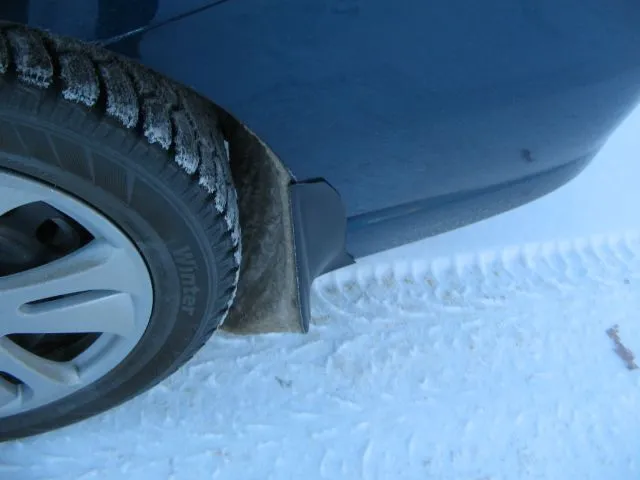

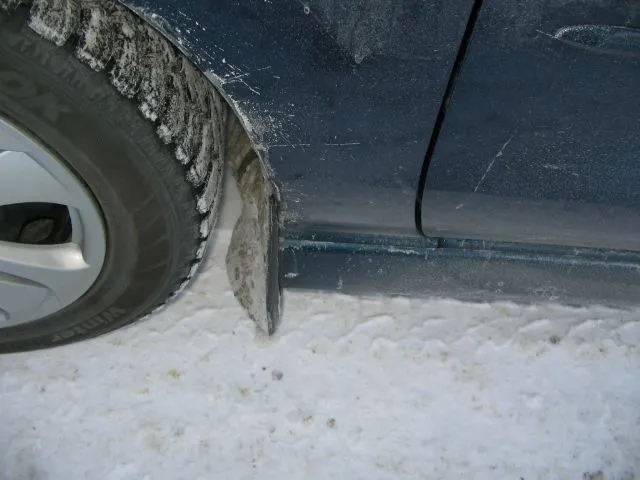

No idea why MAZDA does not have mud guard for the Mz5 GT.. here in saskatchewan, flaps help prevent the salt from residing under the side skirt the whole winter season. I had to use those mudflaps at the canadian tire.
Mud guards make for great prarie dogs eh... lol(poke)
yeah.. mudflaps on the MZ5.. its almost like an umbrella. They don't look pretty to be taking with you around. Until it rains real hard.. At the mall, I parked by another MAZda5 GT without a mudflap.. That mz5's side skirt is covered thick 'dried slurpy of snow'. lolz..
Original intention was for the mudflap to come off come summer time. But then, there are parts of the prairie roads with little peebles in them. The thought of flying stone chipping the side paint made me decide to keep the mudflap whole year round.

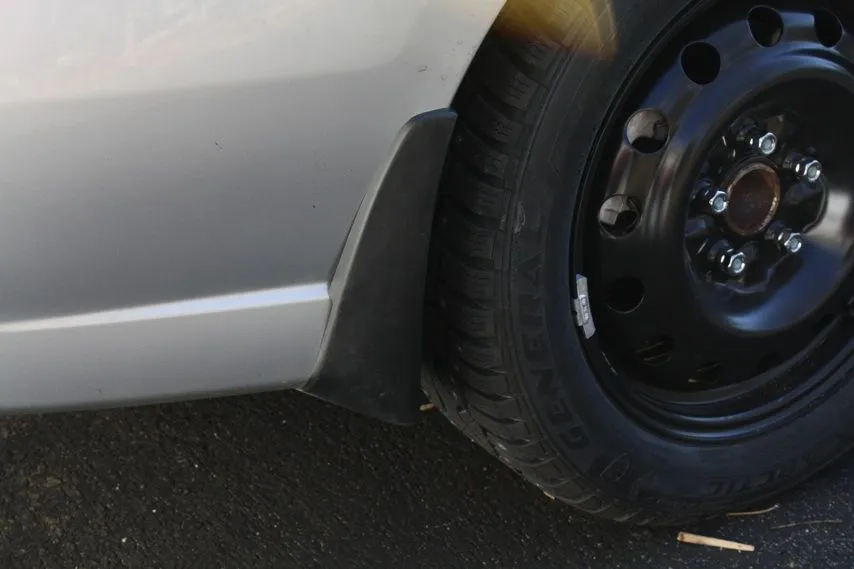

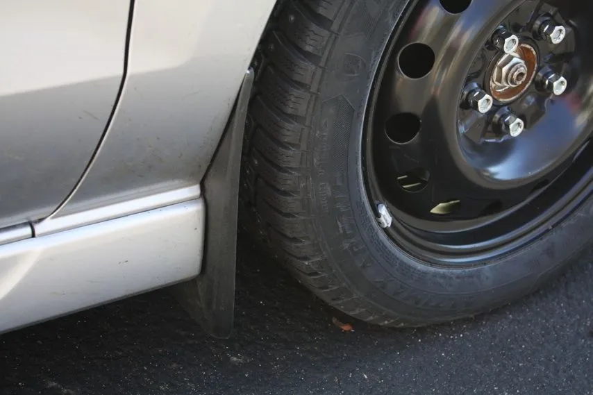

OK, here we go. Did the winter wheel changeover yesterday (see General Altimax Arctics with steelies in the pix), and installed the new mud guards while I had the wheels off. The cheapie specials on the front as suggested by sapacif, and the OEM Mazda European version on the rear.
As you can see, the Euro OEM version is a very close (but not 100% exact) fit, there is a small mismatch of the rear fender contour at the crease, but it's not a big deal. The two pre-punched holes in both flap and fender matched up perfectly, and the capture nut clips included fit just fine in those locations.
The only one that didn't line up correctly is the third one you don't see underneath, and that was easily remedied by a self-tapping screw. The diagrams in the included paper instructions were not too helpful, but this isn't rocket science. The written instructions were actually hilarious (and essentially useless), as they were in one of the worst English translations that I have seen since I worked on Sony pro analog video gear back in the late 1970s.
Example instruction: "Tightening the bolts certainly. If the bolts are tightened by out of regulation torque, the mud flaps may be broken or dropped out". There are more, too numerous to list.
In any case, they worked out OK, but a tad pricey at 48.00 given the current exchange rate. In combination with the cheap front solution, not so bad overall.
