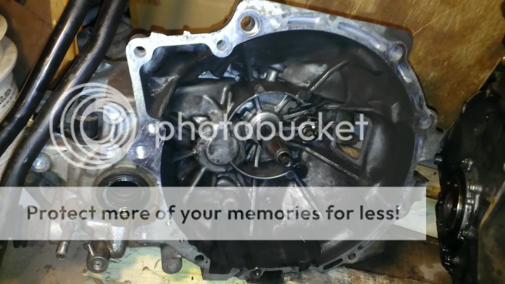

My Transmission Bell Housing:

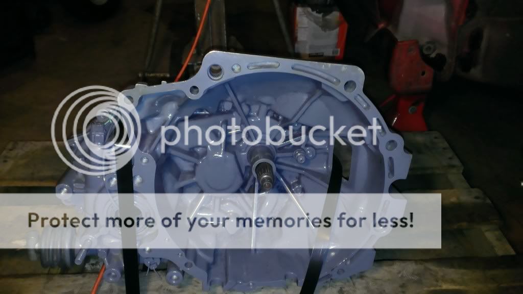

The tranny i got. Theres two half circle cutouts at the bottom, but wont that let water inside? The inside of the bell housing is different as well.

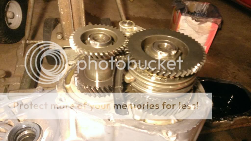

Wanted to remove my rear cap and replace it with the other one because its a little bent. Couldnt do that because the gears inside are different. Looking inside my rear cap

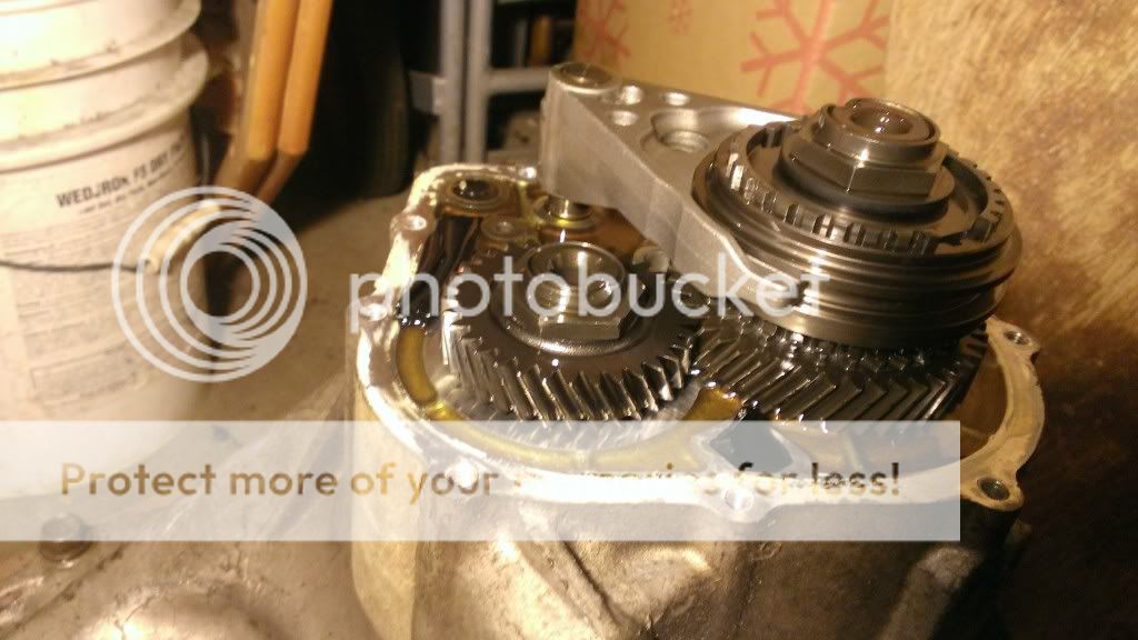

And inside the rear cap of the reman tranny i got
So Will i be safe installing this tranny? or did it come from a different car? i Dont have ABS, so maybe this one came from a car that did? or from a different manufacturer altogether?
"The tranny i got. Theres two half circle cutouts at the bottom, but wont that let water inside? The inside of the bell housing is different as well. "
If its like that I wouldn't try it. its better to be safe than sorry

You're very misinformed. Gears are not longer. 5th gear is not the others though.and 626 trans is not stronger.holes in the bottom of the bell housing was done to drop the main bearing support plate to change rod bearings without pulling motor, get a plug or fill it with silicone.There were a s*** ton of changes in the g series trans over the years but they're not that different bell housings do have different shapes especially coming off a kl. lots and lots of use less info on the g series in my head
I'm kind of thinking what op got is an f series trans, which will work with his original bell housing but they're not very strong by any means
F series is the one pulled out the car? or the reman is an F series? Both transmissions are labeled G560 on the bell housings.
