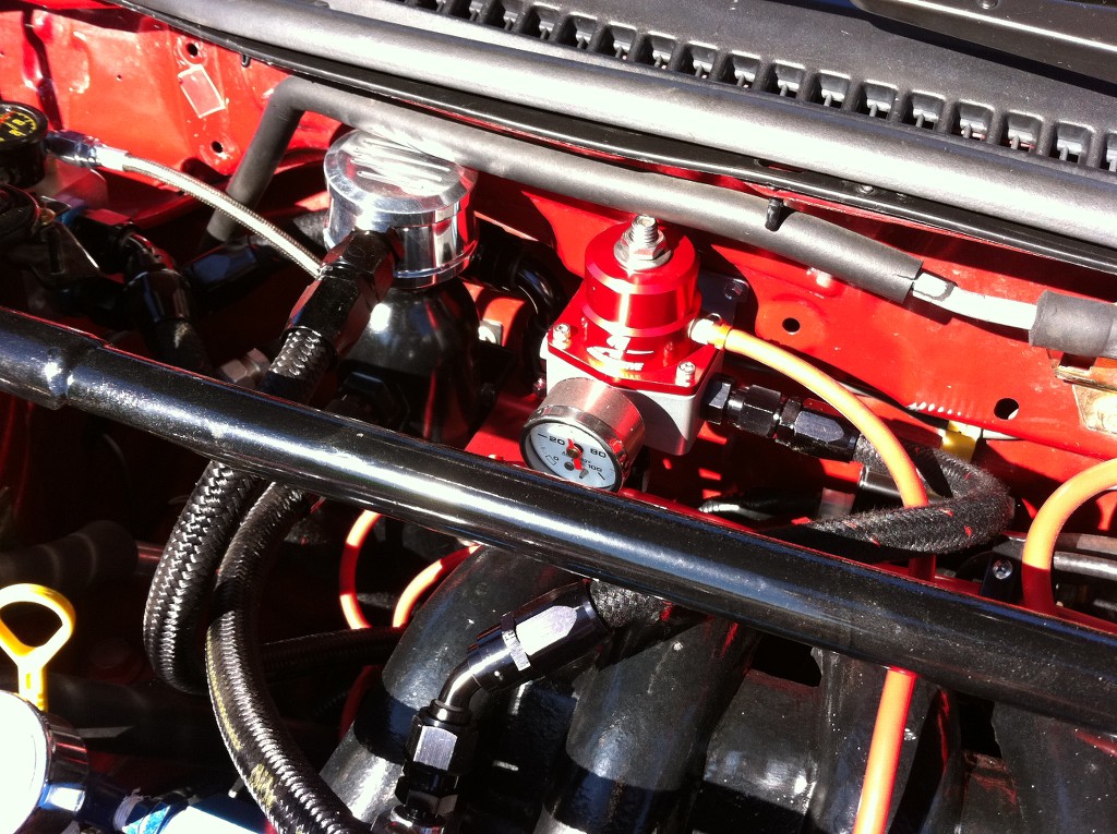

Here you can see the external FPR. I've got a fuel pressure gauge inside the cabin, as well as on the FPR itself and directly on the rail.
I bought an aeromotive fpr too that i plan on installing. The aftermarket cam gears are just not worth the headache. Some sensor would not work with these gears so i feel factory will be a better option. Im running fsze cams i bought from corksport. And i got a good deal since i was able to trade the gears over for the 600cc injectors. If they are too bog again maybe ill downsize but i have a feeling these will do fine.

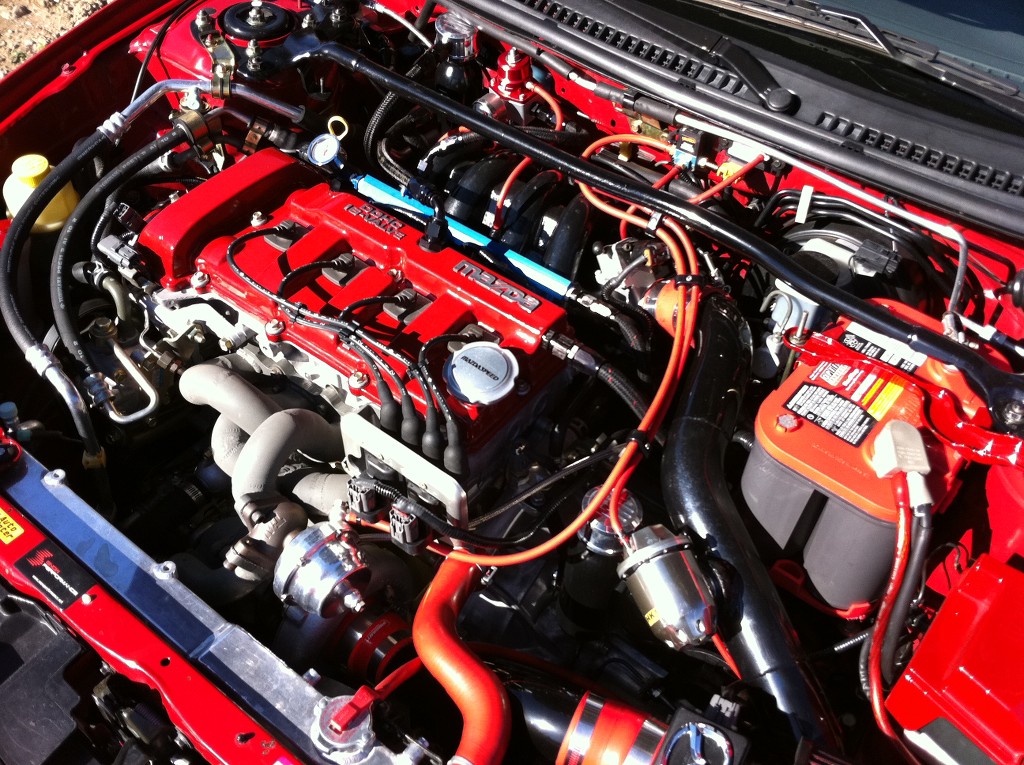

Painting the transmission endcap today. Also bringing in the car to paint the engine bay soon. Got a scrapped and chipped from the last few shops.

bump just got the 600cc injectors in the mail. Car is at the body shop now getting the engine bay repainted
So the engine is ready to drop back in just 1 final setback. I need a new factory oil cooler since the one on there potentially has a bunch of metal shavings in it. Only problem is it is on backorder from mazda tell who knows when.
