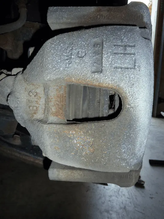

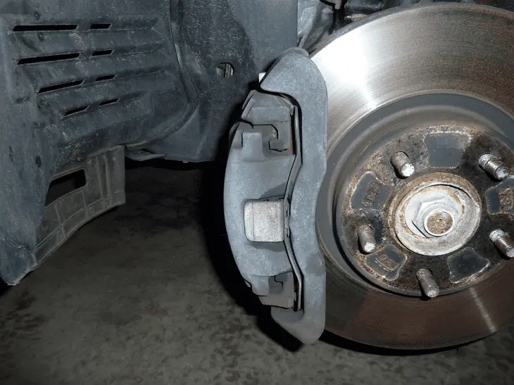

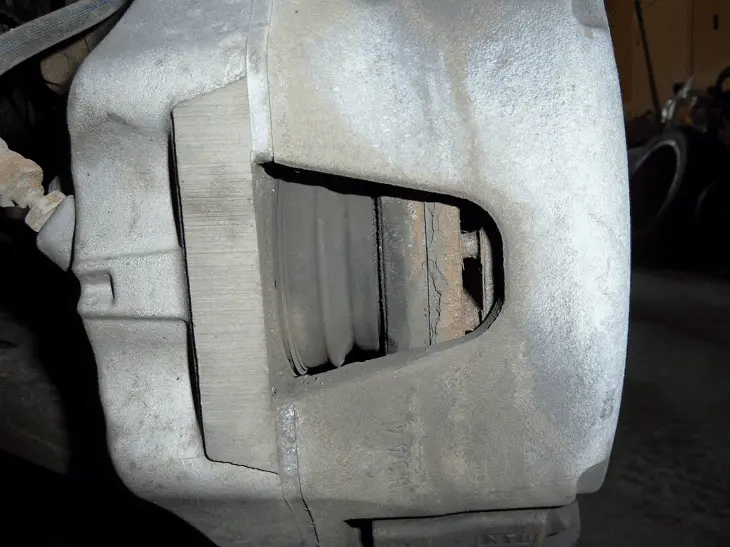

Sorry it took so long, guys. Don't have a good excuse, just busy... Here are the results:
While I didn't take the rotors and pads out I did measure the outer diameters of the caliper pistons. The MS3 caliper has (as you will see in the pics) a lot more metal overall, this includes the metal surrounding the piston bore. The OD of the MZ5 was about 2 3/4" and the MS3 a hair under 3", but the amount of metal around the piston was greater, which puts the piston bores close to, if not exactly identical. This gels with parts lookups.
But despite any similarities with the pistons, because the mounting is integral I don't see how you could reuse it on a larger MS3 rotor. And even if you could, you'd be stuck with the smaller MZ5 pads.

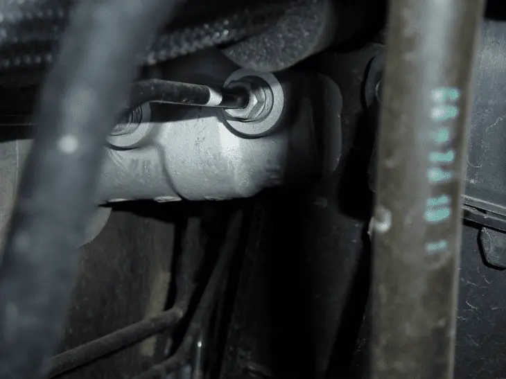

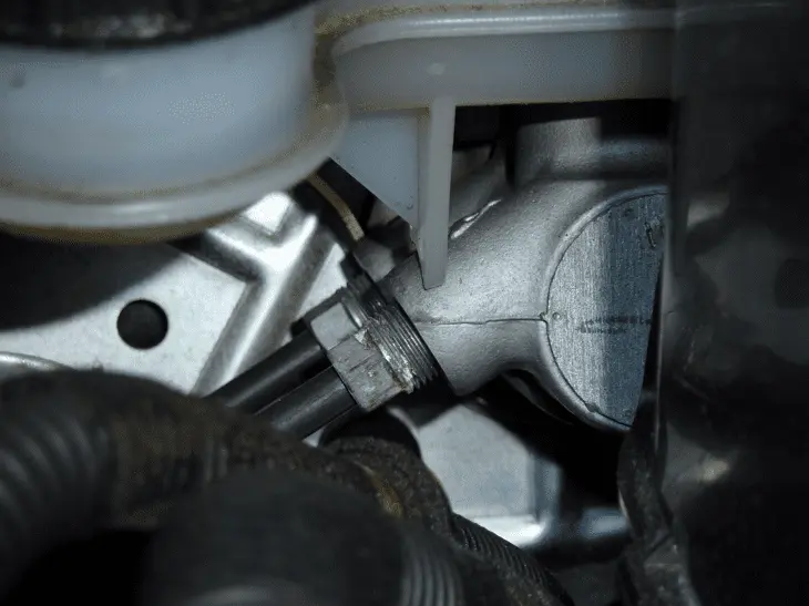

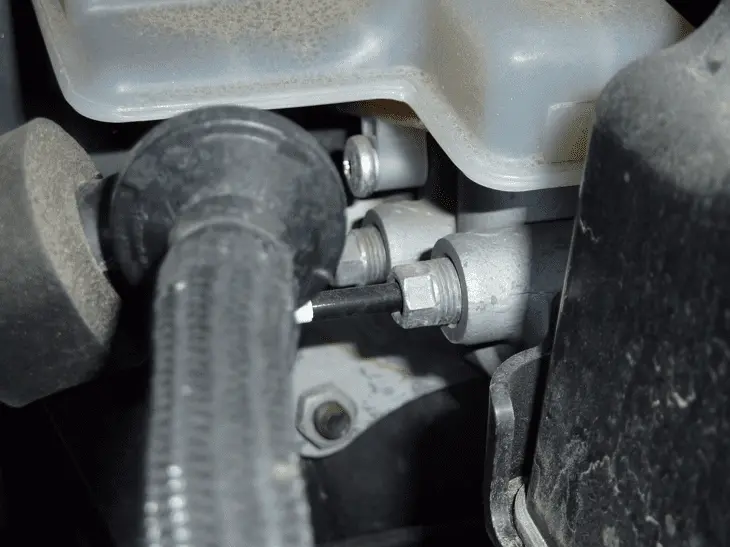

The master cylinders, like the pistons, appear to have similar hydraulic dimensions (although it's much harder to get at both of them for a good comparison). But the reservoirs are VERY different and that aside the bungs are very different as well. I'm not saying you definitely can't exchange them, but it would take some finagling.
Anyone with a 5 might notice the "dual" tank reservoir. There's one immediately on the MC and then there's a hose and a "remote" tank which is the one you fill. This appears to be purely pragmatic as you'd have no way to fill the main tank. It's just too far under the hood. The 3 has less recess in this area so it is a single tank design. It might be possible to swap tanks, though.
The bungs are pretty easy to see in the pics. The 5s are straight out:
The MS3s are angled down:
In this case is the MS3 that has the clearance issue. As such I believe it wouldn't be too much of an issue to put that MS3 MC into a 5, you'd just need to bend the tubes a bit. I think to go the other way might be more difficult, having less clearance. Again, bores seem similar if not identical, but perhaps there is more to them that makes them different. Certainly the MS3 brakes feel much harder, less spongy and more responsive (not that the 5 doesn't have really good brakes).
