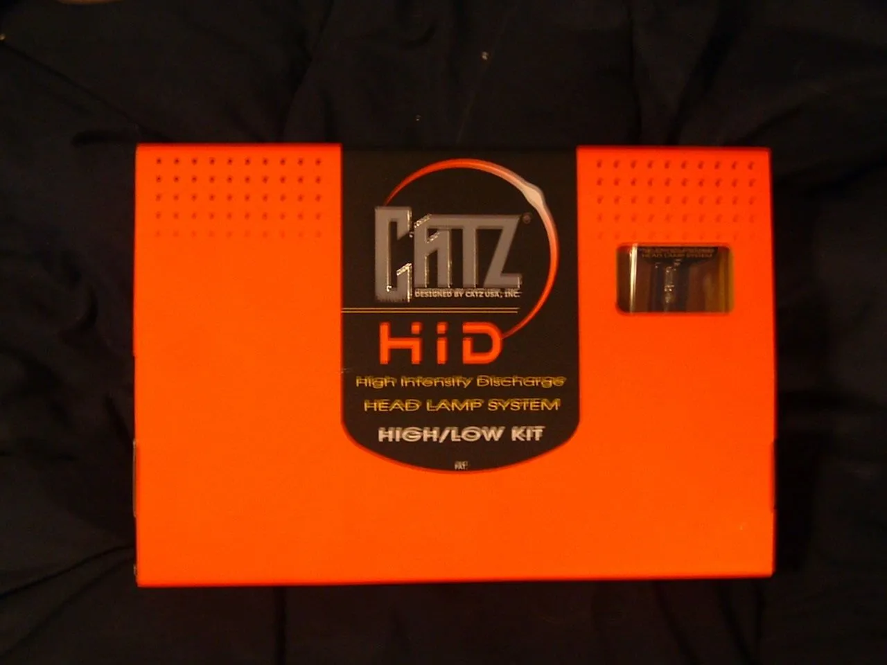

teh UPS fairy was kind enough to drop this off earlier for me so it was here when i got home. should be installed by this weekend at the latest.

Nice lights @$$hole. :D

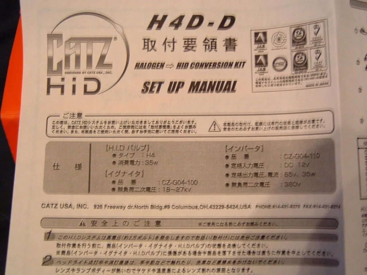

the lights are 4500K low/high beam setup. i don't know about you guys but i'm not up on my japanese

that is a very nice kit. that will be one of the first mods after the BOV for the MSP when my gf gets it.
It should be a simple install, ground power, and headlight (low/highbeam) inputs.
just need to find a good spot for the ballasts.
How does the ballasts get installed? Do we need to drill any holes in the engine bay for them to get fitted? oor can they just be twisted tied to something?
What bulb # is our car's using?

nevermind, i see H4 written on the spec sheet.
btw, how many bulbs are in ou headlights?
I notice at night when we don't turn our headlights on. the daylight running and low beams don't make much of a differences. Are they sharing the same bulb? is that why?

Yes H4's are single bulb lights.

a couple of the most important things to remember is that Philips and Osram are the main manufacturers of factory HID's so odds are if you find somebody offering "PHILIPS HID's" then they're probably just the ballasts so don't fall for it. another is the kelvin rating on the lights. the higer you go the more blueish-purple they tend to get. whether it be different gases inside the bulbs or some kind of tint on them they become more useless as well. this explains why i went with the 4500K RISING WHITE. its about the purest white color you can get.
and last time i checked the US cars don't have day time running lights so nothing will be cutoff or dissabled.
also, with alot of the HID kits that are available they only come with a low beam,there's no true high beam HID. different companies use different methods of acheiving the high beam whether its by using mirrors or moving the bulb. the CATZ system's high beam actually has the bulb move back into the housing more which creates a wider pattern when you flip the highs on.
with the normal HID kits, when you flip the highs on the lights completly shut off from what i've heard. not exactly a mistake you want to make to many times
