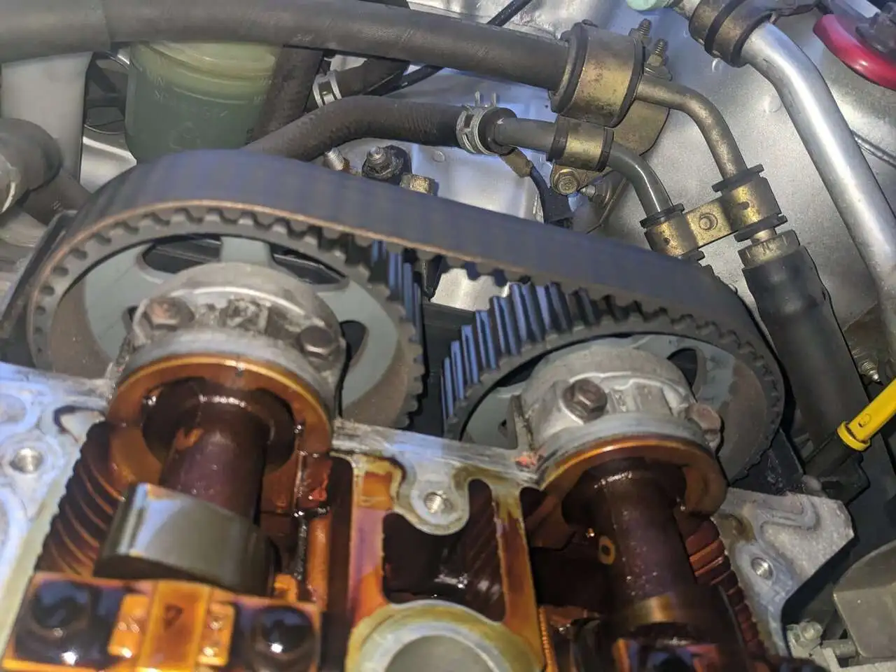

I realized I can probably take the valve cover off to get eyes on the timing belt, but would I be able to get an idea of whether or not it is in good shape?

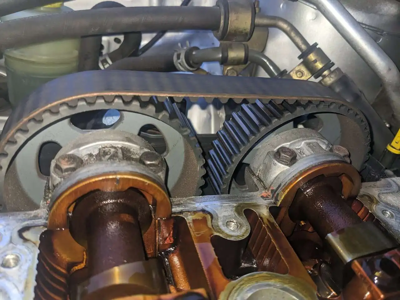

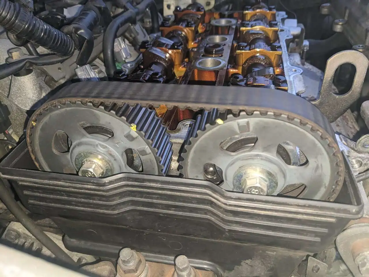

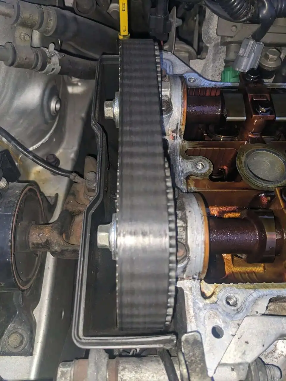

Took off the valve cover, took a few pics of the timing belt, cranked it over once and took a couple more.
Anyone able to tell if this belt looks replaced somewhat recently?
I did notice on the sides some of the rubber has worn, making what looks like a strip of copper visible. Aside from that, I am a little clueless.

Timing belt looks mint, no fraying or cracking, the copper strip on the side is normal - its the reinforcement layer in the belt.
For clunk I'd check the CV joints for play, maybe the shifter mechanism?
It's a non-interference engine.
Just run it until the belt snaps.
Get AAA,.. or CAA in my case.
You can replace the Timing-Belt several times with no damage.
