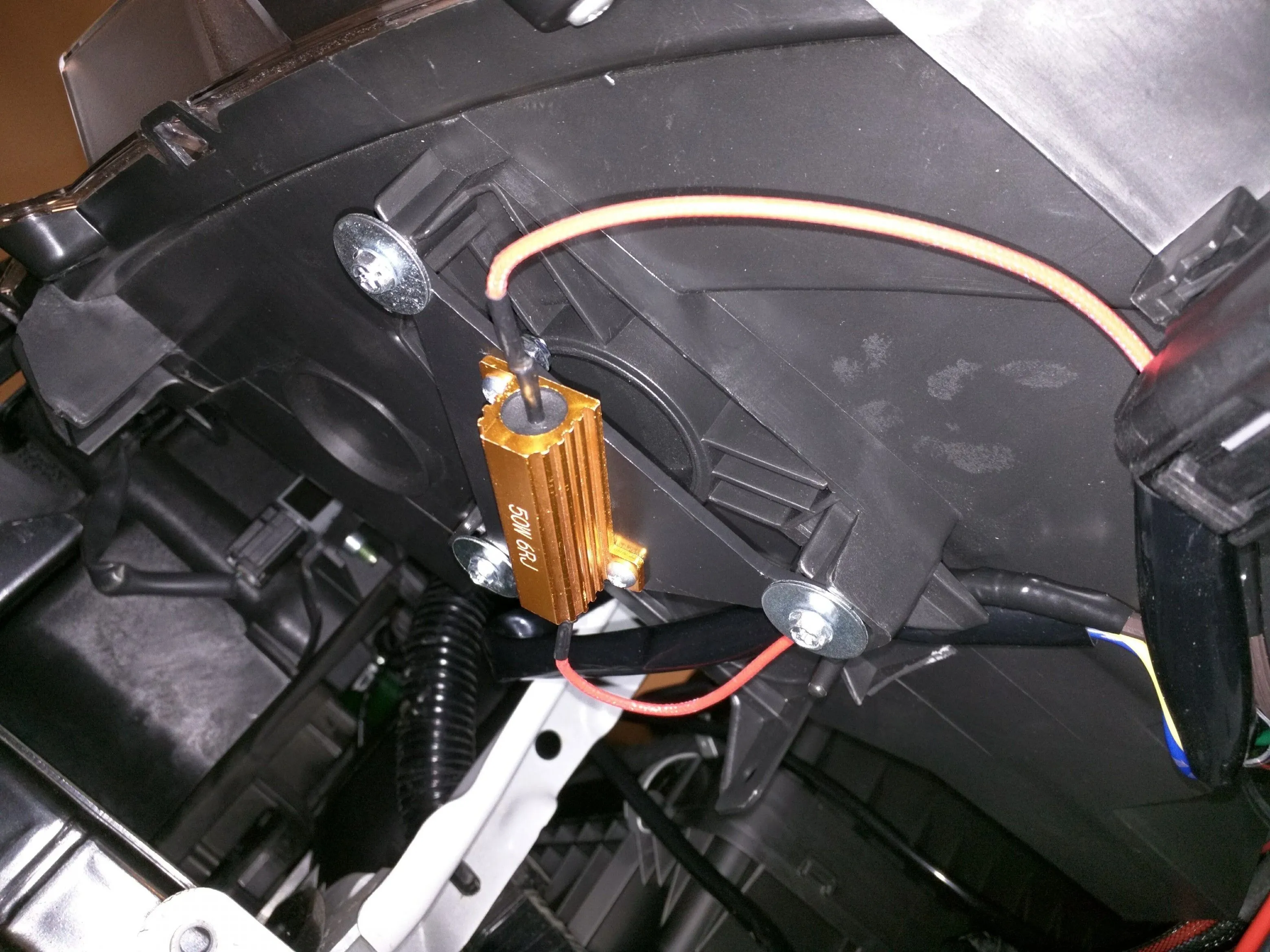

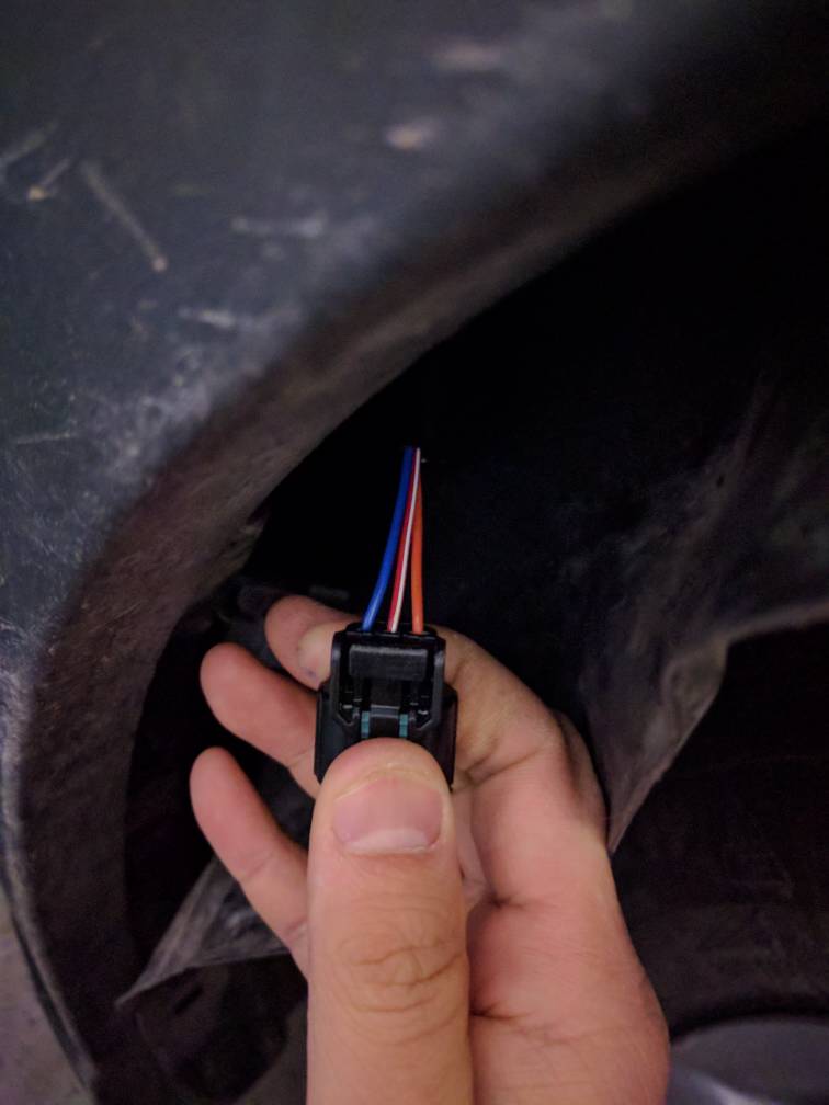

You need a resistor for each blinking bulbFor the hyperflash issue, does it matter which turn signal it is installed on? I installed leds on both the front and rear turn signals. I installed a load resistor on the passenger rear turn signal but it looked like it did nothing. Wondering if I just need to buy more resistors.
Sent from my Nexus 6P using Tapatalk
Yeah the space is tight at front unless you can manage to pull the whole liner out. By looking at pictures in post #34 of this thread, OP tomcat1446 soldered some wires onto resister and spliced the wires to factory wiring harness. I thought that is a better way and you can remove those spliced connectors if needed without doing too much damage to factory wiring harness.So I finally got my hands on 4 resistors. The rears were easy to install as there is plenty of space. Is there an easier way to install the front ones? I removed the wheel liner but the spacing is really tight. I soldered the rear ones, and wanted to solder the front ones, but I can barely get my hands in there, let alone a soldering iron.
