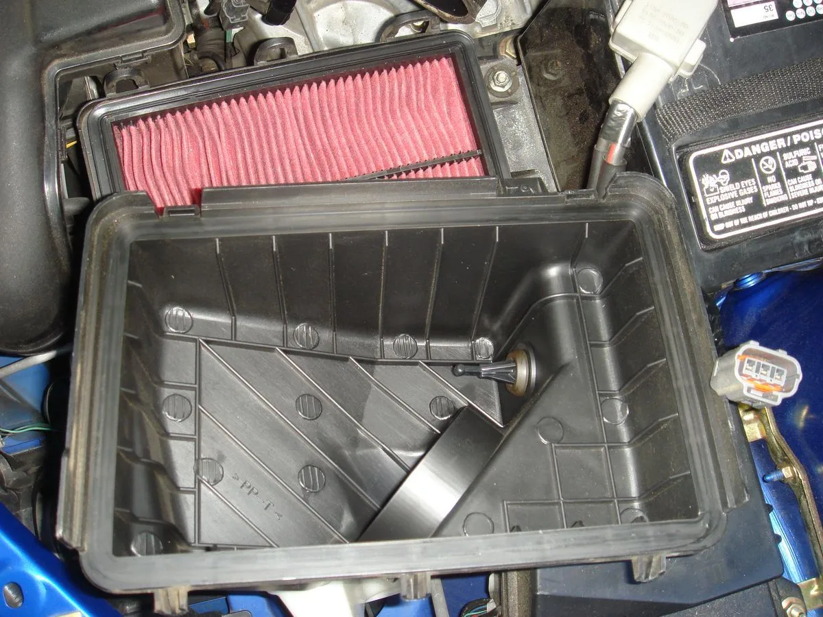

Uh...so I did it today, and now just wait for it to dry.
I was also looking for the IAT, and I took a pic. see attached.
is that the one, the one sticking out? It feels like plastic pole to me tho.
Josh

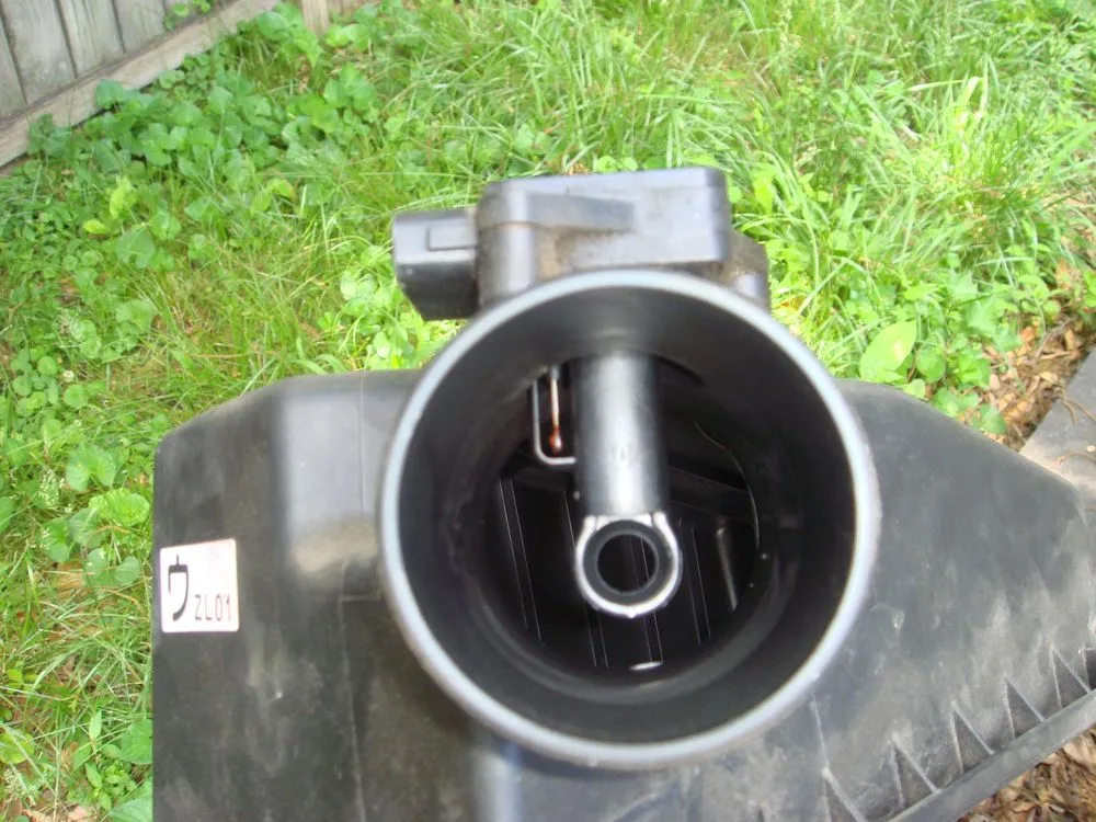

It seems ZM engine the MAF and IAT sensors are integrated. So can I spray the cleaner onto them both?
Honestly I can't really tell where the MAF sensor is, can someone tell me if there is anything missing in the picture?
is the red thing with the wire the MAF or IAT? there seem to be only one sensor but there are 5 wires coming out.
Josh

That looks like a different model MAF than what is in my Protege. I may be wrong though since it has a while ago that I had mine out.
Yeah sorry but I should have mentioned that MAF with AIT integrated is from my gf's '00 LX protege. I was wondering since the MAF and AIT are integrated together can I just spray the MAF cleaner on them...
Josh
you should be ok to spray the AIT as well. All it will do is clean it...
Yeah I felt a little stupid asking that question, but as you can see in the pic, that MAF&AIT stuff looks so different from P5's MAF, and also it's on the side instead of in the center. wierd weird.
And, is the thing in the pic of my post #10 the AIT? That's from my 2.0 P5, it looks like a plastic pole, I was expecting some wires or something metal.
Josh
The AIT sensor (or IAT as some call it,).
The manufacturer calls it IAT ( intake air temperature) which is why some call it that. It's purpose is to measure the temp of the air going thru the intake not to measure the temperature of the air intake itself so that's probably why. Other people know what you mean tho...............Yeah, clean them both but don't break the 300.00 wire in the MAF trying to wipe it. No need to touch it, just spray it with MAF specific cleaner.
