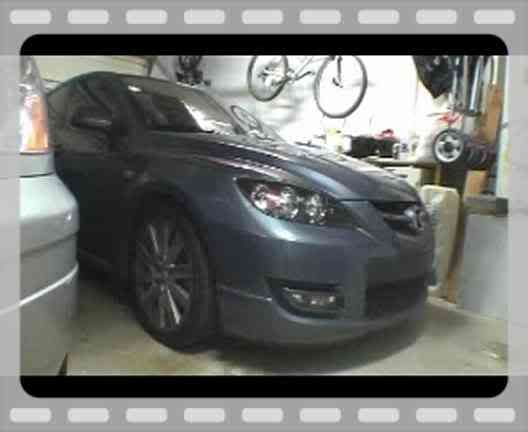

I bought a low note horn for $16 at Autozone and added it to the current horn.
Here's a clip.
