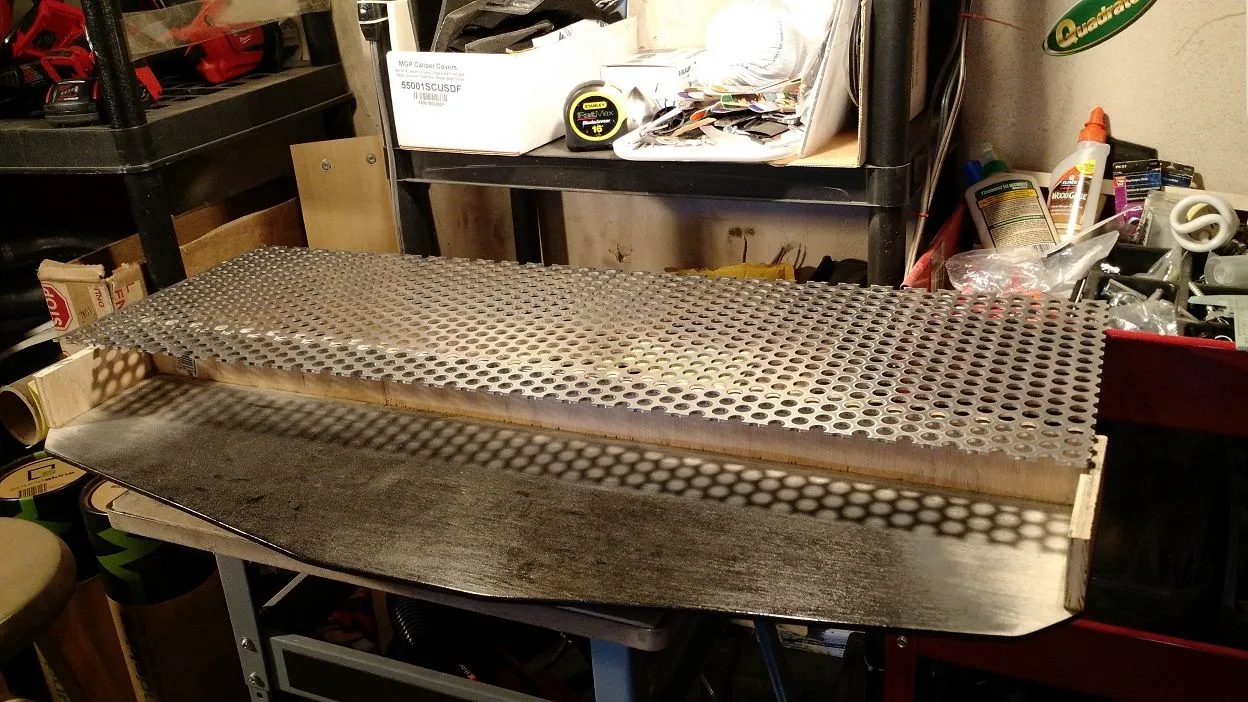

The amp rack will be made out of perforated aluminum with LED back lighting.

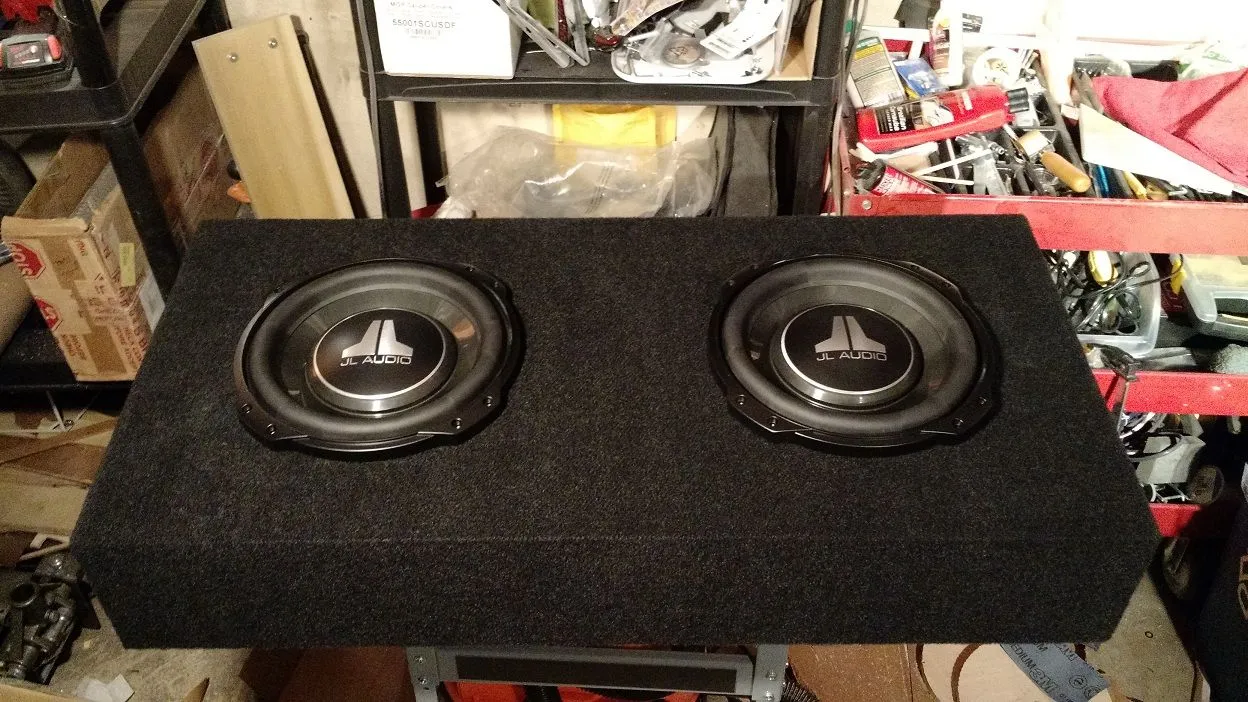

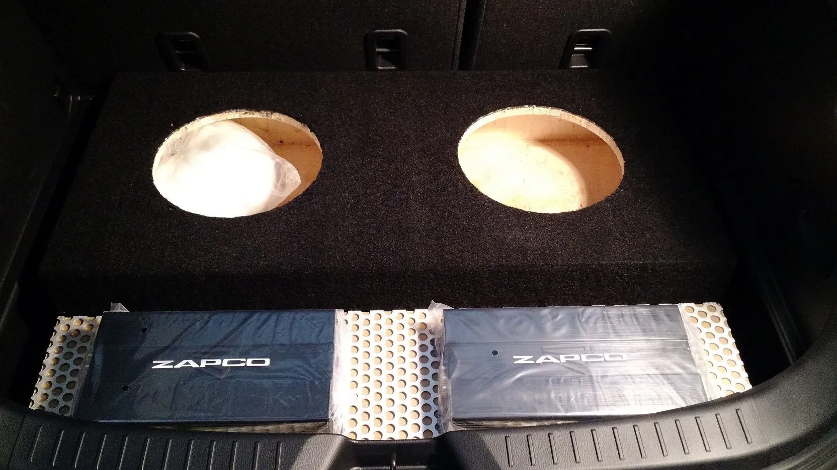

Sub box is done.
Sealed with 1.3cf of air space. Built with 3/4, 13 ply, void free, baltic birch... Subs are JL Audio 10TW3-D4s.

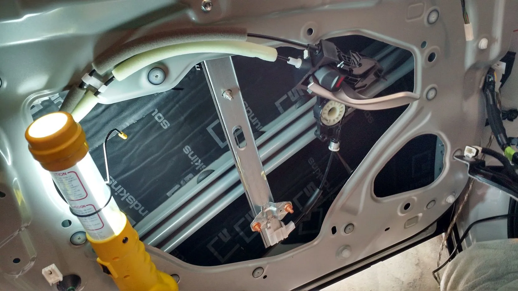

Got some work done on the drivers door:
- Sound deadening
- Drilled hole and installed wire loom
- Ran speaker wire for mid bass and tweeter (2 pairs)
- Made a speaker baffle out of HDPE and mounted with AudioFrog adapter
- I didn't like the cheap factory door clips so I replaced those

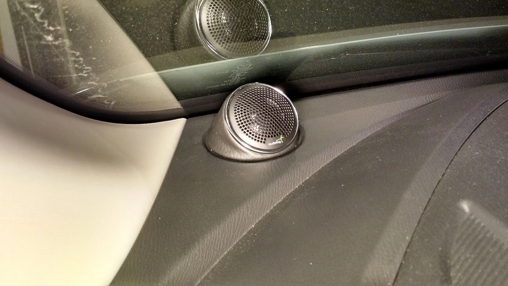

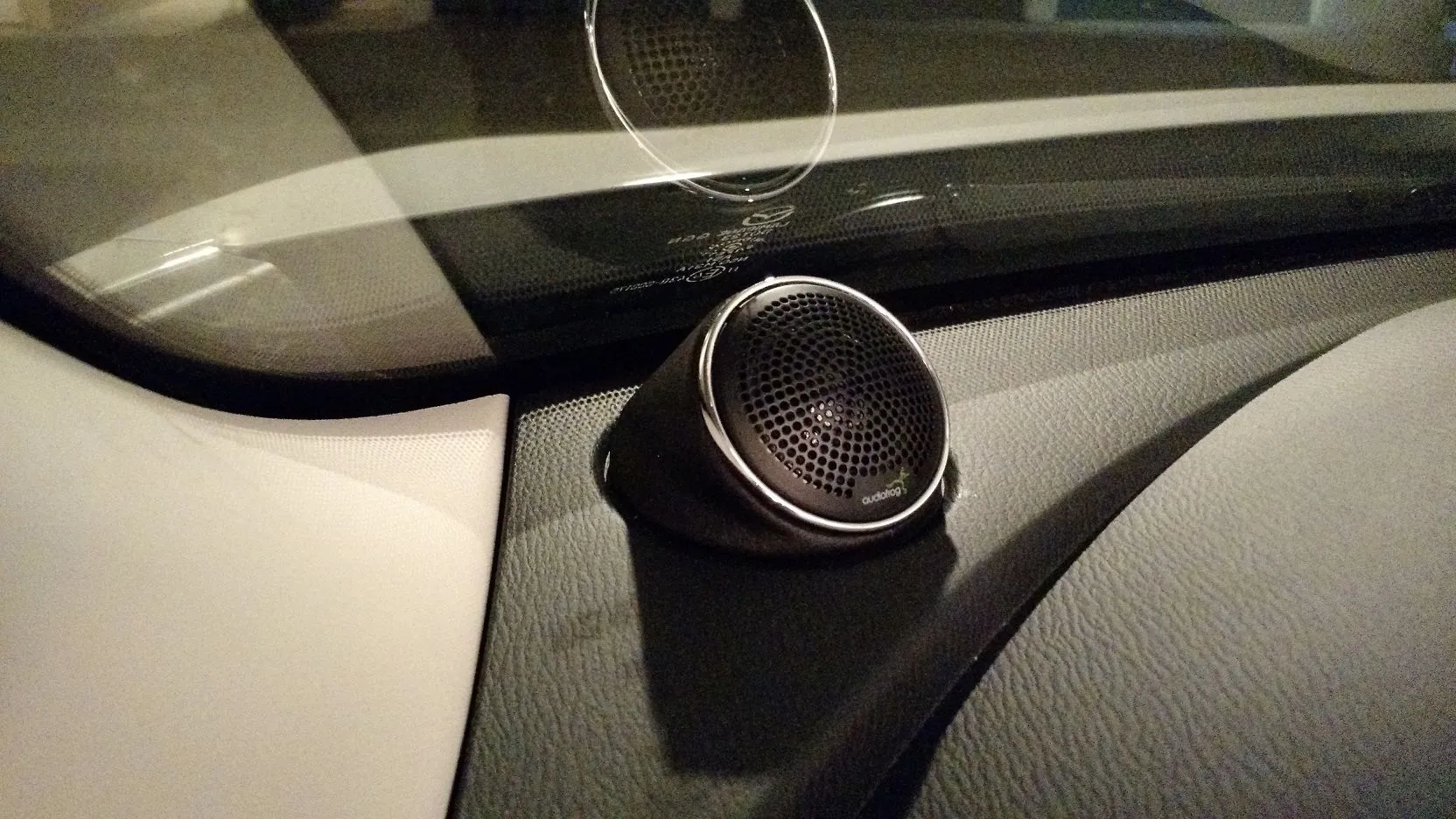

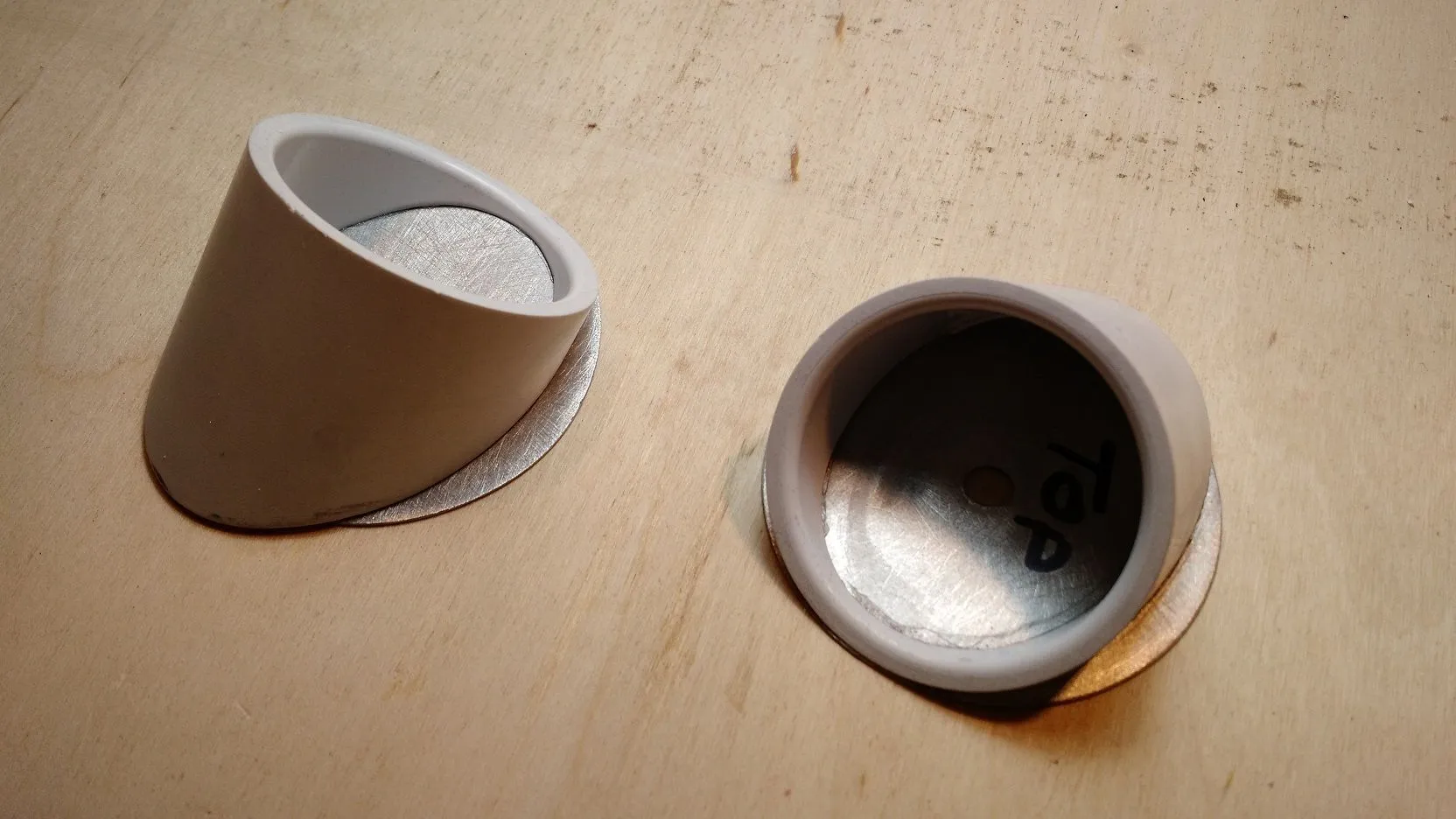

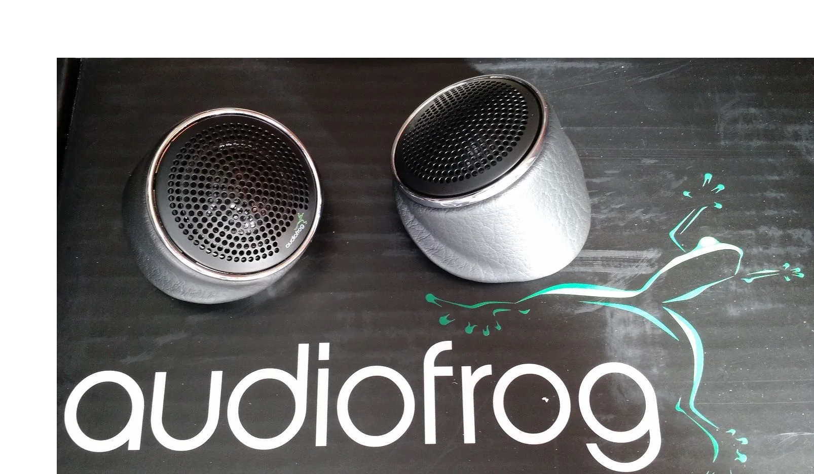

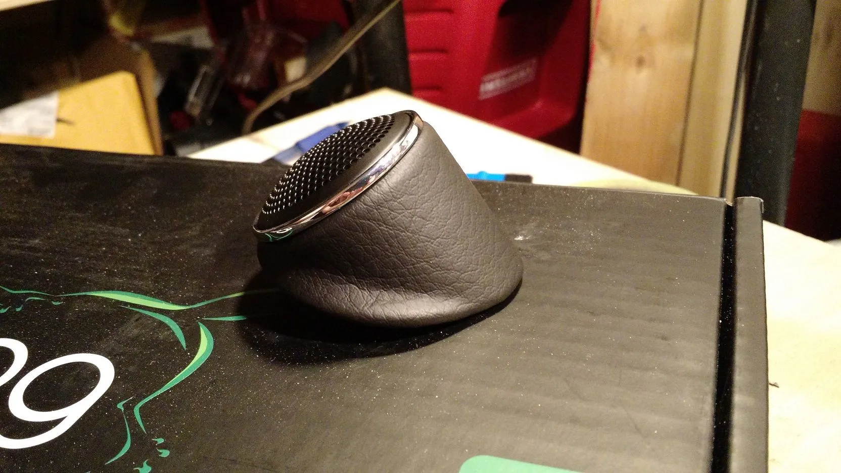

Made some little pods to put the tweeters closer to on axis, and especially away from firing directly at the windshield.
After lot's of searching, I found some vinyl that is a near perfect match to the dash.
PVC pipe fitting, aluminum base and epoxy...

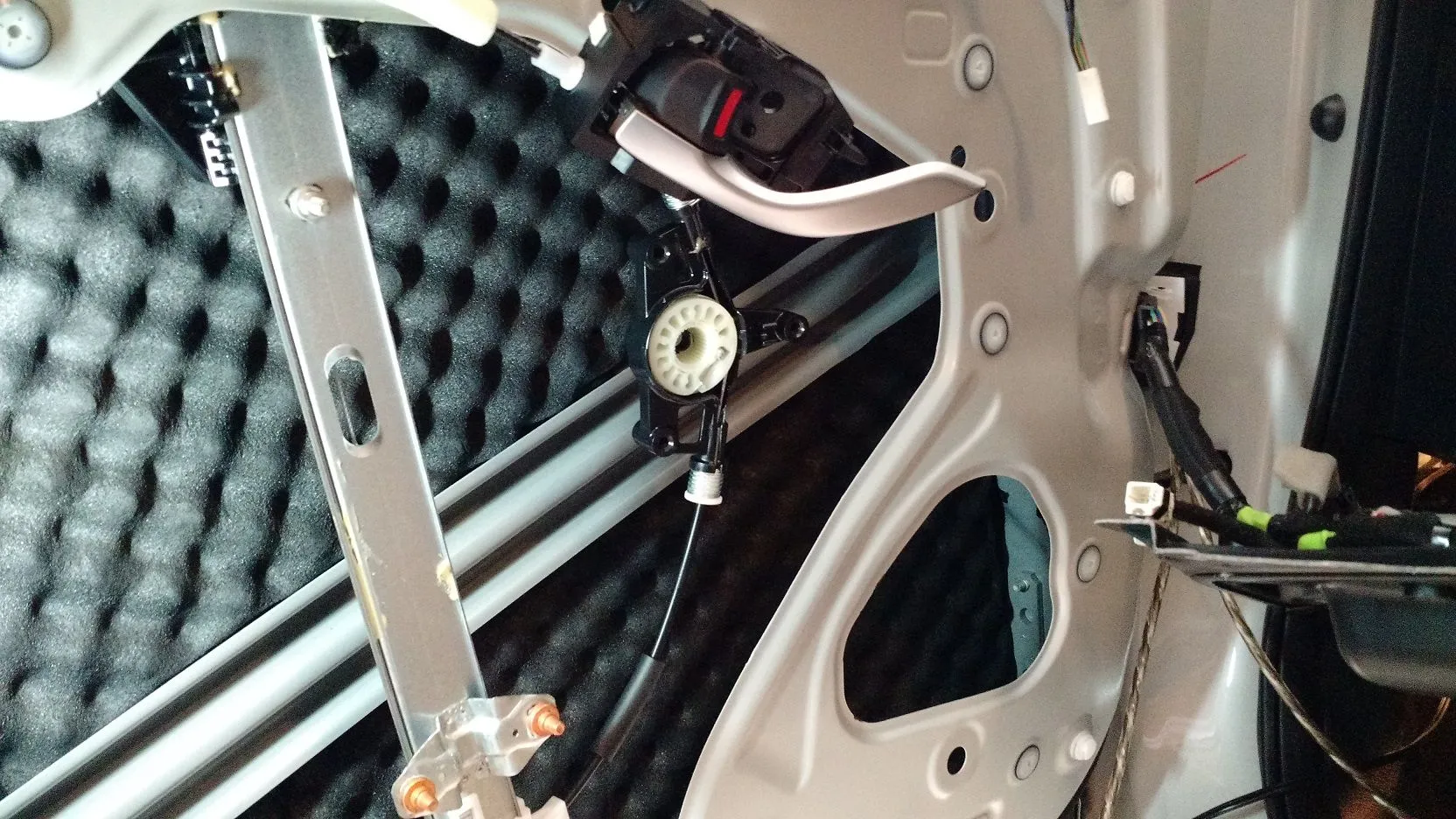

Ripped open the passenger door to begin sound deadening and mid bass driver install
Drilled a hole in the factory plug to run the big fat 14 gauge Knukonceptz Karma SS Kable speaker wire

I will drill two large holes in the factory lid/cover for the subs and mount some brackets to the back of the trunk to support it over the amps. The lid will rest on the sub box in the front and on the brackets in the rear, allowing for normal use of the trunk and also be somewhat discrete...
It will easily be able to hold 100lbs again! :)
Finished up the passenger door:
The doors are much heavier with all the sound deadening, but there is also zero noise coming in from the outside through the doors.
Next I am going to deaden the hell out of the dash and and firewall to reduce the engine noise coming in the cab...
