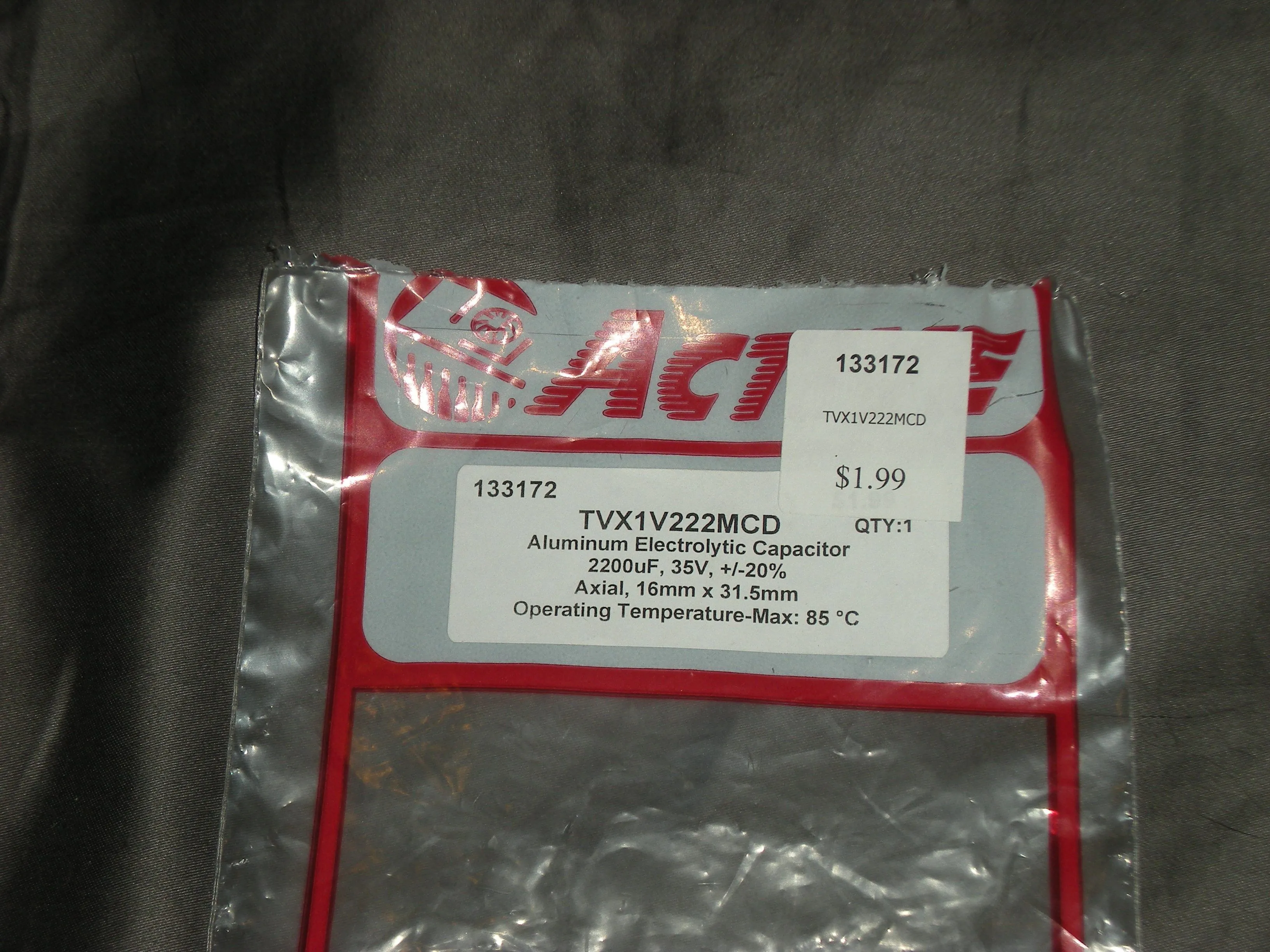

4) Buy an Electrolytic, Polarized Capacitor at Radio Shack or local electronics/stereo store 25V (or higher) and 2000uF (or higher). Mine was 35V and 2200uF $1.99!!
See Attached Picture
5) The capacitor has a marking down the side indicating which terminal is negative
6) Solder the negative lead to the relay lead you noted (in step 3) as negative and the positive lead to the relay lead you noted as positive
