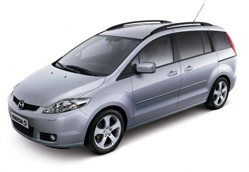

Very different mounting points, far apart:
These pictures look deceiving. I'm looking the mount points on the US model in relation to the door seams. Then look at the EU version above. Looks to me the actual mount point is either VERY close or the same. The EU rails just have the aero extension on the ends of the rails that make it look like they are mounted further out.
