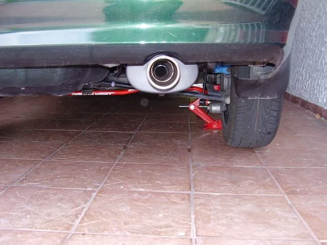

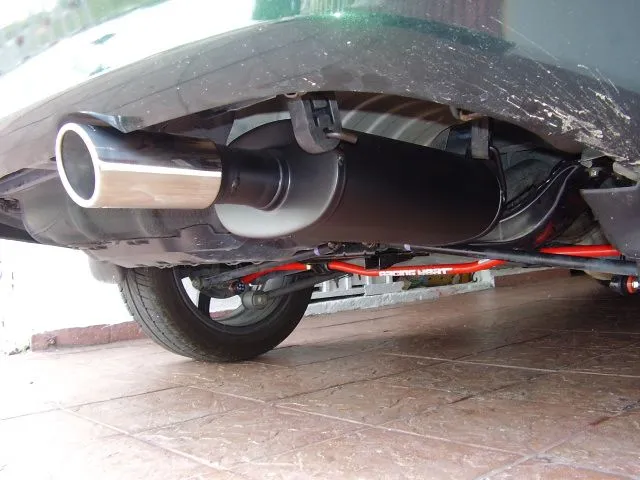

nice look really good what wheels are those? and how did you change the front sway bar out i thought you had to take the engine out?
oh ok cool and also why did you replace the rear subframe?
MSP subframe has stronger attachments for the MSP sway bar, and the stock protege subframe will not work with the MSP sway brackets. you need to either replace the subframe, buy the AWR adapters, and get a 'clunk fix kit.'
MSP subframe has stronger attachments for the MSP sway bar, and the stock protege subframe will not work with the MSP sway brackets. you need to either replace the subframe, buy the AWR adapters, OR get a 'clunk fix kit.'
Not quite sure about this but I do know people who have kept the same stock subframe with MSP brackets with the RB sway bar.

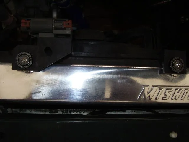

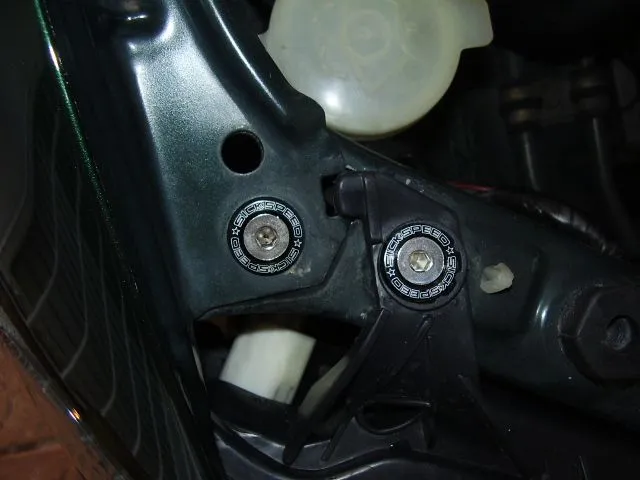

...are those sickspeed washers a universal fit? got them on ebay i suppose? thanks!
