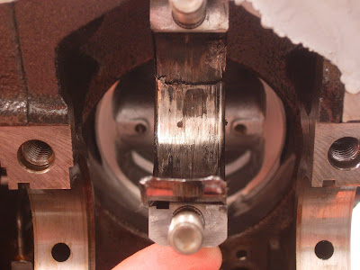

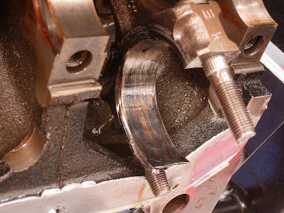

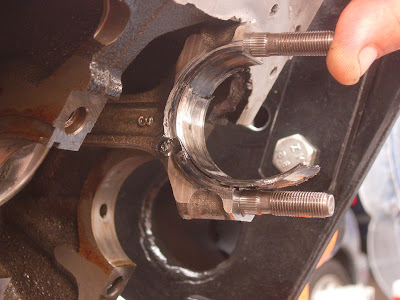

#4 rod bearing spun @ 224 miles on the new engine. The rod is wrecked and the head has to come off. The rod nuts didn't exhibit any lack of torque upon removal, so that wasn't the cause. Basically, a complete bottom end rebuild is in order.

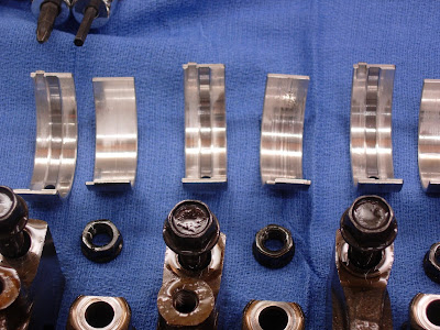

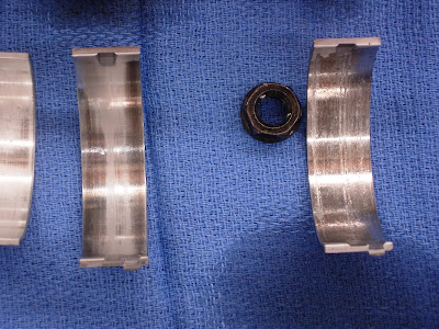

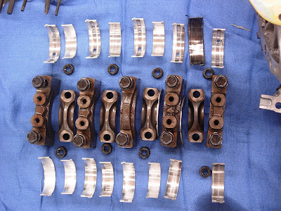

1-4, left to right:
#2 rod bearing was significantly scarred:
#4 and 5 mains weren't so good either:
The oil pump shows signs of scarring and has steel bits within (likely ingested after the fact):
