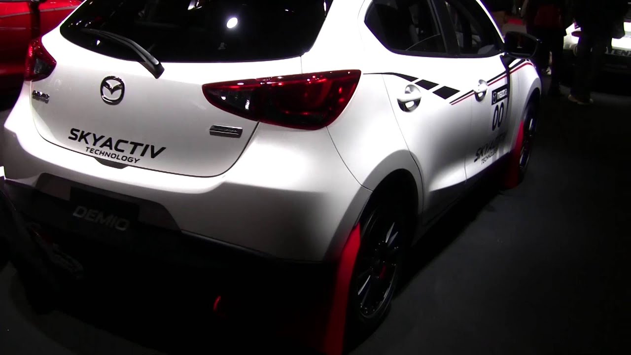

This might provide some inspiration...:)
First of all, welcome...Exciting build! 😁
Unfortunately I don't have a Mazda2 but if possible, I hope you continue with this project and keep us updated!
Regarding the AWD conversion, I wonder if going with a model that has AWD already will save you a lot of time (and potential headaches). Have you searched around yet for an AWD model in Australia?
