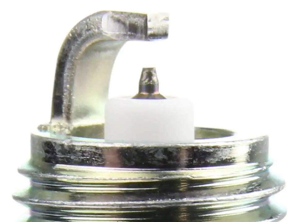

I know what you mean. The issue is how Mazda relies on the spark plugs. They need to have the iridium tip. The system actually uses the spark plug as a knock sensor. Check out post 2 at the link below:

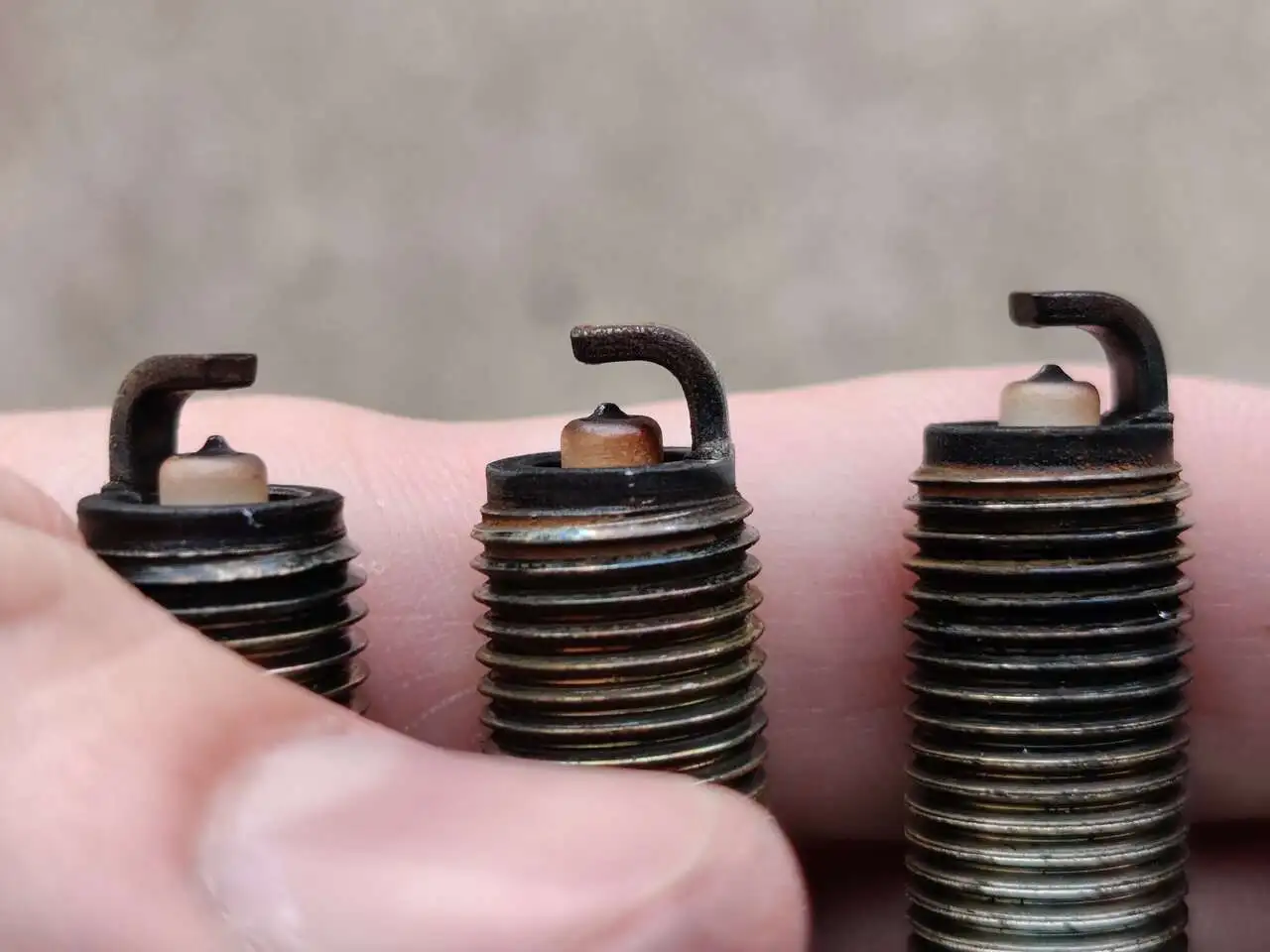

what a crap I had in my car :eek: ... i installed them 10k miles ago, the result is below.
haven't tested if this fixed my issue yet, but the plugs were horrible. Paid $150 for 4 new, old costed me like $22 for 4.

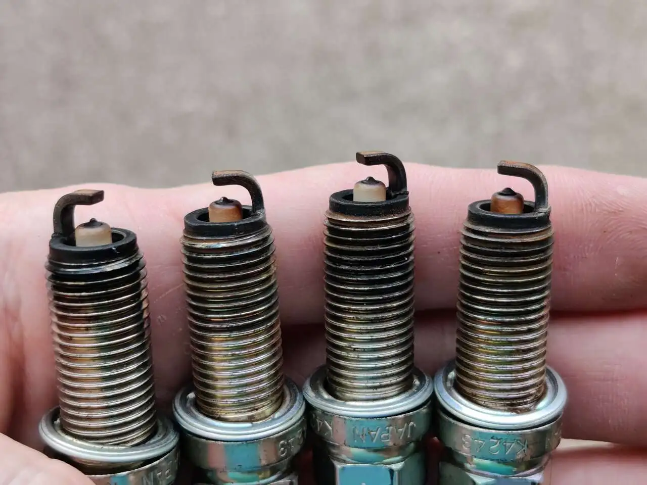

the new was like this:

I think you’re on the right track, can’t wait to hear the result of the new plugs!
Changing spark plugs resolved my issue !
Thank you so much for pointing out spark plugs, while initially I didn't believe this might be a reason, i thought "well, if these work as nocking sensors or if people are just picky about them - it's worth checking", it was the reason.

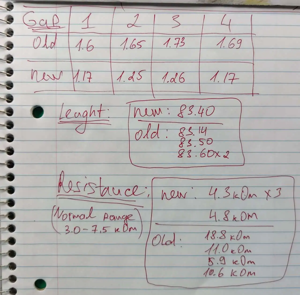

Glad you resolved your issue by simply replaced counterfeit plugs. As @ruthrj pointed out that $22 for 4 good quality plugs simply too good to be true! On the other hand, $150 for 4 Mazda OEM plugs is too high on price too (should be around $120). You could have got a set of Mazda OEM “Value” spark plugs for about $50; or you could have got the NGK equivalent plugs for about the same price like the Mazda “value” plugs. But nothing can compare the joy of a strange problem which got fixed by yourself with the help from @ruthrj!
Yes the 10K-mile old spark plugs definitely either the counterfeit or the “rebuild” plugs. IMO it looks like “rebuild” plugs as the tips are totally worn with only 10K miles. And the resistance of old plugs is all out of specs too. I wonder what the imprint says on brand and model number from your old plugs?
