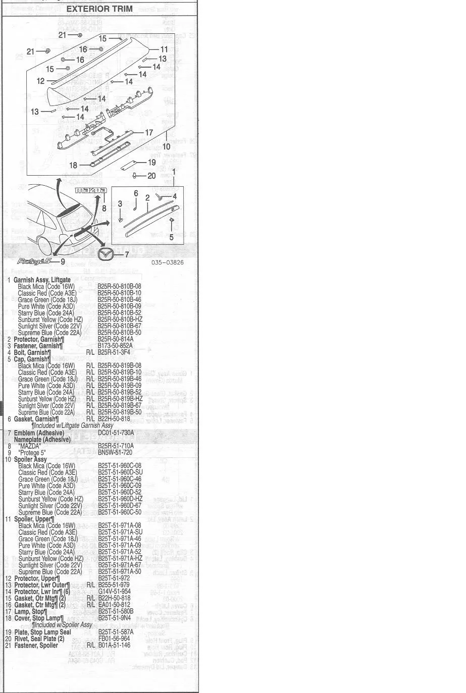

i got a couple of LED's that apparently have burned out in my high mount brake light, the one in the spoiler. Anyone had this problem before? I haven't taken it apart yet but I am wondering whether i have to get a whole new brake light or can I replace the LEDs?

Here you go Dima. Got the parts list for the entire rear center brake lights section. I think you need #17.

thanks bro. looks like the whole lamp assembly must be replaced. looks like its one unit, right?
