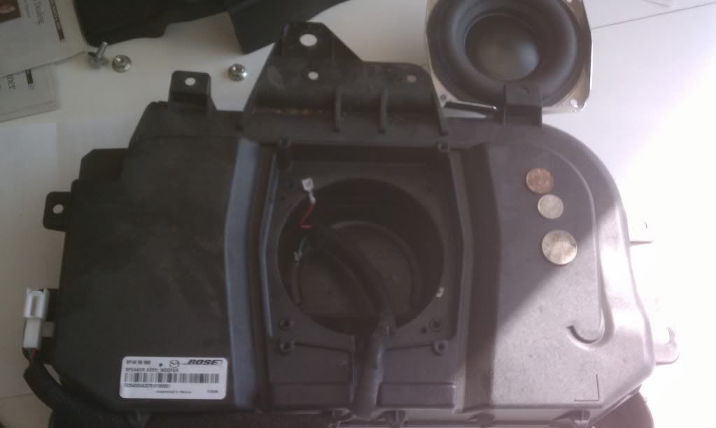

BOSE sub. Anyone try cuting a hole in the box w/success?
ohioan
Ms3, silver gt
So tiny...

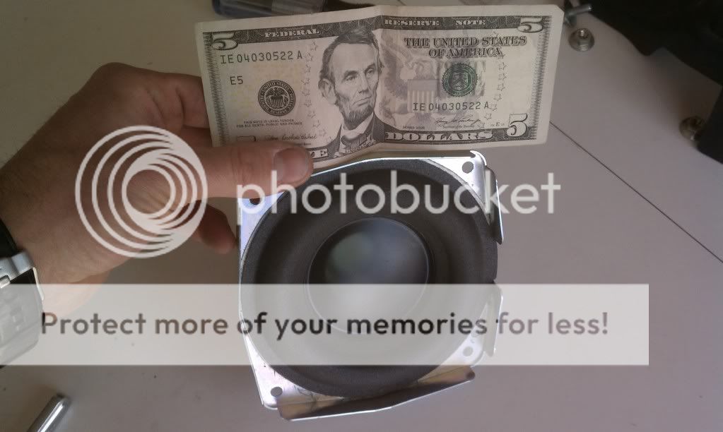

I took the sub out of the box and hooked it up to the house stereo and it sounds better w/o the box.
I also found .36 cents in the box. So I'm hoping when I hook it back up in the car, some rattle stops.
But my question is, has anyone tried to modify the BOSE box and had success? When it's in the box, seems to hold back some of the potential of the speaker.
You're already limited by the size as to how how in hz that sub will ever go. It just can't push what a 10 or 12 will be able to.

I'm going to shop around for a new amp. I plugged the sub back in and can barely hear it. I think the amp is just so low power it makes the sub weak. I took the amp apart to see if you can adjust it in anyway, that's a big no.

You can't get any real bass out of a 5" speaker... adding an amp to that is just going to result in either you running a high-pass to your "sub" at 75Hz or higher (???) or getting a LOT of farting noise whenever you hit a bass note.
