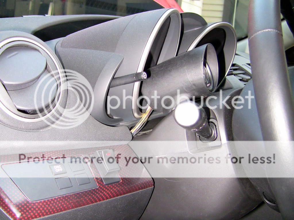

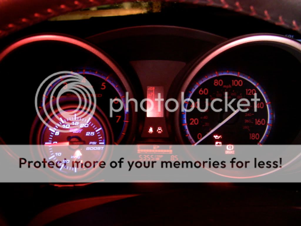

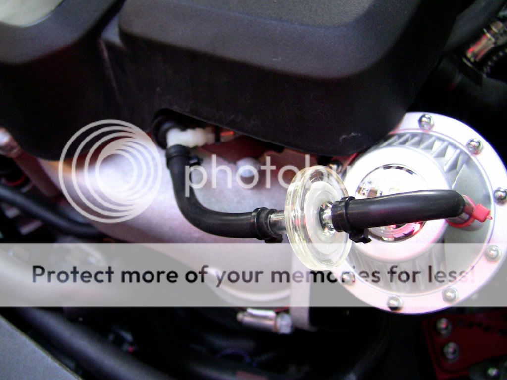

i just installed my boost guage last night. it took longer than anticipated because i had never done anything like that before but it turned out good.

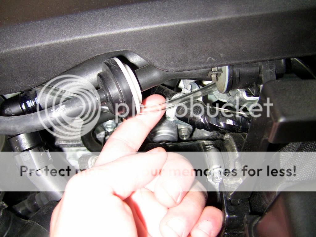

T for boost guage hose
running underneath TMIC cover

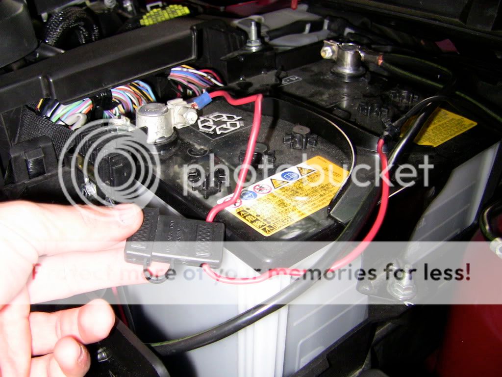

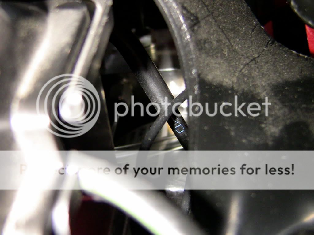

Running around behind the battery

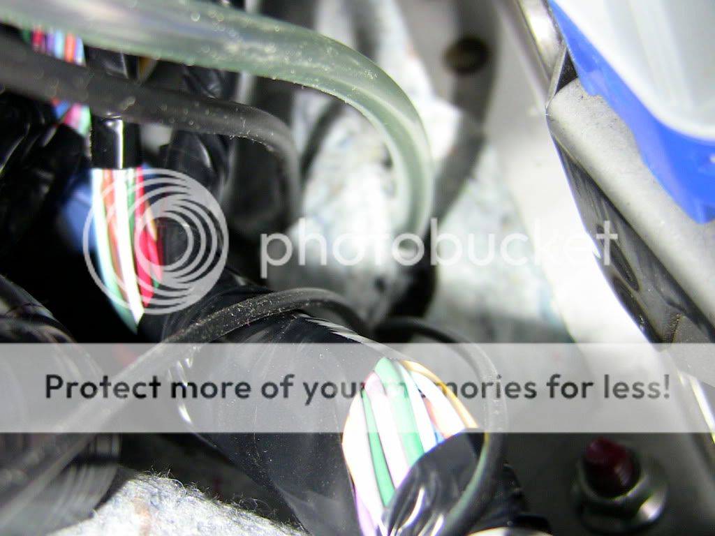

running through the hood latch hole in the firewall
on/off switch for the backlight and the custom gauge pod
fuse for power comming right from the battery
Looks really good where did u get the gauge?
It's a glowshift guage. My friend has one and he hadn't had any issues so i figured i would try it. glowshift.com
Looks nice but I don't know if I would run the power right from the battery.
yeah i've heard mazda has even pulled s*** about not honoring warantee stuff with gauges, so i figured if leave the wiring alone and i have any electrical issues i will be all set. it has it's own fuse so the fuse will blow if anything goes wrong and power will be cut.
I hooked up mine a couple days ago but instead of using power directly from the battery, I chose to tap into a wire that would give me steady 12v while the key is turned... As soon as you take the key out, the light goes off. If anyone has any question regarding the boost gauge pm me.
where did you T off? it looks like it right off the BOV line?
PS what gauge is that?
EDIT: ill read next time Glowshift
You tee it off on the vac line that attaches to the top of the DV.
Make sure you use some zip ties to hold the lines onto the T
Ya i know you need to T to a vac line. i just wouldnt have chosen that one. I have install a few boost gauges in my day and usally we leave the BOV and WG on their own lines. dont want to mess them up by zapping away some of the suction. In theory it should all work the same. Ideal location is to have a vac block. if you dont, then some where up closer to the IM is better IMO
either way it looks good, and if your not having any problems with the BOV/BPV then its all good.
that is where i saw everyone else tapping into, and thats actually the only place ive seen anyone tap into. mine is working good and so are the other peoples i know who have their guage running from that line (wrx platform)
