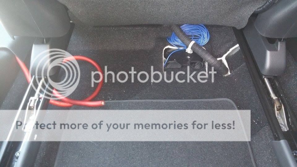

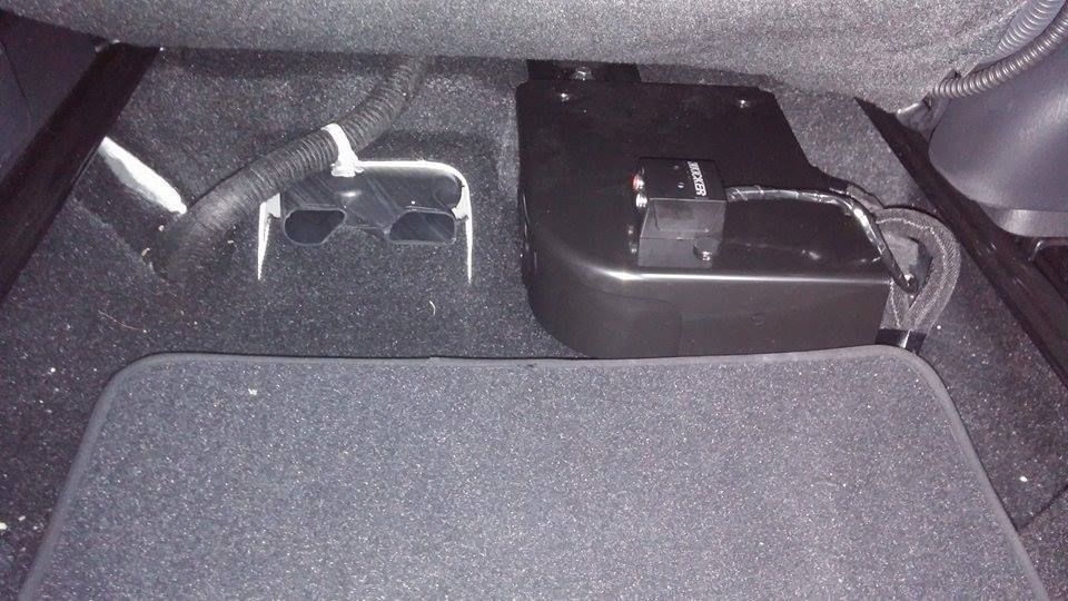

how did you get under the center console ? did you remove one seat both seats or what ? i need to run my rca from passenger seat to driver seat .
passanger side with factory amp
driver side where i want to put amp
