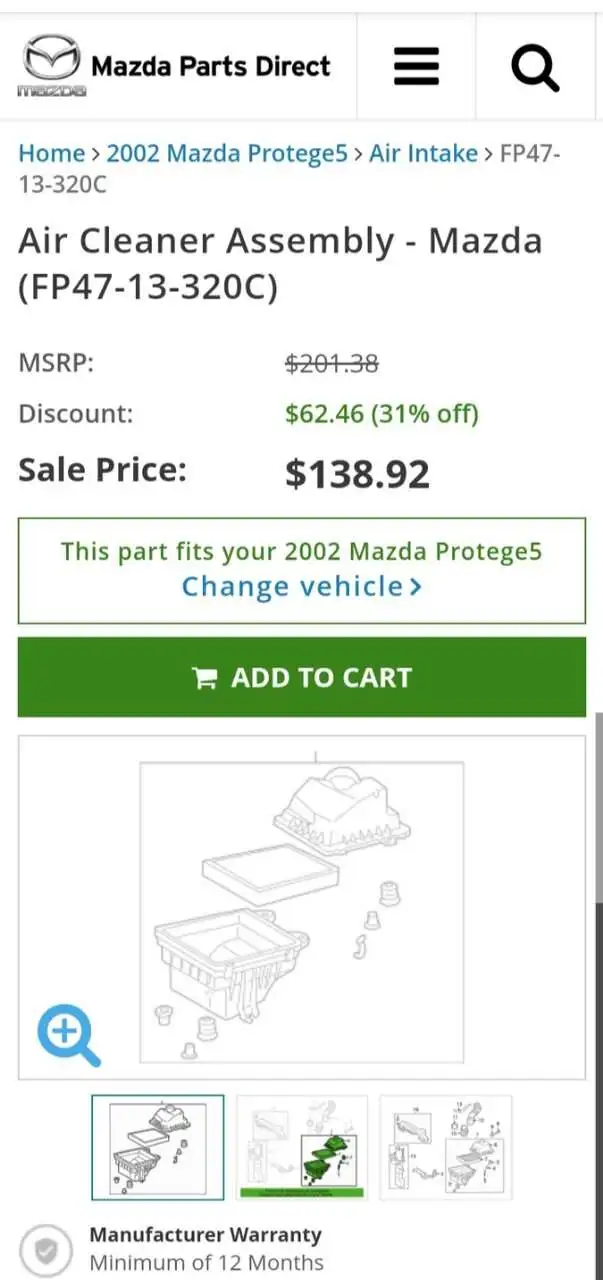

As part of the air hose replacement I had been searching for an air cleaner box as mine is very brittle. I'm not having much luck (even at PAP), but found a blow up of the parts and noticed the insulators and spacers. Mine are gone. I'm the original owner, so my mechanic must have "forgotten" to reinstall them. Disappointing, to say the least. It's all becoming crystal clear. Air filter gasket was the correct size after all. Anyone here installed an air intake kit? I've got 270k miles and would like to see if I can make it to 300k.

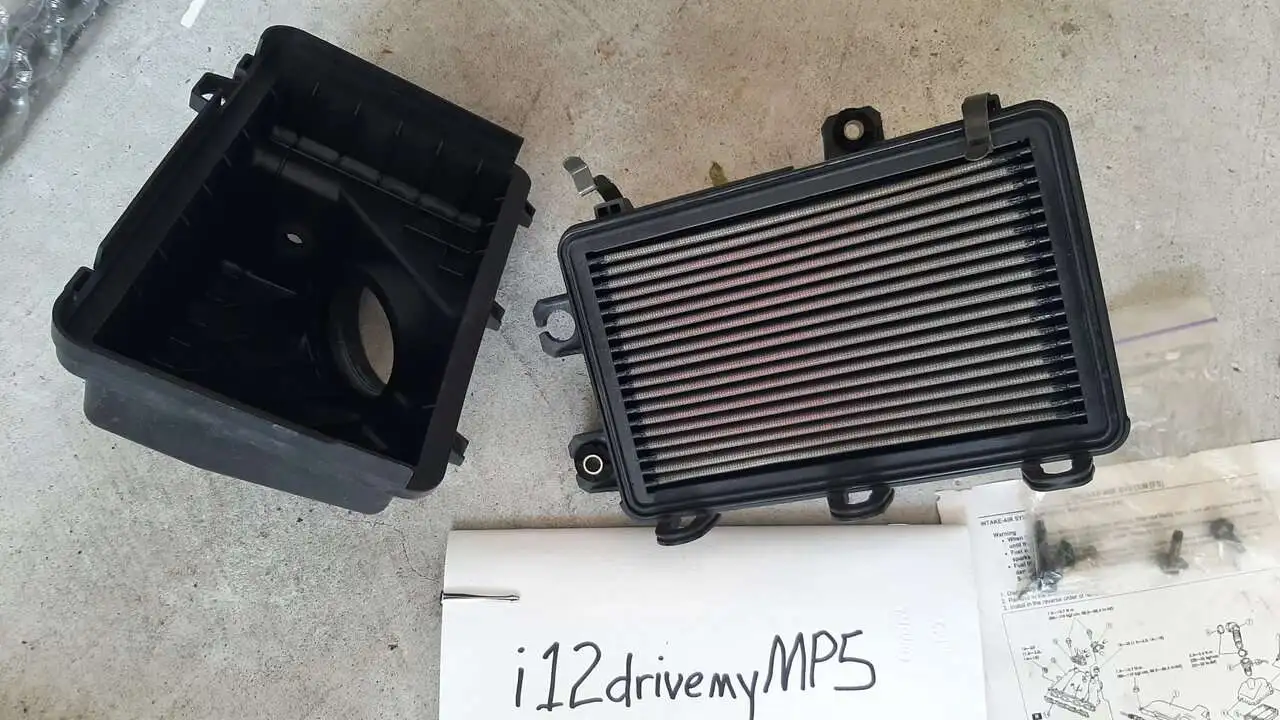

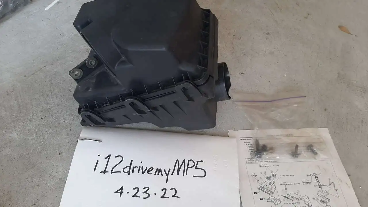

what part of country you in? I know my oem intake will never see my car again and is just laying in a box in the attic. Probably has a washable drop-in filter in it as well. Most likely have TB to radiator support- snorkeling, accordion, box, filter and mounting hardware. Can bring it down into the light and snap pics if interested..............

I'm in East Tennessee. I ordered one from the link above but I'll be surprised if they actually have it. They charged my card but I haven't heard anything since the email notifying me that they received the order. It took the other company a week to tell me that the part wasn't in stock. If it isn't too much trouble I would appreciated pics.

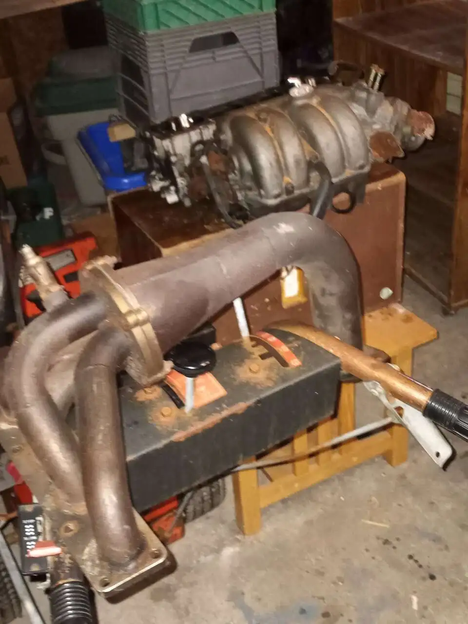

A Wagner Shorty Exhaust with a burnt pre-cat and a big ole dent. lol
There is so much stuff that it would be all week adventure between the parts rack in garage and all the overflow in the attic. Overwhelming just thinking of the chore it'd be. Saw a brand new radiator for automatic in it's unopened box I forgot I even had while fetching the intake stuff......that and 3 grills - oem with silver strip up top, oem plain and a fiberglass one that looks like mazda 3 grill, lol . It all must go.

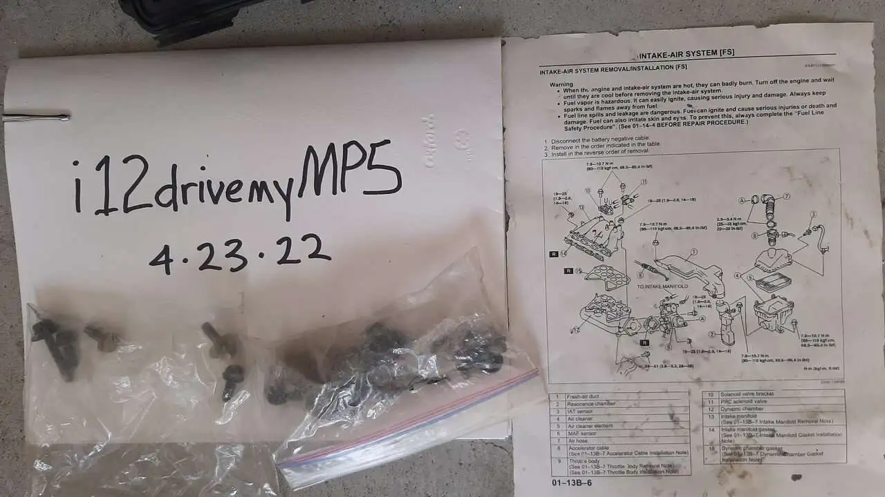

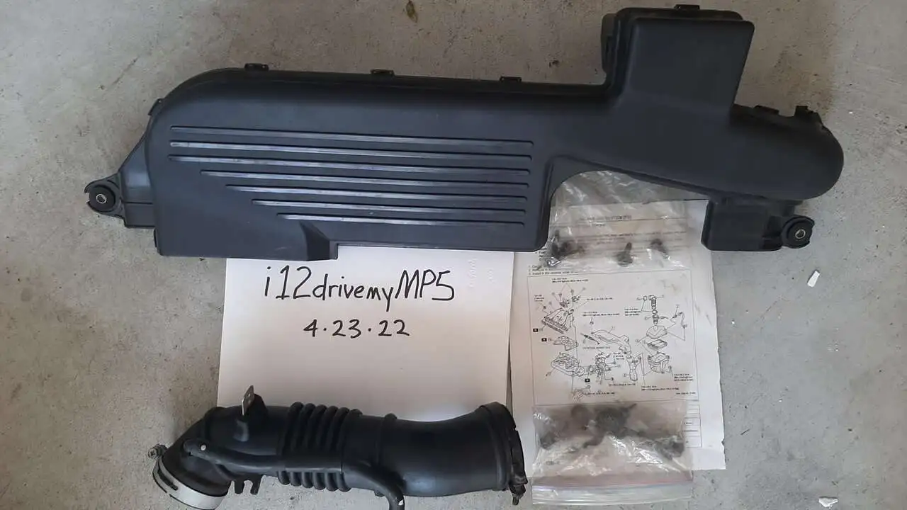

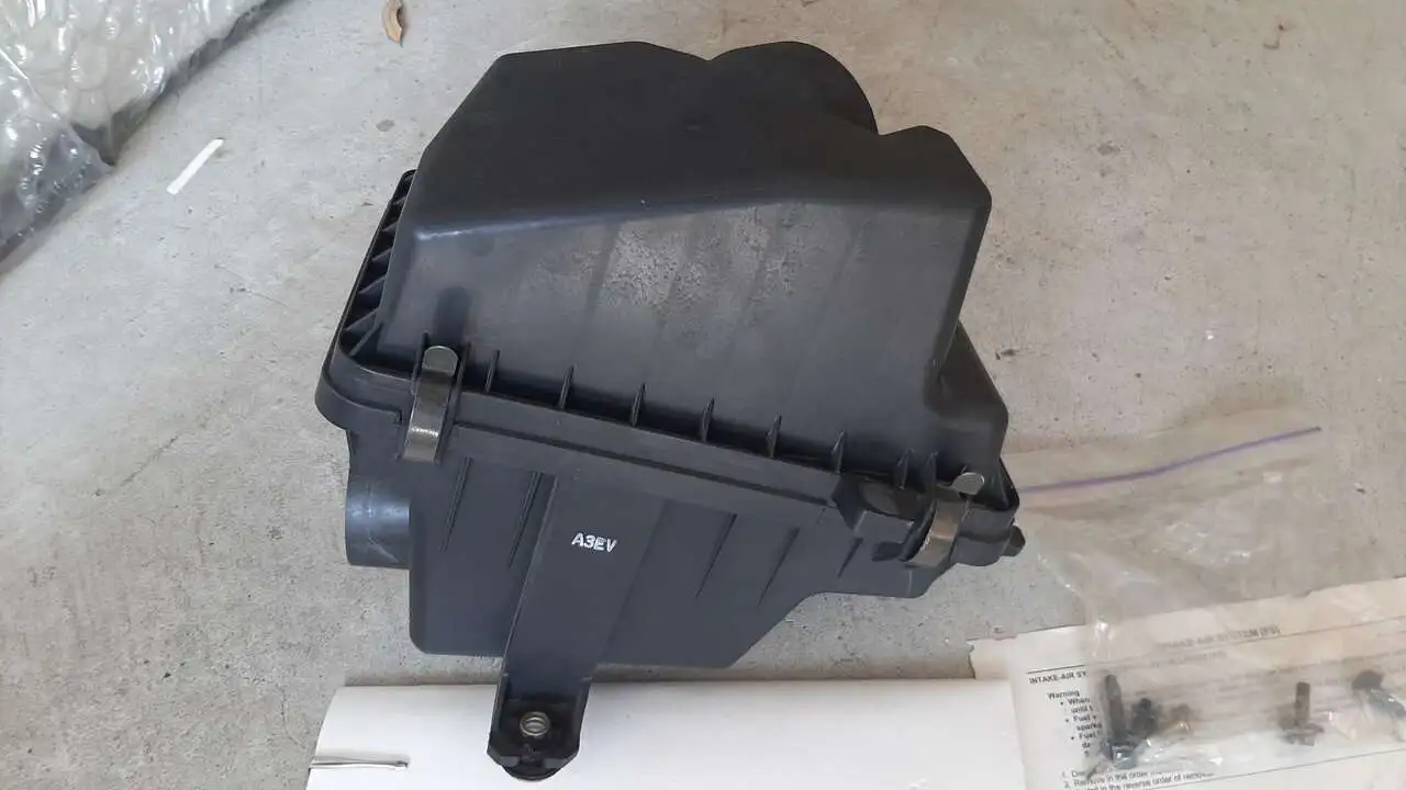

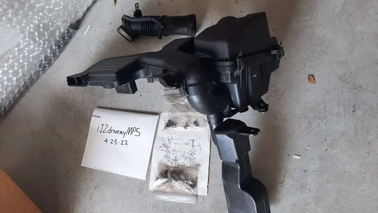

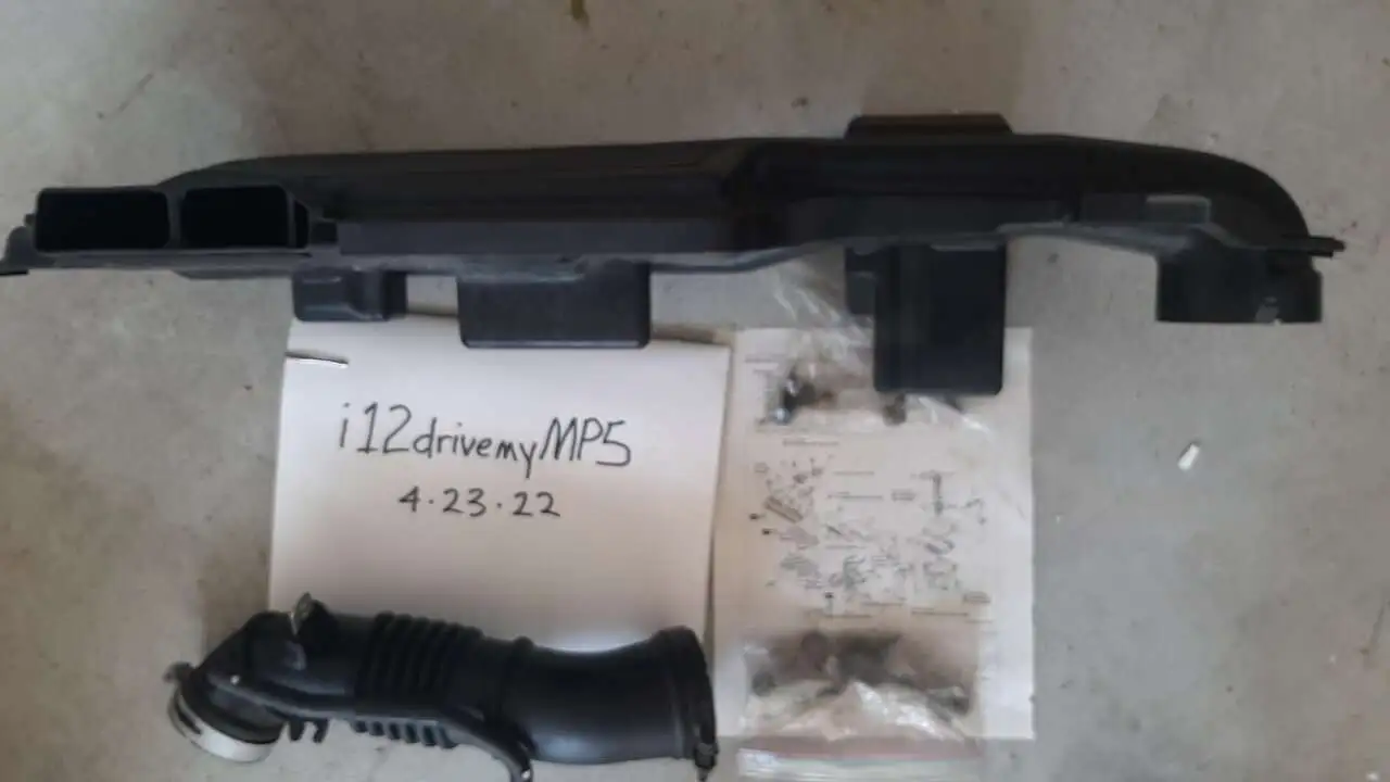

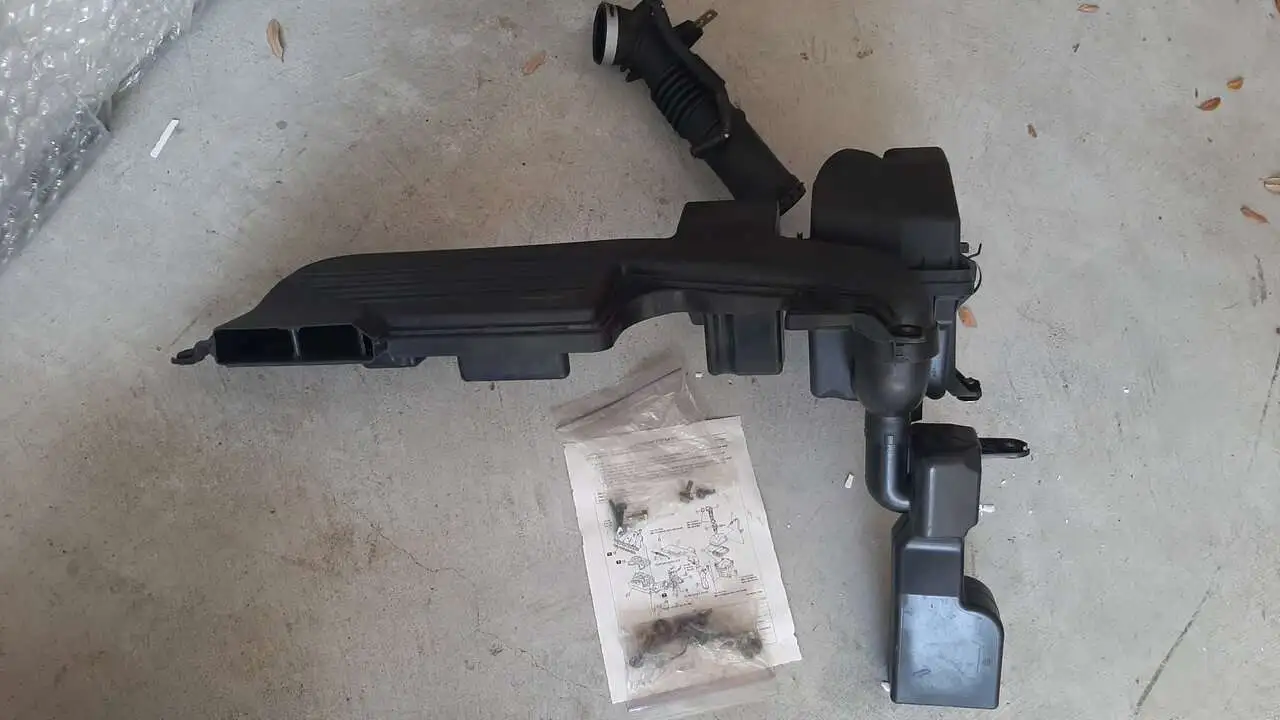

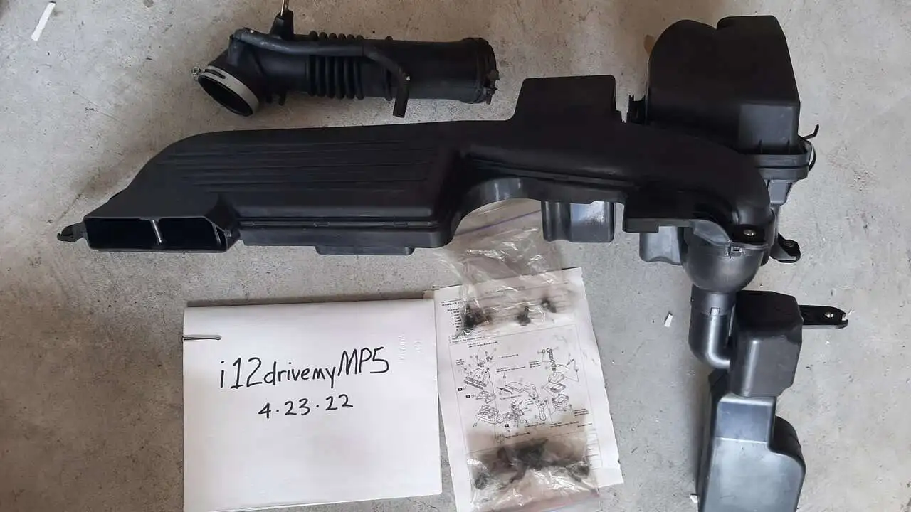

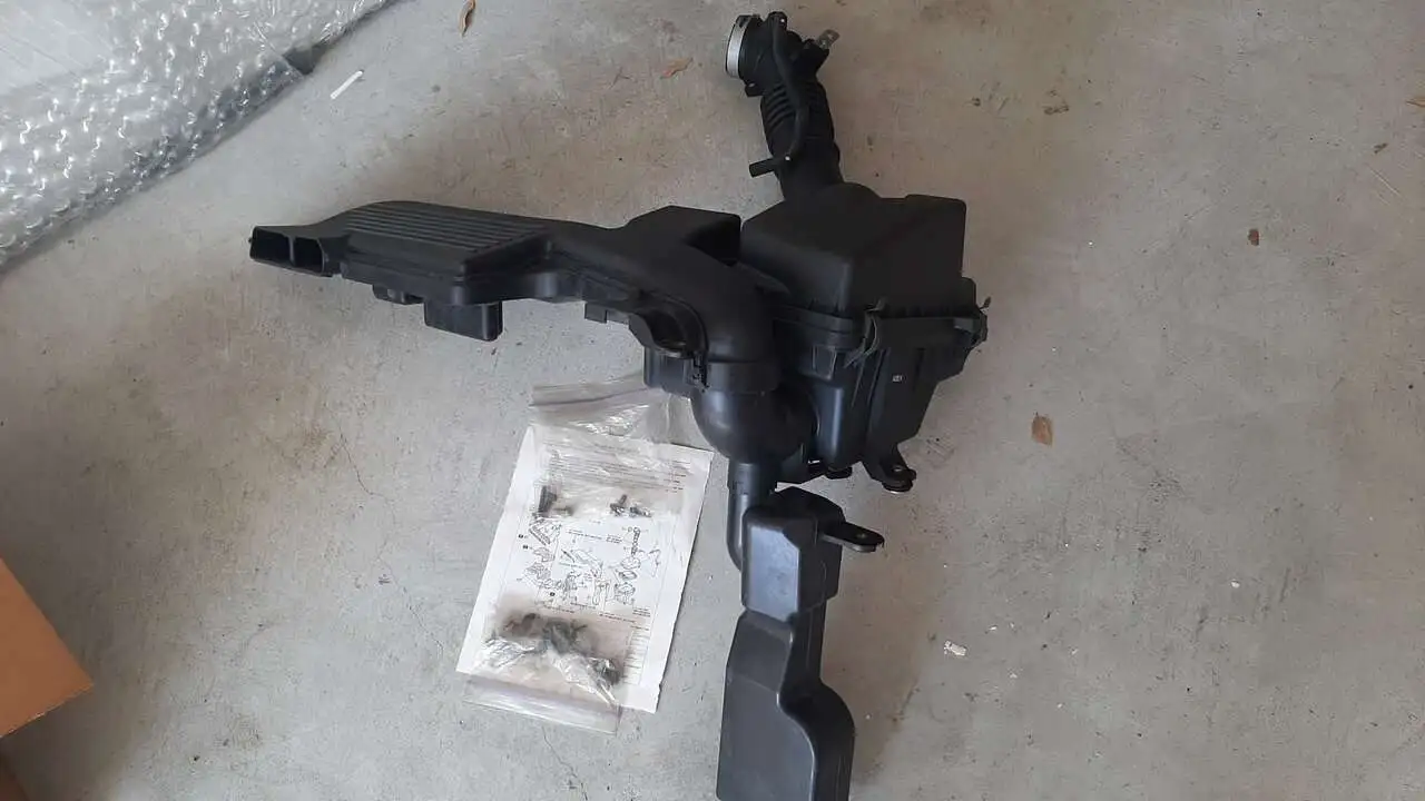

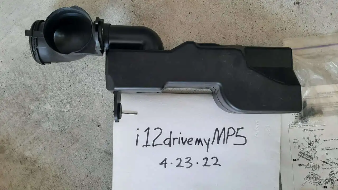

Here's intake pics...all the plastic, all the clamps, all the insulators/spacers, all the hardware & a K&N drop-in filter and even the installation/removal instructions.....everything except the MAF
