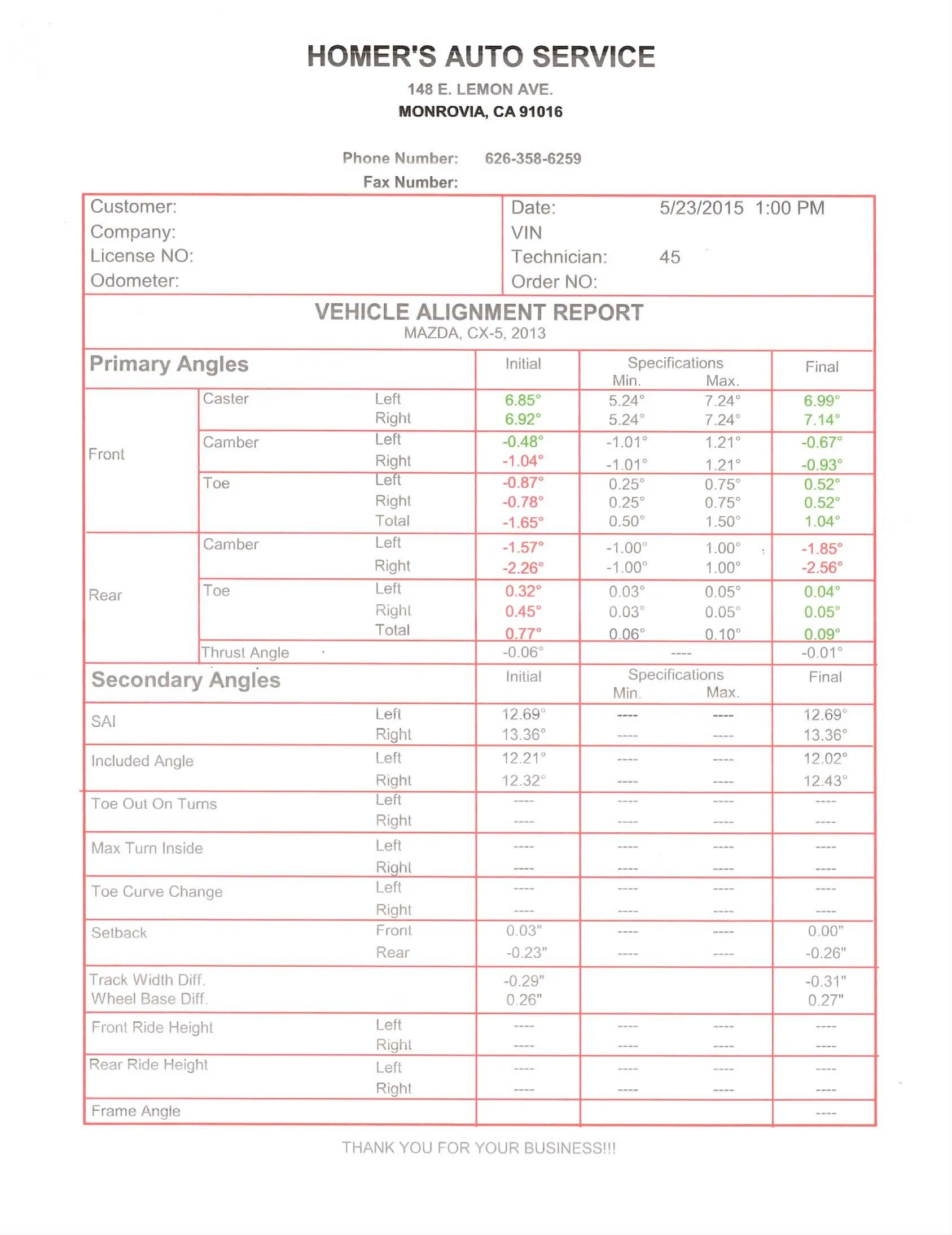

Actually, the camber angles were better before(1.53) then after. Right now, with the toe bolts all the way to the center of the car, I have 1.85 degrees. This is still to high imho.

When I get home, I will scan the readings.
From the arm you made? I got a mis-matched passenger strut from the body shop (.5 in higher than my driver side). Apparently there are like 4 series of struts and since mine was a jdm original part, most likely I won't be bale to order it without some digging online. The "superseded" part number is of different origin. I bought some stuff from Harbour Freight yesterday and I'm just going to install the coils.
