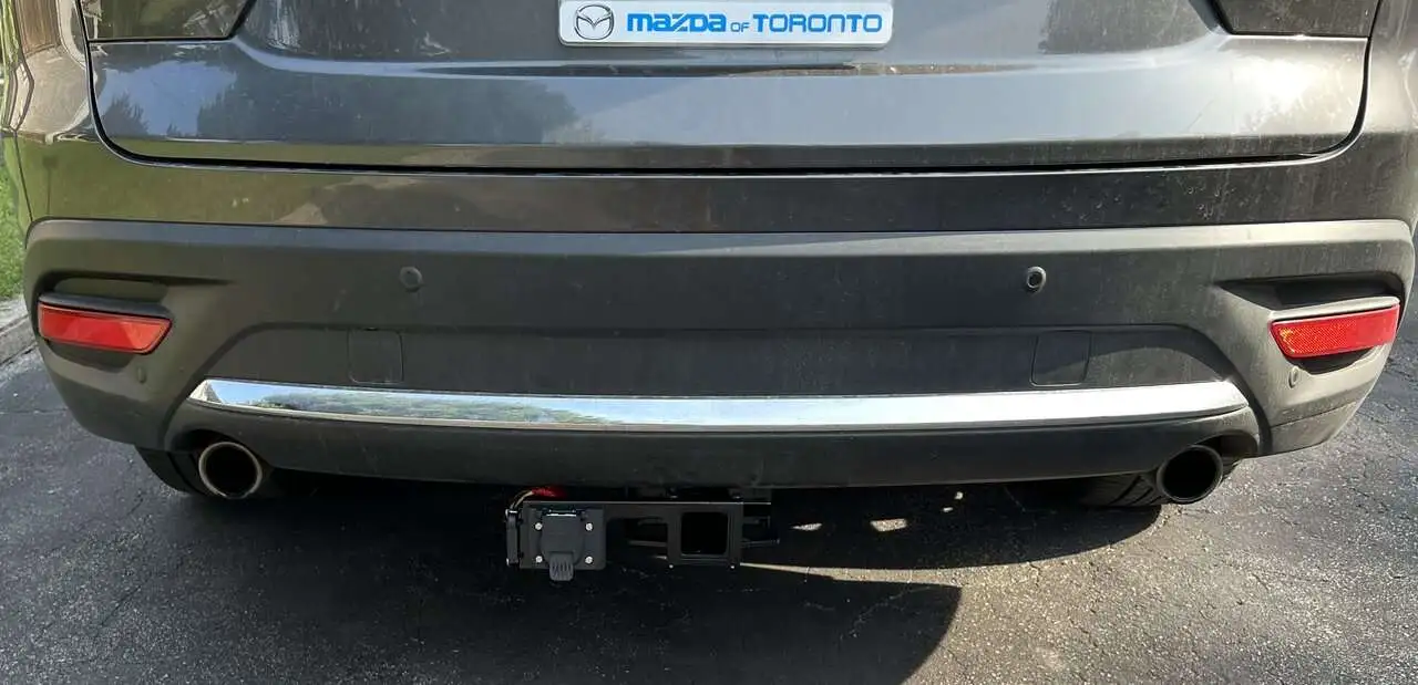

Finally got around to doing the hitch and wiring.
Main Parts:
Class 3 Trailer Hitch, 2" Receiver Curt #13284 ($357.29 taxes in)
Custom 4-Flat Curt #56338 ($76.84 taxes in)
Dual-Output Electrical Adapter Curt #57672 ($45.14 taxes in)
Easy-Mount Wiring Bracket Curt #58000 ($27.59 taxes in)
I'm not listing any of the other parts that are needed for this work (i.e. wires, in-line fuse, tape, connectors, loom, etc, which was another $100 taxes in)
That's a grand total of ~$610 CAD in parts needed; obviously not including costs for tools. A friend of mine had a hitch and 7-way installed on his minivan for ~$1200 CAD so I guess I saved about 50% in labor, but had to put in 6 of my own.
The installation of the 4-flat, dual-output adapter, as well as the hitch itself is pretty well documented (between etrailer and uhaul so no need to go into this). I drove the rear up on some ramps to give myself a little bit more room with the hitch install. The exhaust hangers are a bit of a pain without the removal tool, but I did manage to get them off with a small straight head, a pry bar and some soap water. The install of all parts (including running the pos(+) and brake wires to the engine bay) took 6 to 6.5 hours in total. The 4-flat wire I put through a grommet right in the center of the trunk, right beneath the spare tire. Ran the (+) and brake wires together in a wire loom essentially following the driver's side rear brake line. Not planning on using a wired brake controller, but ran the wire up to the engine bay anyway since I was running the (+) wire anyway. Used a 10 AWG as that is the size of the wires already present on the dual-output harness and put in a 30A in-line fuse at the (+) terminal on the battery. Did not wire in the back-up light as I don't plan on pulling anything with reverse lights.

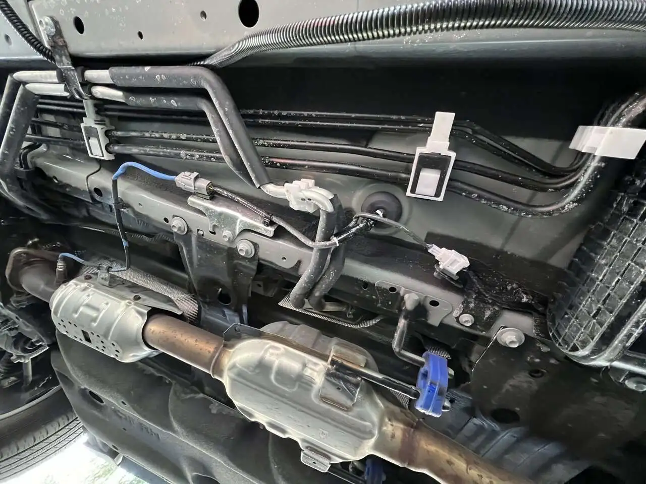

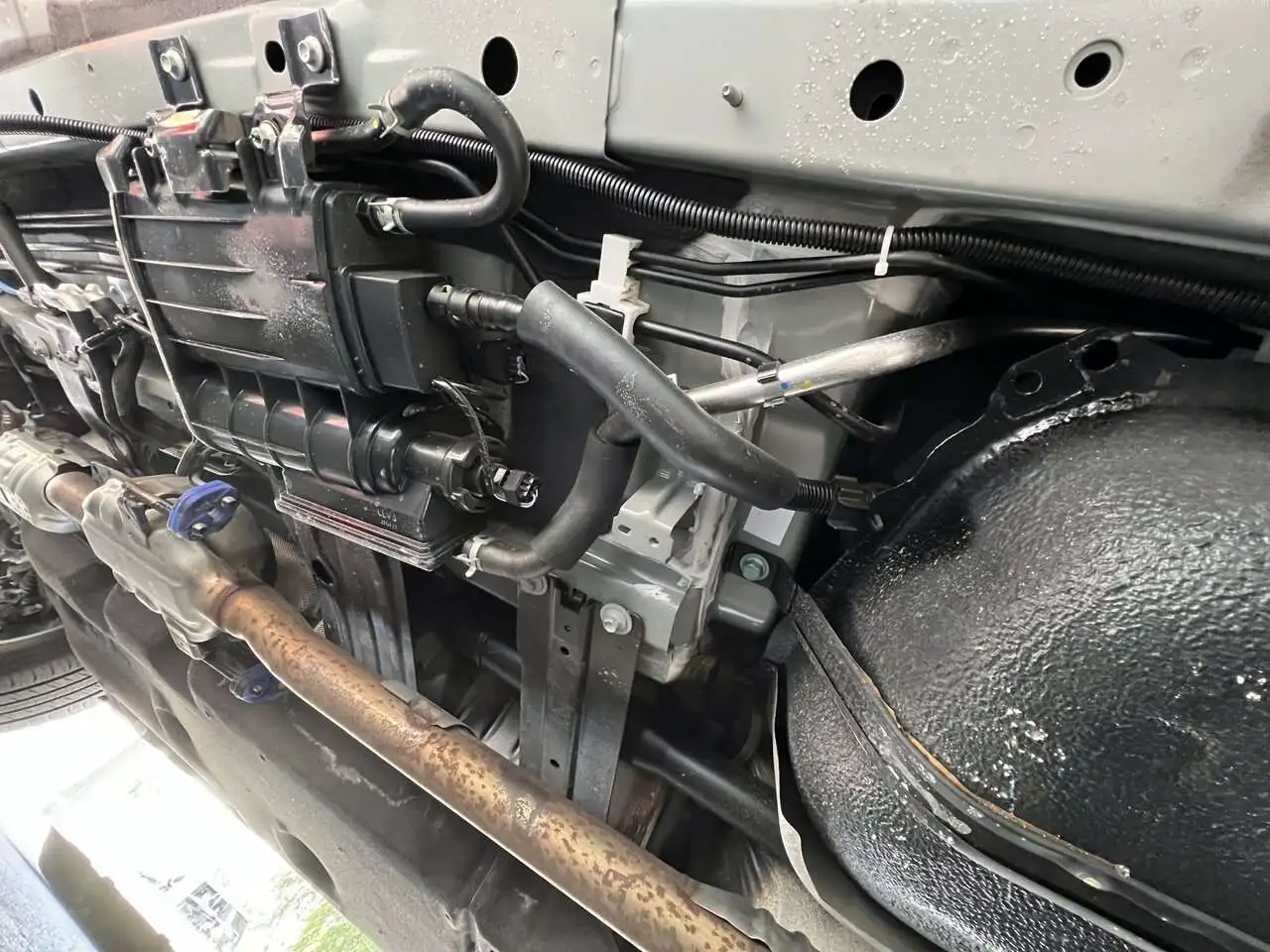

I really just wanted to post a couple of pictures (not the best as I was under the car without lifting it off the ground) of the driver's underside with the panels/covers removed for future reference for anyone that wants to get under there or is curious to see what is there (at least on the driver's side). The underbody panel consists of two pieces held in by lots and lots of bolts and a few plastic clips. I couldn't get a good enough pic to show where the bolts/clips are located. With the car not lifted, I was basically eating my cell phone camera.
Driver's side (just front of rear wheel to the right of pic) toward the front, left of pic.
Driver's side. Front of car to the left, rear to the right.
The underbody of this car is surprisingly well protected. The Car Care Nut guy wasn't kidding when he said it was some heavy duty protector/sound deadening material.
Let me know if you have any specific questions.
