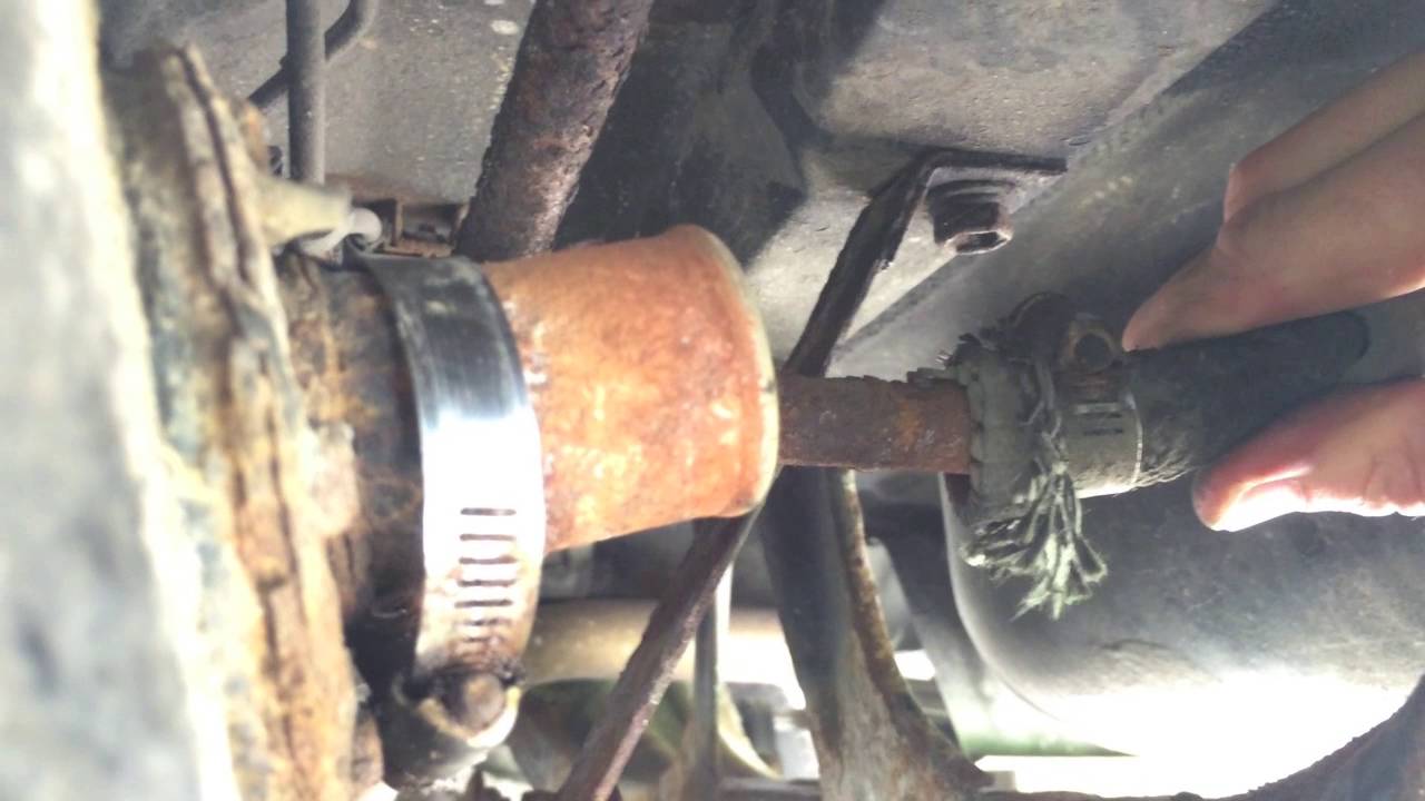

I checked this Mazda parts site and perhaps the diagrams could help..?
This video also came up that might shed some light on the repair although it's not a Mazda...
