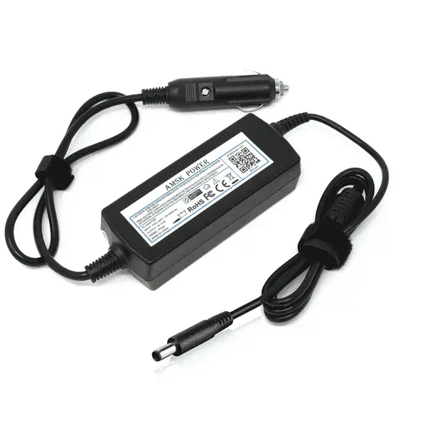

They make lighter socket laptop adapters. That way you don't need to use an inverter. Go that route.
This makes much more sense than an inverter. I don’t see why it would be mandatory to use an inverter instead of a charger like this. I’m not surprised that it blows a 15A fuse with the inefficiency here. 12V DC to 110V AC, then back to ~12V (depends on the computer) DC.
