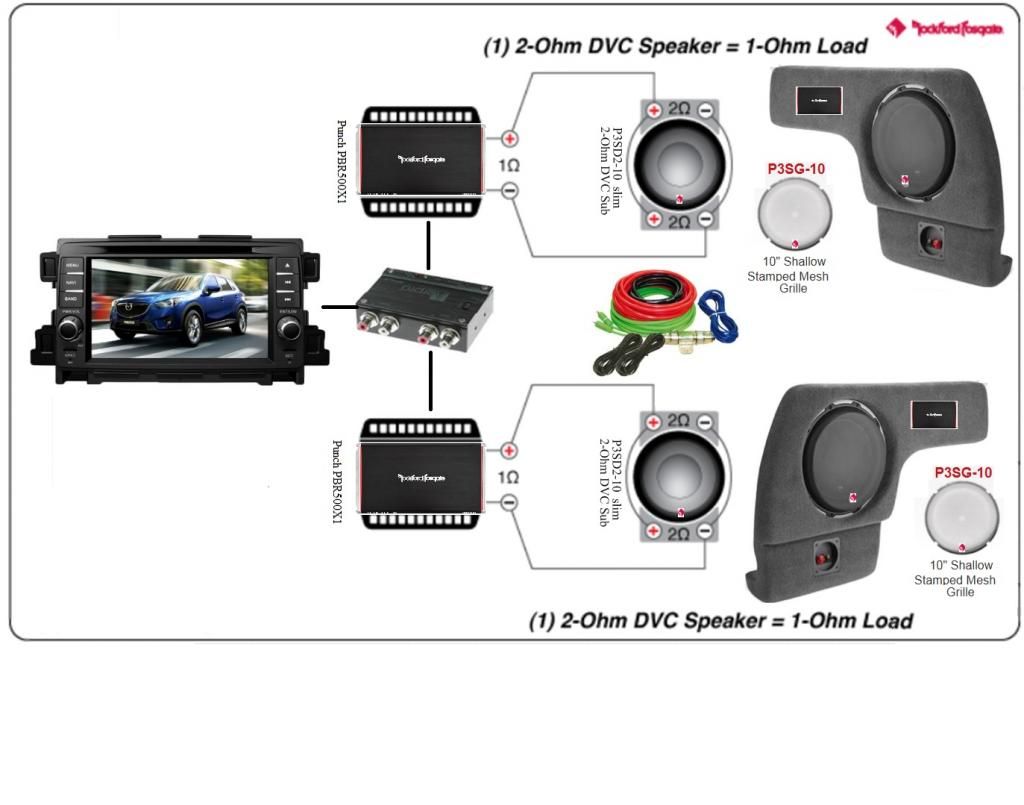

Hmm, I want to use the cavity areas in each side of the trunk to install some flush mounted shallow 10" subs ( one on each side ) , then if possible install the amplifiers in the hollow part of the rear trims on each side so essentially the whole panel is flush , this way it will soft of look OEM and everything will be self contained and i wont loose any trunk space and i still get to retain the spare wheel / tools etc
Subs will fit fine and but finding an AMP that will fit op top in the section over the wheel arch is problematic, most amps are not that small, the Rockford fosgate PBR.300.1 and PBR.50.1 will fit but im worried they are just so small and running them at 1 ohm could be quite hard and get real hot, RF also do a shallow sub so i'm quite keen at having one brand,
Something like this
I also see that the MTX thunder500.1 and the MTX Thunder 1000.1 amps will probably fit in the recess above the wheel arch , these are 6.3" or 160mm high so would be a tight squeeze but possible, MTX also do their shallow sub too so my single brand thing would be ticked off the list, I wonder how the Rockford fosgate compares to MTX as far as quality and output / performance.
Rockford Punch PBR.300 or 500 are 4.25" or 108mm high so easily fit anywhere
MTX 6.3" or 160mm could just fit without sticking out too much at all
If you have some experience with either id like to hear your thoughts

I ended up ordering all the bits for the sub install.
I wanted one brand and something that fits without me chopping up stuff in the car, lets me retain spare wheel and not loose trunk space , this lead me to choose the Rockford Fosgate stuff
I will have 2 x 10 " P3S102 Subs each powered by a PBR500x1 amp, these will hopefully fitted flush into a custom fi-glass enclosure that will use the cavity space above and behind the rear wheel arch following the interior trim panel , Should be a fun little experiment.
Some bits arrived, I mucked around for some test fitting, wow it going to be a tight squeeze but a fun challenge.
